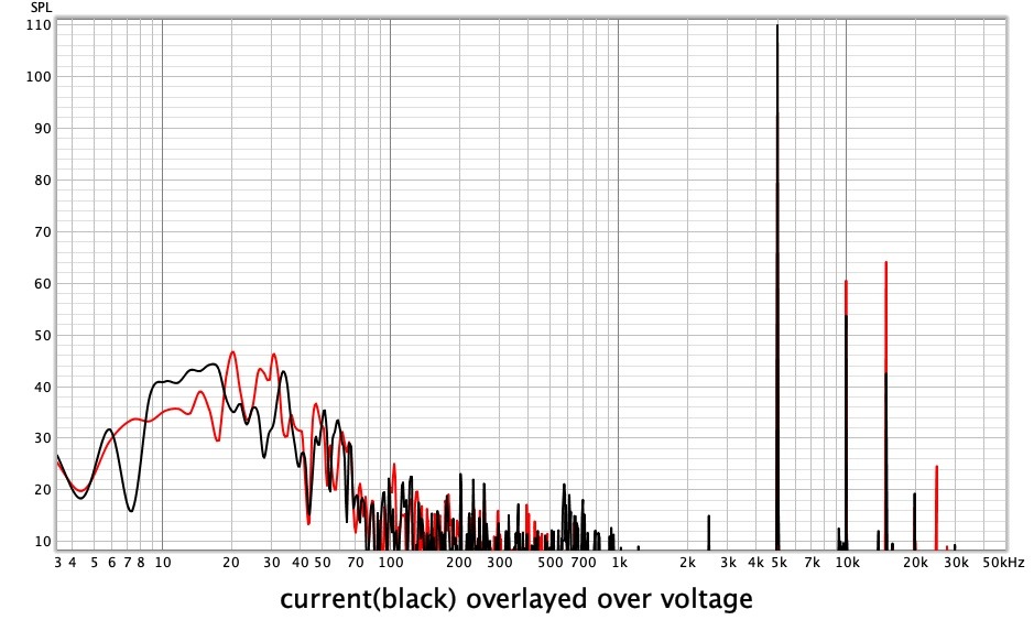

don't get the technical idea of this long post. is it possible in two sentences to say what to what is related? yes current drive mostly reduces 3rd harmonic and above usually. But how it relates to breakups i don't get. Red is driver output with voltage drive, black with current drive.I have always been a proponent and a user of DSP for my loudspeaker projects. Who needs those silly passive components, I thought. Along comes a tech paper by Purifi that recently caught my attention:
https://purifi-audio.com/wp-content/uploads/2022/03/220211_R05-Notchfilter.pdf
In the scenario presented, the driver (the PTT8.0X) has some 10dB tall breakup peaks in its response. The distortion of the driver has "echoes" of these peaks at lower frequencies that are N times lower where N is the order of distortion. This predominantly occurs with 3rd order distortion products, so at a frequency 3 times lower than the breakup peak, which puts the distortion peak within the passband. Bad!
I was able to chat with Lars Risbo of Purifi about the tech note until I finally wrapped my brain around the claims therein. According to Lars, distortion (broadly in the mid passband and above) is caused by modulation of the voice coil inductance due to various mechanisms. The inductance modulation within a magnetic field causes a new "distortion voltage" to be generated. This is generating various order of distortion all across the passband. This is also mentioned in this article in the section "Indefinite EMF generation due to mechanical non-idealities":
https://www.edn.com/loudspeaker-ope...y-of-current-drive-over-voltage-drive-part-2/
Also a factor is the breakup peak of the driver, which is sort of like a small frequency region of enhanced driver efficiency where more output is produced by the drive current compared to the rest of the passband. So, what is happening is that the "distortion voltage" finds a closed loop path over which it causes current flow, and this path includes the driver itself. When the distortion product falls on the breakup peak frequency, the distortion peaks just like the profile of the breakup peak following the increase in efficiency there. The way to prevent this is to reduce or block the current flow induced by the distortion voltage. In the Purifi tech note, this is accomplished via a passive (notch) network placed in series with the driver and immediately next to it without any other network in between. The series network notches out the breakup peak via a peak in impedance put in series with the driver. It is this series impedance at the breakup peak frequency that is "in the way" of the distortion voltage induced current, and so very little can flow. As a result the peak in 3rd order distortion occurring at 1/3 the frequency of the breakup peak is also reduced.
This was all new to me, and I now see some benefits from using series impedance shaping networks and filters as a way to reduce 3rd order distortion within the passband. Very interesting.
Thereis a way to do this without any passive elements, and that is to use an amplifier with high output impedance, which is what current drive produces. So I thought I would post about it here after reading Joe's post above that touches on the subject. It is something that I really did not appreciate previously. Unfortunately I believe that current drive is not possible unless the loudspeaker return is at ground potential, making amplifiers operating in bridge mode (such as many class-D amplifiers) unable to implement current drive.

So the distortion in the current was measured:
https://www.diyaudio.com/community/threads/drive-current-distortion-measurement.402566/#post-7434990

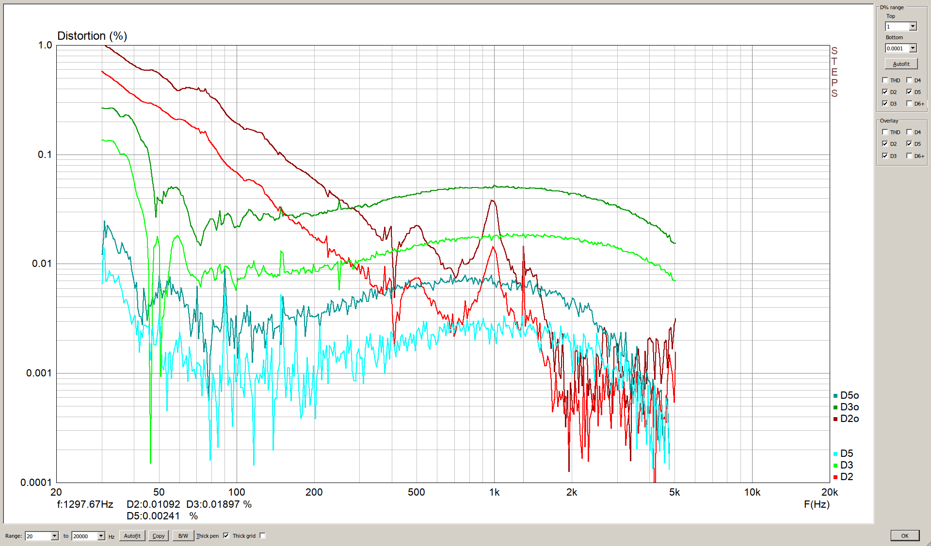

Do you have evidence of such a harmonic relation?Breakup produces vibrations in partial areas of the cone which produce frequencies that are not in the original signal.
AllenB: A breakup peak amplifies distortion from the motor as we have discussed in several threads. see https://purifi-audio.com/blog/app-notes-2/low-distortion-filter-for-ptt6-5x04-naa-11
Speakers are primarily linear but produce distortion nevertheless. Same goes for the speaker at breakup. Distortion is typical increased here because there is more displacement. Most paper cone drivers are used past their first breakup. But yes, best to avoid pumping energy into the driver here.
