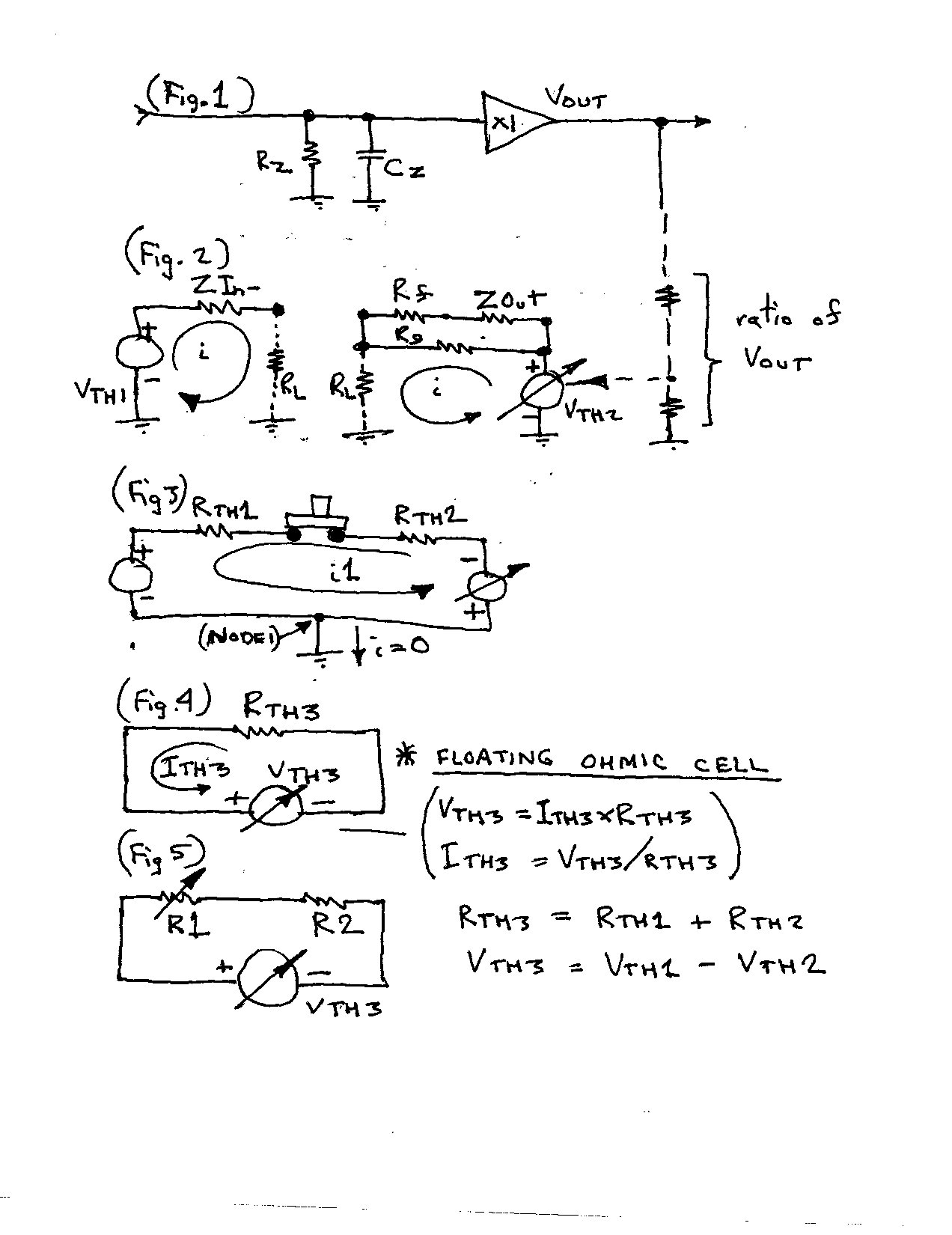

Following your post #2294 below to my post #2280
It seems that the use of the term "Current Mode Amplifier” isn’t rational to differentiate devices either Chris. The following perspective leads us back to comparing Zin- to Zout as seemingly the only way to justify a device being described as a v.f. or c.f. amplifier.
According to Thevenin's Theorem VThevenin1 (VTh1) and VThevenin2 (VTh2) can be considered connected to open circuit resistances of RTh1 and RTh2 respectively. Figure 2 shows these resistances as normally connected to some form of RL(load) as thereupon to complete the current path back to VThev(-). In the case of a CFA it can be considered to contain two Thevenin networks being connected with resistances in series. This results in a current (i1) passing in a loop from VTh1(-) to VTh2(+) (note that VTh2 is reversed as necessary for each VTh(x) to alternatively source and sink current). Figure 3 shows the absence of current flowing into ground, hence any voltage can be applied between node 1 to ground as having no consequence to the network.
Figure 4 shows a floating Thevenin translation from Figure 3, representing the foundation whereupon arguments can be made as to justify a CFA being described as a v.f. or c.f. amplifier. In a closed loop connection all that remains is a voltage source VTh3 connected across RTh3. From this perspective there is no independent variable. This is to conclude that a CFA cannot be identified as functioning either as a c.f. or v.f. amplifier under such circumstances.
In the closed loop, to claim that RTh3 is normally higher in a VFA than in a CFA doesn’t support any functional distinction that a device operates as a c.f. or a v.f. device. Middlebrook breaks into the network between RTh1 and RTh2 as only making a comparison of a relationship between them. RTh2 is considered as dominantly the independent variable, given that RTh2 can be the same in a VFA or CFA device. RTh1 is typically much higher than RTh2 in a VFA and lower than RTh2 in a CFA. However, to state that the device is operating on the basis of current or voltage is unrelated to its function when the feedback loop is reconnected.
From my perspective this makes it clear that the identification of a CFA isn't connected with any reality of functionality, rather only that Middlebrook provides a means to discriminate between them in terms of a comparative relationship as reliant upon values of RTh1 and RTh2 . In contrast those perceiving a CFA as literally functioning as a v.f. or c.f. device are intrinsically asserting current or voltage as an independent variable in Ohm's law under circumstances of a closed feedback loop.
What do you think Paul?
What do you think, Chris?

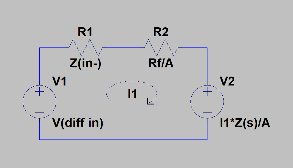

The danger when oversimplifying things is that the conclusions may also become questionable.
In this case, Vth2 is regarded as an independent voltage source which is of course not the case as shown below.
If, when leaving Zout as insignificant, we replace Rg/(Rf+Rg) by 1/A, then Rth2 = Rf/A and Vth2 = Vout/A.
Because Vout is I1*Z(s), Vth2= I1*Z(s)/A
Your Figure 3 can then be rewritten as in the image below.
Since current I1 feeds back into Vth2, I find it hard to follow your conclusion.

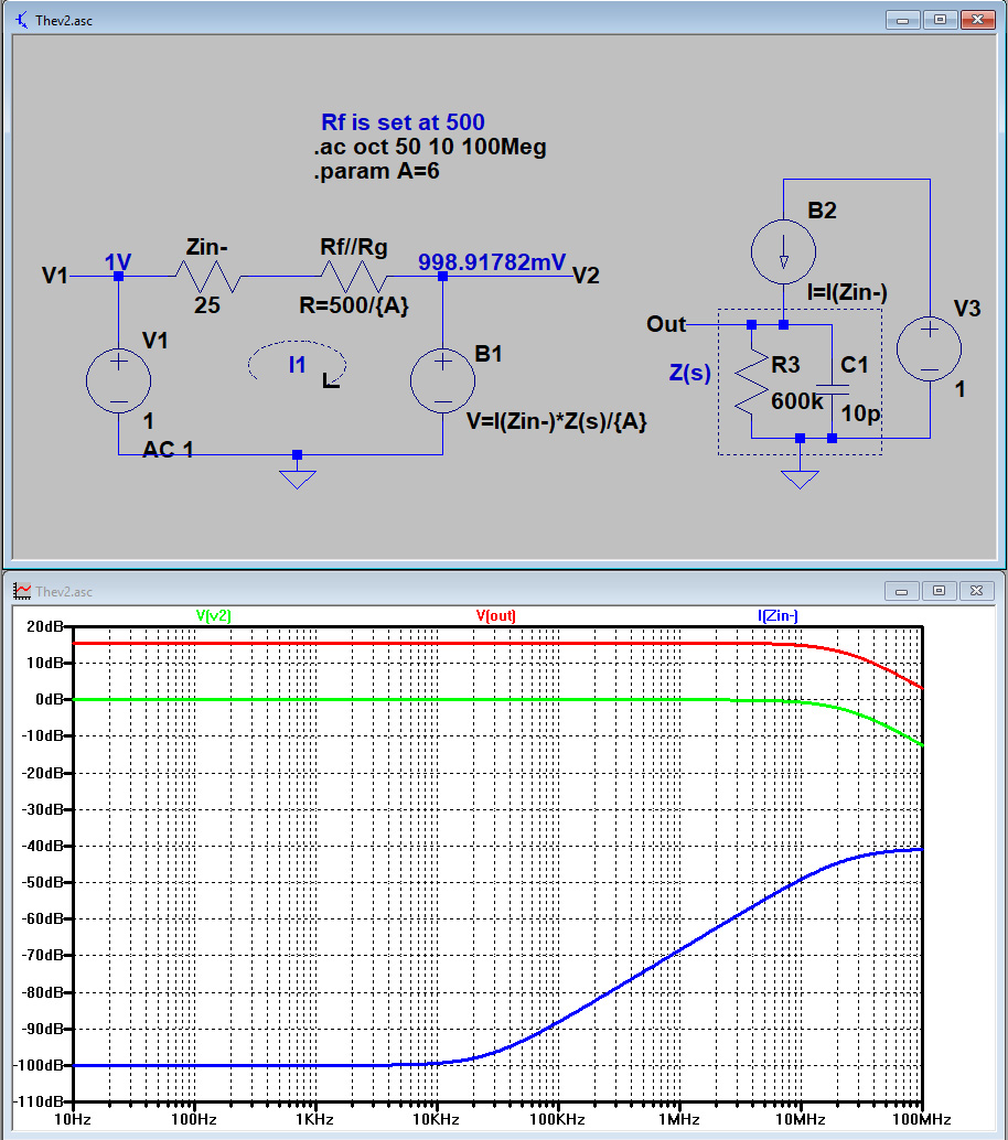

Thanks Chris. A VFA doesn't seem remotely close to being identifiable as a CFA.
In case you might wonder wether this works, here is an example for Rg=100 Ohm and Rf=500 Ohm giving A=6 and I made Z(in-)=25 Ohm.
I have also added a DC voltage of 1V at the input, thereby making the DC voltage visible at Vth2.
Hans

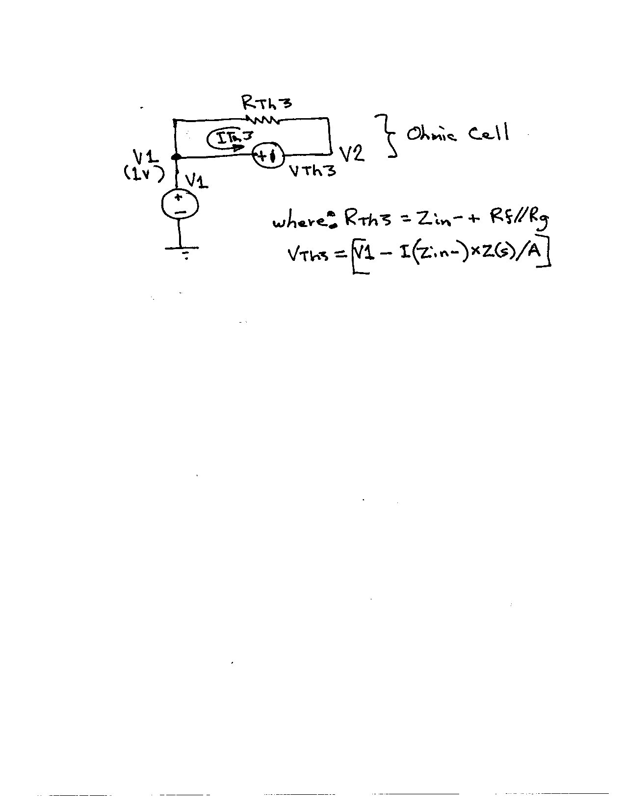

Hi Hans. Below is the Thevenin equivalent of your example. The only difference is that you have introduced a V1 voltage to ground to the floating Ohmic cell that was identified in my post of #2462. I have simply changed RTh3 and VTh3 in accordance with your values. Given that an Ohmic cell still exists there isn't an independent variable, hence this still leads to the conclusion that a CFA cannot be identified as functioning either as a c.f. or v.f. amplifier.
Your drawing is completely correct, although somewhat less readable in this compressed form.Hi Hans. Below is the Thevenin equivalent of your example. The only difference is that you have introduced a V1 voltage to ground to the floating Ohmic cell that was identified in my post of #2462. I have simply changed RTh3 and VTh3 in accordance with your values. Given that an Ohmic cell still exists there isn't an independent variable, hence this still leads to the conclusion that a CFA cannot be identified as functioning either as a c.f. or v.f. amplifier.
LTspice cannot function without a connection to GND and the 1V DC was added as an extra means to control the correct working.
But now you can see in your Vth3 that I(Zin-) is part of it, which was not at all obvious in your previous posting.
This is the most essential part of them all when you want to draw conclusions which you did concerning VF or CF.
Hans
Hans

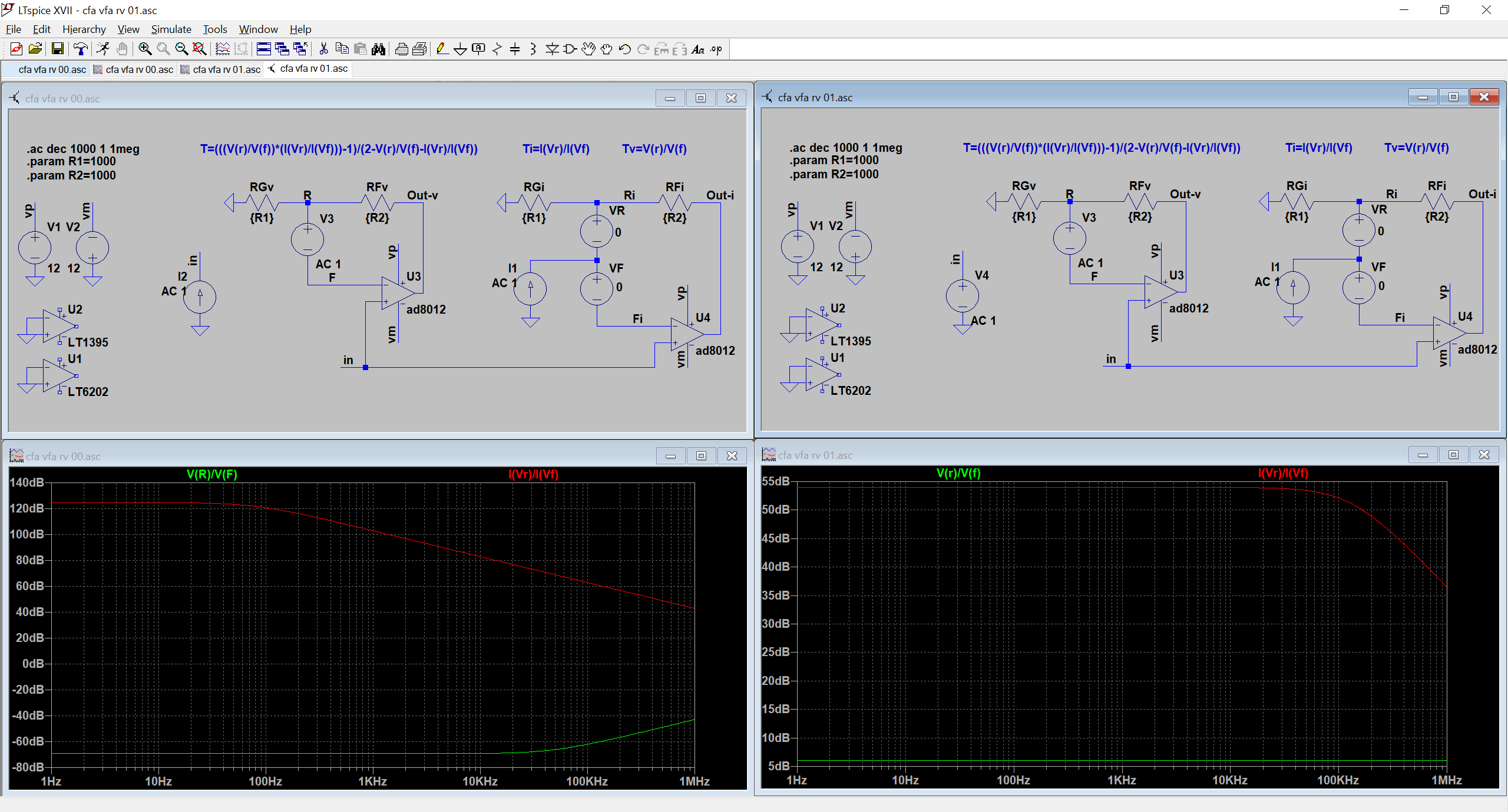

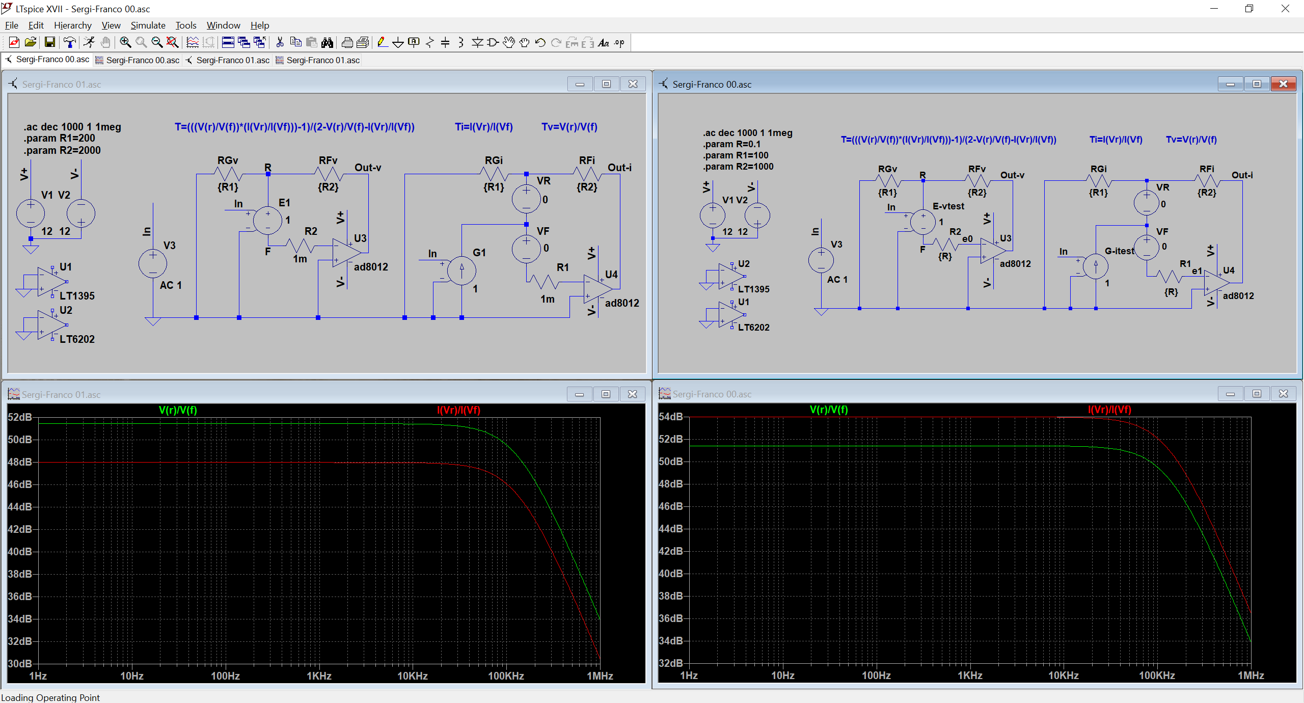

In a CFA, the major signal (as opposed to bias) current(s) flowing through the active device(s) connected to the feedback input is (are) equal to the difference between the output and ground feedback network signal currents.
The active device current is the opposite of the difference between output and ground feedback network signal current.
It is conform with a strict application of Kirchhoff law on node In- where Rf, Rg and active device are connected.
This relationship, along with Middlebrook’s D.I.T., makes it reasonable to allude to current feedback in this circuit. (This should not be construed as meaning that there is no voltage feedback in a CFA.) This classification could be extended all the way back to circuits designed 90 or so years ago. In a VFA, there is no such relationship, and no justification for claiming current feedback.
This is separate from the question of the relative and absolute amounts of current and voltage feedback in a circuit.
What I understand of the MDIT is that if feedback network impedance is greater than In- open loop impedance, current loop gain is lower than voltage loop gain. Consequently, if feedback network impedance is lower than open loop In- impedance, voltage loop gain is lower than current loop gain. So the classification given by the test depends on external componants and not only to its topology, it can be noted the the 2 behaviours are obtained with quite normal resistors value.
This is obtained with CFA in inverter mode, which is not the most common use of CFA, where the In- impedance is at its lowest value.
If we run the same test with a signal at In+, voltage or current signals, results are always the same : voltage loop gain is always lower than current loop gain.
My conclusion : In "normal" operating mode, the main feedback mode of so called CFA is voltage as the voltage loop gain is far lower than current loop gain. Of course it exists a current which can be called feedback current, this current is the result of voltages applied on active device input and output.
