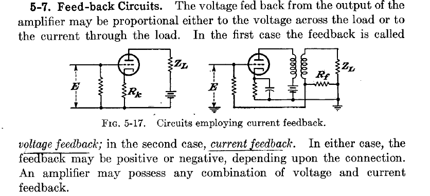

F. E. Terman, Engineering Electronics: Clearer impossible.
I'm well aware of the historical usage of this term. Tell me, please, in the case of "current feedback", the path of the current being referred to - to what/where is the subject current being fed back?
Anothe example: Seely.
Never has been mentioned the magnitude of the amplifier receives, only in the manner it is taken from the output. This gives origin to the 4 mode of feedback an amplifier: Current-current, voltage-voltage, current-voltage and voltage-current, or in other words; voltage, transimpedance, transconductance or simply current amplifier.

To justify my position on this, I refer you to the 4 canonical feedback forms - these are normally described in terms of 'shunt' and 'series' output and feedback.
You have discriminate clearly and decisively between CURRENT OUTPUT (aka 'constant current output') and CURRENT FEEDBACK AS Jan has mentioned. We can restate the canonical feedback forms in plain English as:-
A current output amplifier using voltage feedback (example would be constant torque drive of a motor or a current drive for a loudspeaker)
A voltage output amplifier using current feedback (generally in audio circles this is what we call a CFA)
A current output amplifier using current feedback (rarely used)
A voltage output amplifier using voltage feedback (the most common type of audio amplifier - tube or solid state).
