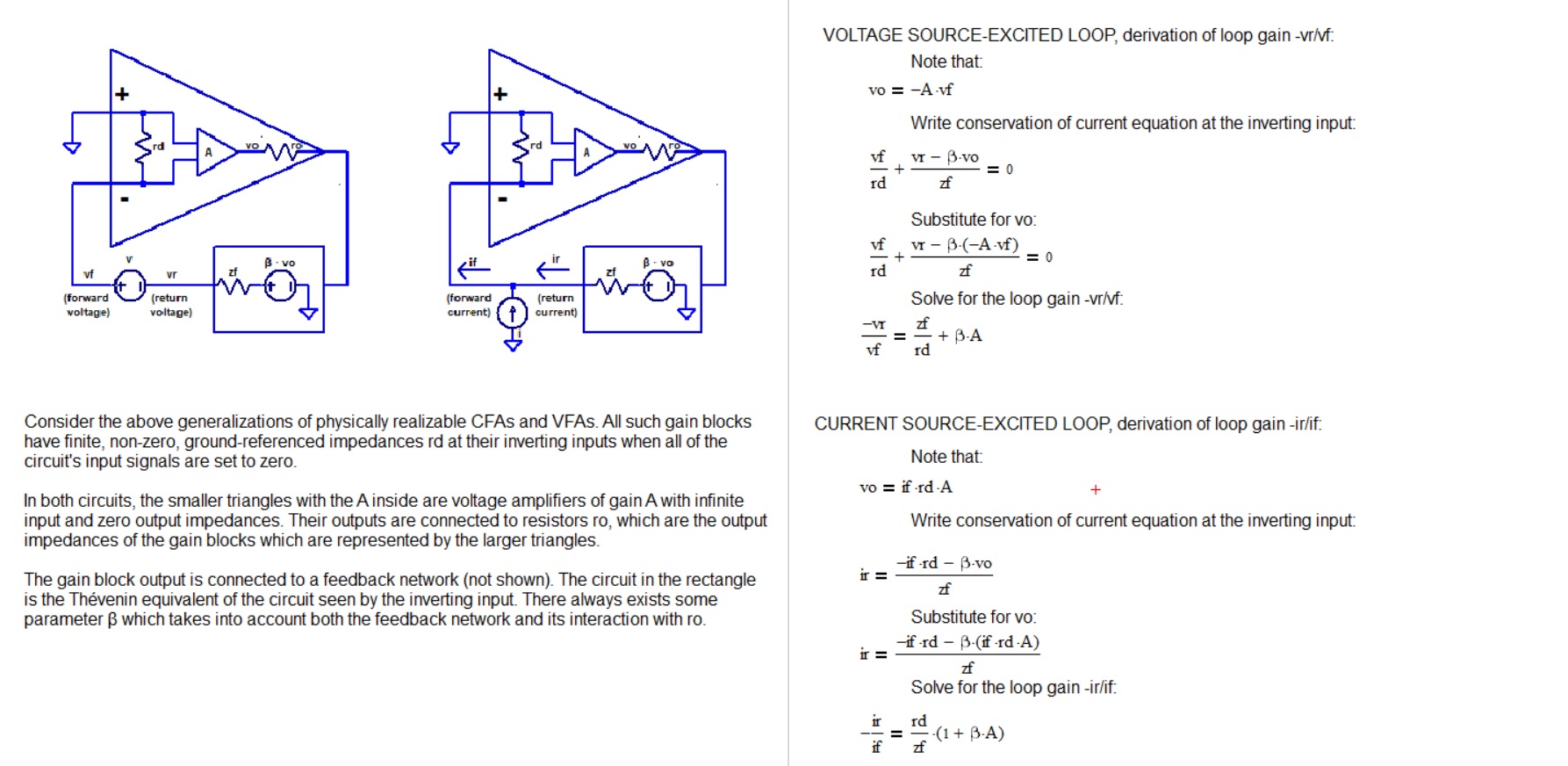

I had not done so, but I now show this in the attachment.
OK, consider a zero output impedance gain block with an open loop voltage gain of a and a feedback factor of b. If we substituted "voltage" for "current" in what you just said, the loop gain would be a divided by a / (1 + a b) = 1 + ab. Where does the extra "1" come from? You need to derive your claim.
I need to add a comment to one I made above in Post 2602. Please reference the bold text above. I am trying to interpret your claim, and I'm not sure how to do it. An alternate interpretation could be
the loop gain would be (a b) divided by a / (1 + a b) = b (1 + ab). I believe that we can agree that the b^2 doesn't make sense. I recommend that you derive your claim.

1) I can't accept any calculation or conclusion drawn from the model you attached. It doesn't represent a generalization of existing VFA or CFA, as it is not possible to say that
vout = i(in-)*rd*A where rd is the differential input impedance and A the voltage gain of the amplifier, represents a general behaviour of amplifiers.
2) The starting point of your calculation is that the current loop gain is ir/if, it is that point I disagree.
You may have forgotten that in Post 2575, in response to your concern, I granted your point about differential input impedance. However, there is still in any real op amp a finite, non-zero, ground-referenced impedance looking into the inverting input when the non-inverting input is grounded. For a voltage to arise across the two inputs, a current must flow through this impedance. And either that voltage is amplified and converted into another voltage (for voltage output amplifiers), or the current is converted through an impedance Z. There are no other possibilities, and both are discussed in 2548.
But if your claim really is true, then it should be simplicity in itself for you to find an op amp whose AC performance you can simulate and present here to demonstrate that it does not follow the model that you reject. I challenge you to either do so, or to accept the model.
Here I suspect that there is a problem with words. The current gain around the loop is clearly ir/if. Insert a current into the loop at the inverting input. A portion of it becomes the forward current if. The loop modifies it and returns it, or feeds it back, as ir. The analysis and any simulation you care to perform will confirm this. If a signal is modified, looped around, and fed back to its starting point, then there is feedback. The very meaning of the words prevent us from escaping this conclusion.

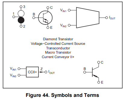

What I noted was the use of 'OTA' (operational transconductance amplifier) for the CFA core. I wonder why that hasn't stuck instead of CFA. We would have saved a lot of bandwidth and grief if it had!
I'm not so sure. The OTA core could be used with a dual double diamond input stage or a classic long tailed pair. The "grief" has to do with whether the input stage presents bases or emitters to its inputs, not with the nature of the core.
"CFA" and "VFA" appear in a few figures; the phrase "current feedback" appears three times in the text and voltage feedback once. "Current feedback amplifier" and "voltage feedback amplifier" appear in the captions of several figures. To my mind, for what little it's worth (my opinion that is, not my mind), they are using the terms correctly.
My impression is that TI uses the term CFA for an (OTA +output buffer) which is an understandable division of functions.
An OTA is an Operational Transconductance Amplifier, a voltage-to-current device. This is a sensible name for a circuit if you differentially drive the bases of its two double diamond input stages. But how could such a device be called a CFA?
If instead you apply feedback to the emitter of a single double diamond input stage, then it is reasonable to call the device a CFA. But then it seems a bit of a problem to call the input portion an OTA.
Since feedback could be applied to either point, a better term for the input stage might have been Current Output Amplifier.

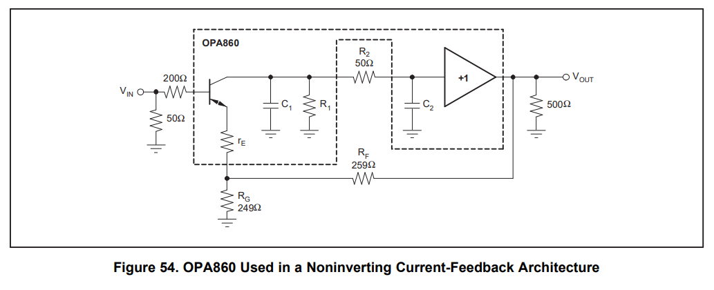

Chris,
Have a look at fig 54 in TI’s OPA860 spec.
OTA + Buffer = CFA
That’s how they call it, the rest is history.

Forgive me; I would not want to disabuse you of the Gospel According to T.I.
Figure 54 is indeed a CFA. But in that figure, do pins 2, 3 and 8 of the part constitute an OTA?
Well, there is a voltage at pin 2, but T.I. also proclaims that there is current feedback. So if the word from on high is that we have a voltage at one input and a feedback current entering the other, do we really have an OTA?
If the only pin 2 connection were to a grounded resistor and pin 3 were driven by a voltage, we'd indeed have an OTA.
The Marketeers had to call it something. But since it could be used in different ways, isn't something like "Current Output Amplifier" a better description of the ways that that portion of the part can be used?
