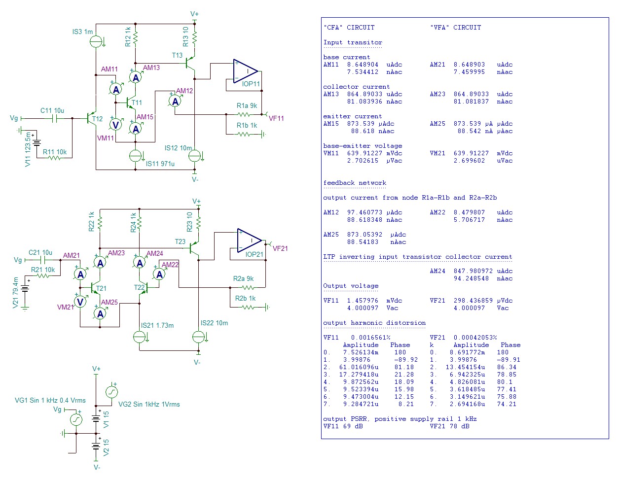

Here I modified my drawing of post #636
I added an ameter, AM15 or AM25, in series with each emitter of the input transistor, T11 for the simplified CFA, T21 for the VFA.
Results are very clear, the input transistors work with equal voltages and currents :
emitter current
CFA --> AM15 873.539 µAdc
88.618 nAac
VFA --> AM25 873.539 µAdc 88.542 µAac
base-emitter voltage
CFA --> VM11 639.91227 mVdc
2.702615 µVac
VFA --> VM21 639.91227 mVdc 2.699602 uVac
base current
CFA --> AM11 8.648904 uAdc
7.534412 nAac
VFA --> AM21 8.648903 uAdc 7.459995 nAac
collector current
CFA --> AM13 864.89033 uAdc
81.083936 nAac
VFA --> AM23 864.89033 uAdc 81.081837 nAac
The output currents of the common node of the feedback resistors R1a-R1b or R2a-R2b are :
CFA --> AM12 97.46077 µAdc 88.618348 nAac
VFA -->
AM22 8.479807 uAdc 5.706717 nAac
VFA --> AM25 88.54183 nAac
With the VFA circuit, the buffering action of inverting input transistor T22 provides the same value of AC current to the emitter of input transistor T21 (AM25)as the value of AC current directly provided by feedback network in the CFA circuit (AM12).
In both cases, the input transistors works with the same variations of Vbe and of emitter current.
If the current variation of the input transistor is considered as being the controlling value, then both are CFAs.
If voltage Vbe of the input transistor is considered as being the controlling value of the device, then both circuits are VFAs. I very much prefer this way which is by far easier to use, for example to quickly evaluate thermal influences.

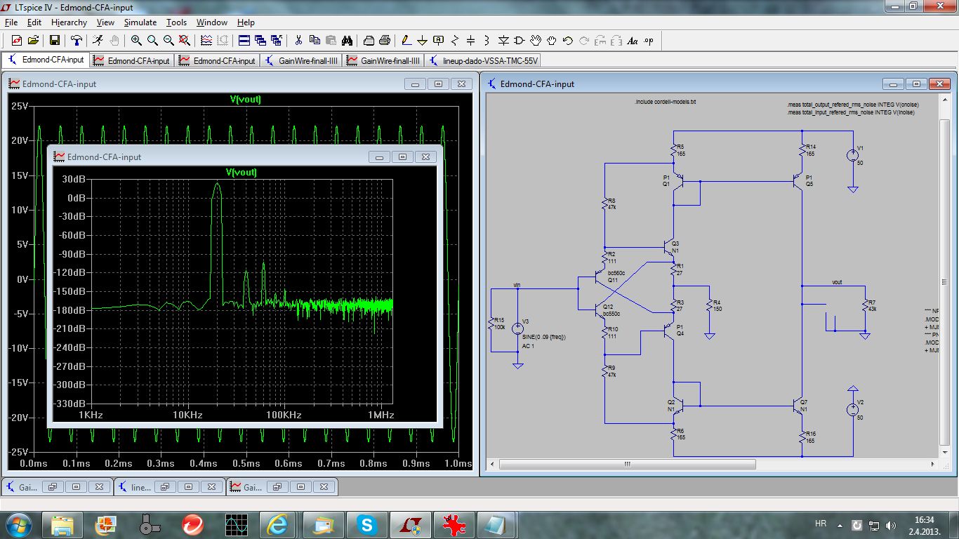

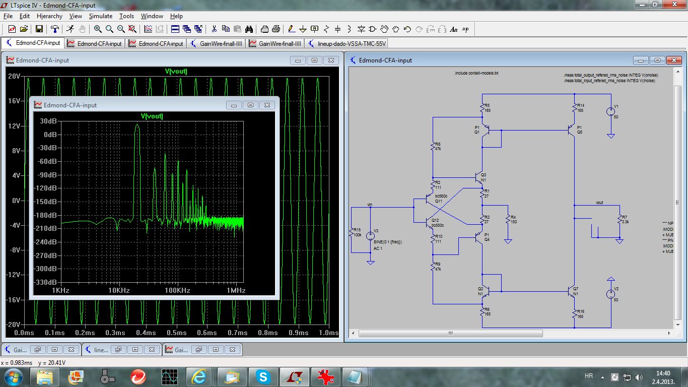

Hi Edmond,
Here with idealized transistors(it sims that idealization work only for FB ).
BR Damir

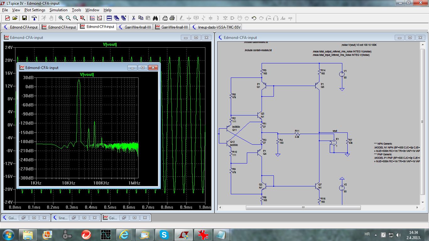

Damir
I would think its more apples to apples if you leave the load resistor the same in both cases and adjust in input voltage in the open loop case to result in the same output swing (your simulation has significantly more collector current change in the open loop case).
-Antonio
Antonio, you were right. Distortion increases from 0.000016% fot the CFA to 0.000046% for the open loop CC.
Damir

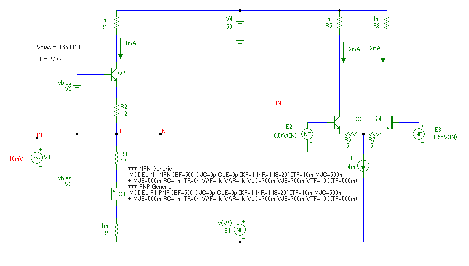

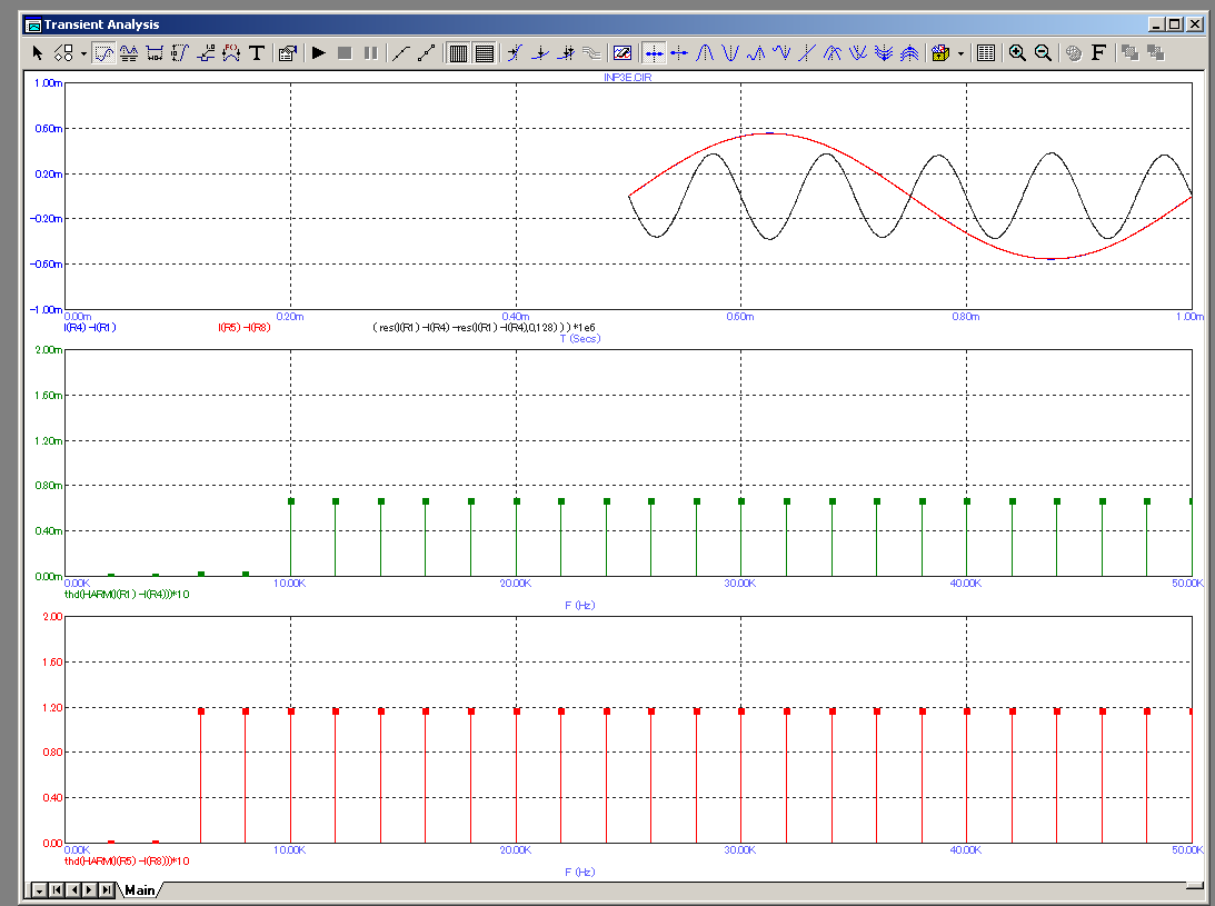

Hi Magnoman,
I should not have put the distorsion results. I have simulated the circuit with a push-pull input stage with good results but it complicated the comparison with a differential input stage.
My aim was not to compare the performances of CFA vs VFA.
I was interested how both circuits work. I think that the shown values of voltages and currents prove that the circuits are fundamentaly governed by exactly the same principle which has already been clearly explained using few but sufficient words in some previous posts.
Both camps are wrong. With CFB almost all odd harmonics are cancelled. The 5th harmonic is clearly visible, though THD figures, compared to a VFB stage, are enormously smaller.
THD CFB: 0.7ppm
THD VFB: 1100ppm
edit: the black curve is the residual of the CFB stage. Green is THD of the CFB stage, red is THD of the VFB stage.
E.
