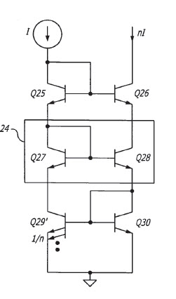

Here is something different (non-group) idea. Everyone seems to be hung up on Widlar Mirrors.
Taken from the following patent,
http://www.google.com/patents?id=0tAgAAAAEBAJ&printsec=abstract&zoom=4#PPA1,M1
This is a great read as it includes numerous examples of different mirrors.
Jam

Re: Non-Group Mirror
My first impression of this mirror is that it is sub-optimal in a couple of ways. Just because something shows up in a patent doesn't mean it is any good.
This looks like a helpered current mirror with a poor man's attempt at making its output sort of a quasi-cascode.
First and foremost, it brings the collector-base nonlinearity right into the picture. Secondly, it looks like it introduces current imbalance via the base current of the quasi-cascode transistor.
Maybe I missed something here. That's just my first impression.
Bob

Mr.Cordell,
I was hoping for more input on different kinds of mirrors especially the Widlar and Wison.
Thanks for your insight into the circuit posted, I see your point on where the weaknesses may be.
Do you have a preffered type of mirror?...............
or how about this which appears be some form of cascoded Widlar/Wilson Mirror? 😱
Jam

Ostripper as you are the one with the iron in the hand, could you try that widlar again but instead of connecting the collector to ground connect it instead to ltp current source, (between the two ltp emitter resistors) , should have some effect too. This way the helper transistor will have constant current source with the advantages of a high impedance node.
Jam, a combination between a widlar and the three transistor wilson gives quite a big performance jump and sounds much better than just a standard CM but then again it was in a design where I settled for using cascoded mirrors which doesnt have ltp. It would be interesting to hear results with a blameless so maybe ostripper can test these things on his amp. I connect the widlar as the above post though.
BTW Bob I simmed that patent circuit and it certainly outperforms all the others. After simming the combination above the two perform on par. I cannot comment on the sound of the patent circuit but Ive found that any combination or the trick like sandyk uses to bringing better balance between the two halves of ltp have positive effect on sound, that is on a blameless.
