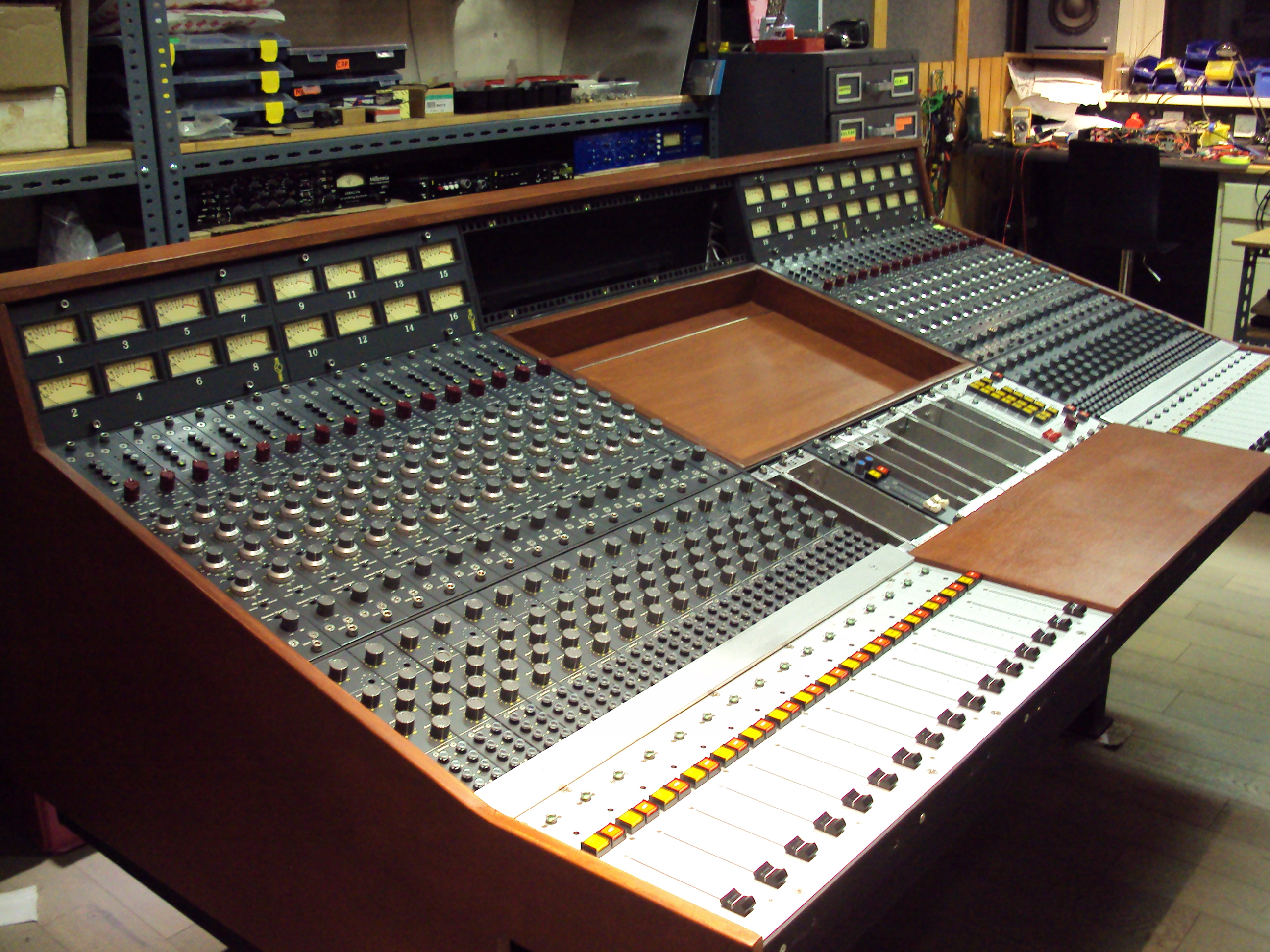

Ok guys,
A little update on our console build.
This is where we are now

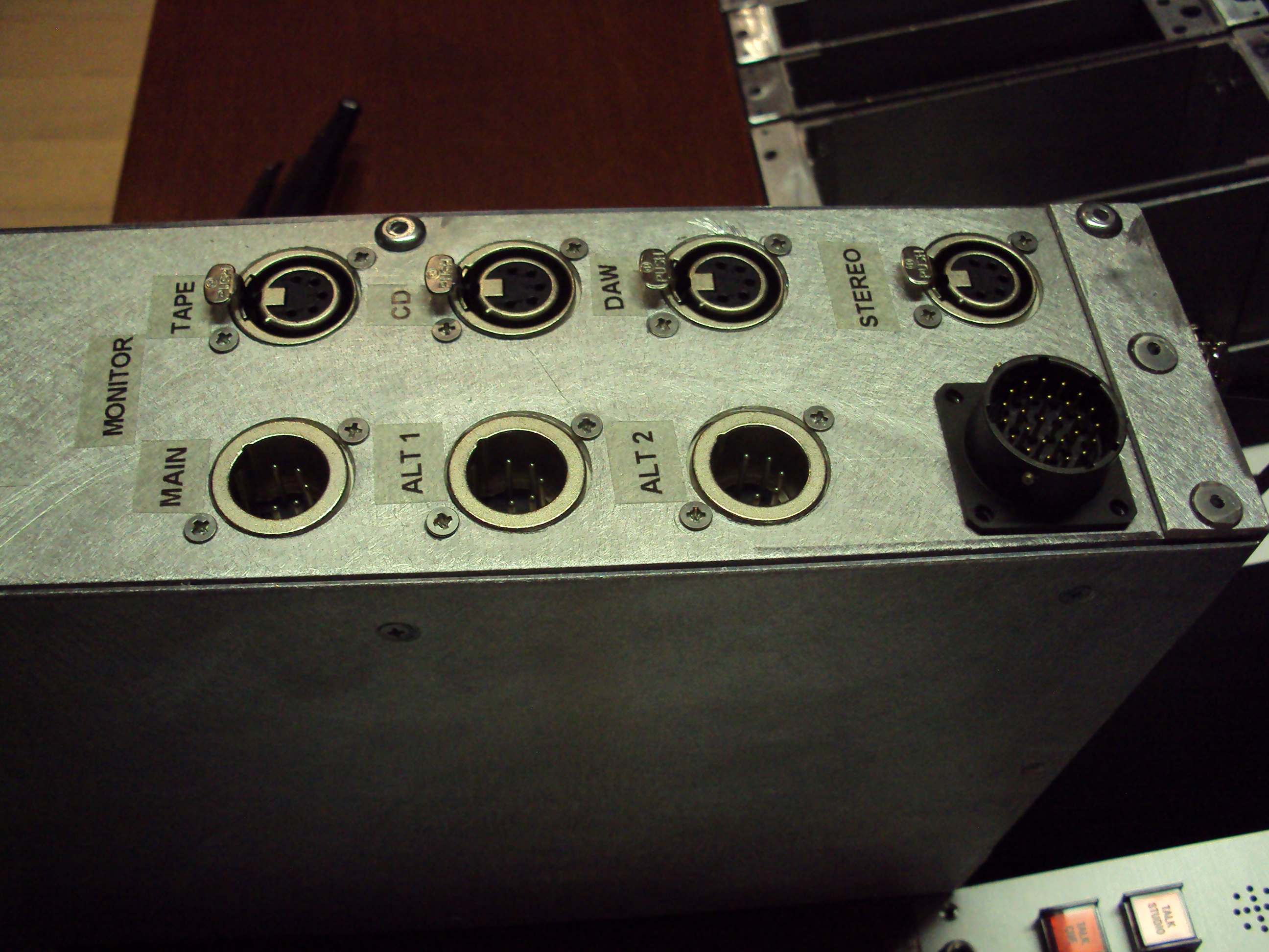

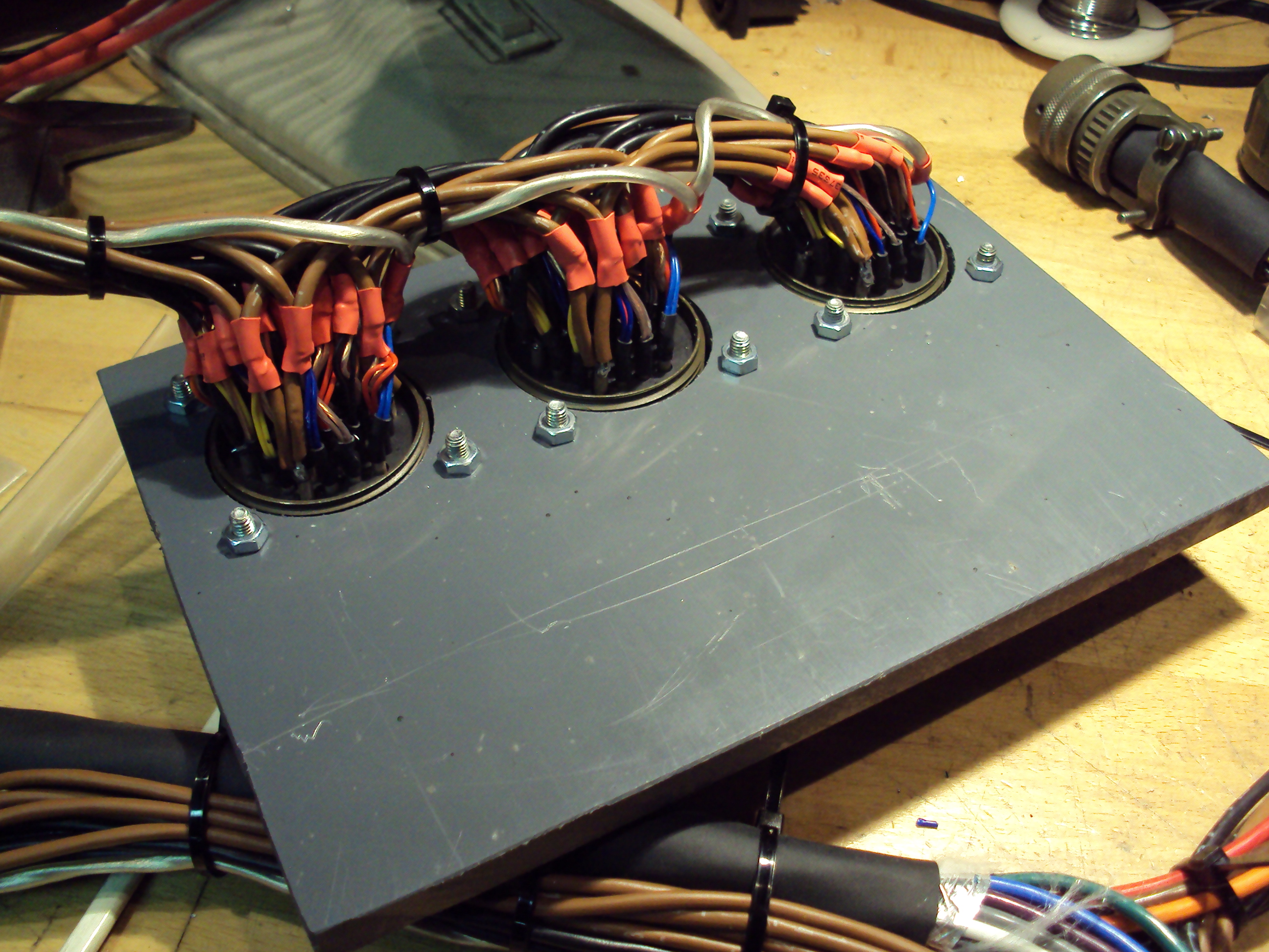

Connectors that are used to connect the BUS lines together. These are located on the mid section. there is one extra connector for a future expansion.
These are mil spec connectors made by amphenol.

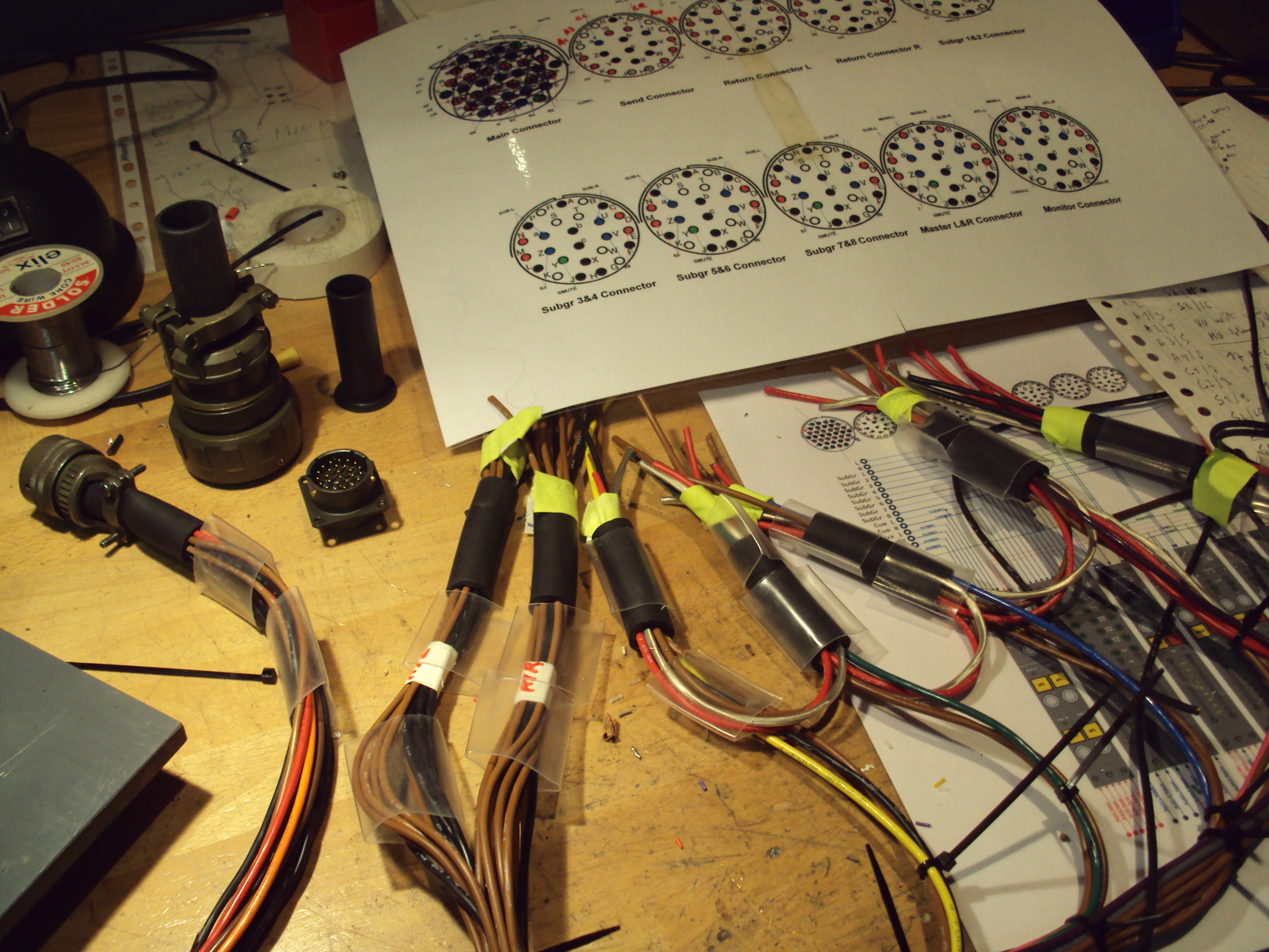

This is the cable boom been made for the mid section modules.
Back of the monitor section.
XLR's are used for external in/out
The rest comes from the smaller amphenol connector
and then here is a small schematic overview of the midsection routing.
http://www.aman-nai.be/console/middensectie.pdf
There can still be small faults/changes on the schematic overview as we go along.

The frontpanels where done by schaeffer. Al the rest of the metalwork we did ourselves (even the channel module cases) The channels are based on the 19" standard.
The mechanical work is amazing! It looks excellent too.
The thing is if you just want a mixing desk for hobby projects it would be cheaper to get some china whatever oem brand product. It will work as intended but it will not last. If you want something with very decent quality however it would be very difficult to find something to begin with and it will be VERY expensive.
Our goal is to make it last a long time and sound good.
I have deep respect about your craftsmanship. But, well, 'nobody' wants analogue mixers anymore. That's why you can get professional 24/32/48ch mixers from renowned EU manufacturers for below 1000 bucks. And they are built like tanks too. There are tons on the market, many become scrapped because they can't sell them.
You're not done yet and looks are easily deceiving but it looks you didn't plan to go for subgroups?
There are 8 Subgroups 😉
And while there are a lot of big mixers on the marker. Most of them are not inline, Don't use the classic neve circuits (all transformer coupled and class A)
And they are build like tanks but we decided to go one step further. (most consoles just use flat cable and subd connectors......we use all screened cable/ mill spec and XLR connectors)
So there is a big difference.
But indeed analog consoles are less used for mixing...
But you still need preamps to track.
The mixer is made with this in mind also.

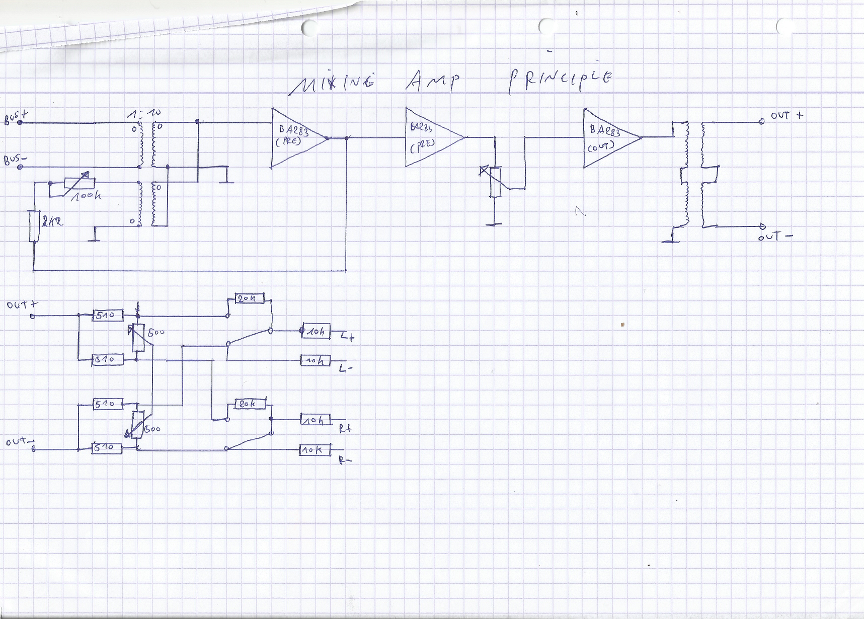

Ok, So it took a while for an update, Just been busy with the consoles. When doing a project like this, you get to learn a lot about grounding etc.... The mixing busses are completely balanced so no grounding issues here. But the summing amps have around 40db of gain. The amplifier stages are single ended class A stages so the routing of the ground is critical. Some of it was trial and error. A tip for anyone is to split Analog ground / digital ground and screening but be carefull to not make unwanted loops. A second tip is to imagine every ground wire/connection as a resistor A third tip is to connect screening only on one side.
So first of I have made a sketch of the summing principle I used.
I could have just use a normal style neve preamp with a fixed gain and keep impedance of the bus constant (voltage summing = passive summing).
On the other hand to avoid pops/clicks and to avoid having the impedance constant it would be nice to use a form of active mixing = current summing
My goal was also to keep the buss balanced to avoid common mode noise
So I came up with the idea of the following schematic.
The bus is terminated in a transformer that is coupled to the aplifier stages. the transformer is 1:10 but using the secondary in parallel it's 1:5. This way the impedance of the bus is a better match to the input transistor(noise) "BA283 pre" means the preamp stage of the neve BA283 board "BA283 out" means the output stage of the neve BA283 board
the output of the first preamp stage is fed back to the transformer.The coil of the input is the same ratio as the feedback coil. The resistor is added to set the gain. When the impedance of the bus changes the gain of the circuit changes. The frequency response is also linearised. the output capacitor of the ba283 preamp stage is made bigger and the gain of the stage shouldnt be to extreme to avoid oscillation. A capacitor across the secondary was also needed to tame the transformer. My first idea was to use the two stages and have more open loop gain but this becomes unstable. Very low frequency oscillation and sometimes HF oscillation. So I have split the stages. One with the feedback loop and another one with constant (low)gain that drives the fader.
The result is quite good and seems to work. -3db is around 60kHz with 40db of gain.

Ok So indeed it's not exactly like a virtual ground bus.
Because of the feedback I would say "virtual zero impedance" but I could be wrong at this.
If you leave out the transformer.
make the amplifier stage inverting and put the feedback on the bus.
Then you change the balanced bus by connecting the negative to GND and what you have now is a sort of virtual gnd summing bus.

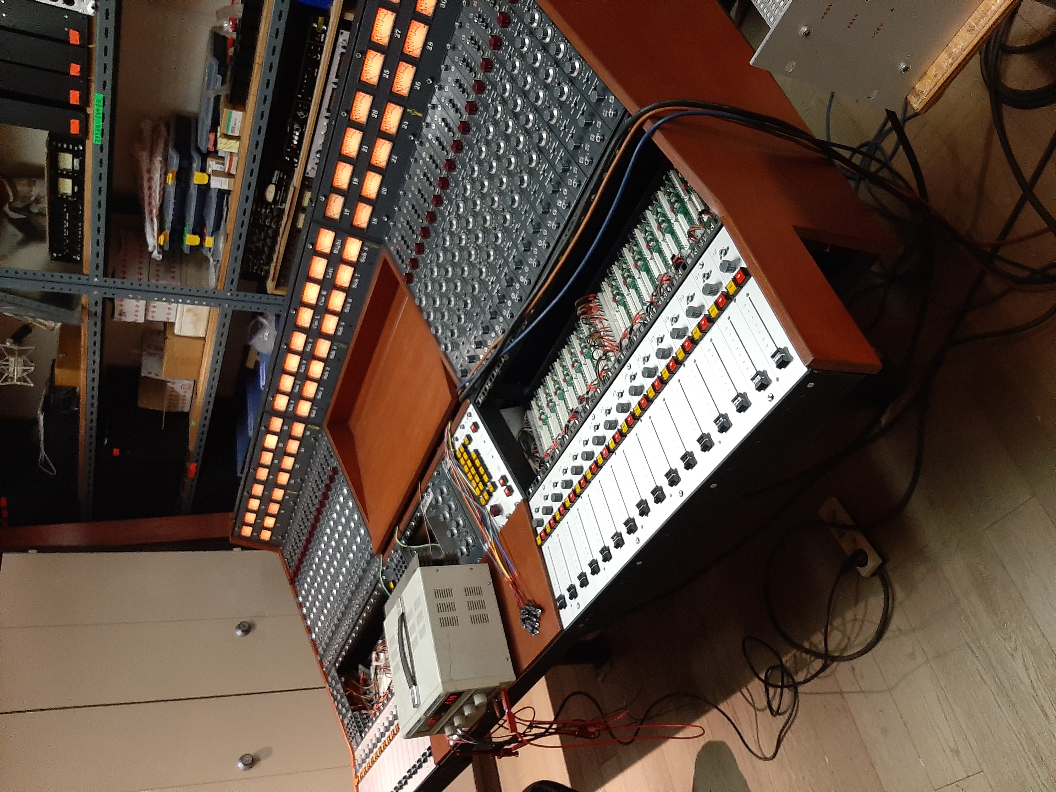

Still busy on the last bits to finish the console....
For the power supply we used 24v transformers with 2 outputs so you can make a center GND and a symmetrical power supply.
So we started from rectified 24v ac (3phase rectifier), so we have a raw supply of around 30-32v.
this comes from the big power supply in a different room.
In the console there are smaller power supplies that make this into stabilized +24 and -24 Vdc. for audio and +24Vdc for auxillary supplies.
All using LM317/LM337 regulators
This together with 48v phantom is used to power the different modules using a 5pin XLR.
Two channels for one smaller power supply. If one power supply fails only 2 channels are out.
Having +24v and -24v gives us al the freedom what to use in the modules.

In a few days there will be some more pics of teh console if I can find the time...
