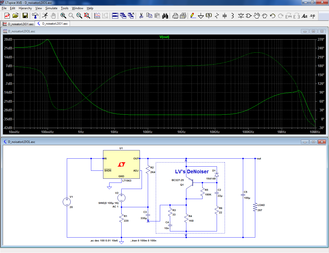

BTW, I tested the LDO hypothesis in sim, and to my surprise, it seemed to work with very minor tweaks:
attachment.php
The tweaks remain perfectly compatible with a regular 317, and it could even benefit from them.
Of course, it is just a sim, and the reality could be less rosy, but since it is a IC from Linear/ADI, one can realistically expect a good agreement between sim and reality.
The improvement is the same 30dB as for the 317

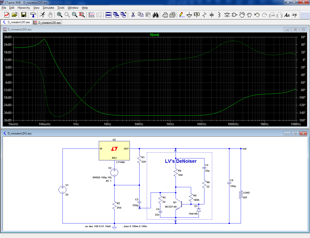

LT1086 not exactly their star performer at 4-5 $. Data sheet doesn't even give info on noise.
What about TPS7A4501 (3-4$) , LT1963A (5-6 $) or it's TI clone TL1963A (3 $), all in the easy TO263. They may be too different to implement the DeNoiser.
The TPS is not a native LT/ADI circuit, which would mean relying on approximate/behavioral models, not ideal.
The LT1963 is native, and does not work like the usual adjustable regs, but it looks compatible with the denoizator:

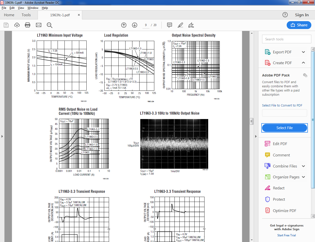

So that's about 30 times less noise with the DeNoiser . LT1963A's datasheet gives 200uVpp 10 to 100kHz (page 11), for 15 V out that's nearly 1mVpp or 400 nV/rHz , with the Denoiser approx : 330uVpp or 130nV/rHz or 50 uVrms ? (all for 15 V out 10Hz to 100kHz) . Against your 300nVrms with the LM317. My numbers must be wrong .
We probably don't have the same datasheet: here is what I found page 9:
attachment.php
I wouldn't rely too much on the P to P visible on the oscillogram, since the total rms noise (15µV) and the spectral noise density are also given (40nV/√Hz).
These values will be divided by ~30 with the denoiser since the result is higher than the denoiser's own floor, so 500nV rms total noise for a 100kHz bandwidth, but the measurements I made were for a 10kHz bandwidth, so the extrapolated/100kHz value for the 317 + denoiser should be 300nV*√10~=1µV
I just downloaded a fresh one , and yes there it's on pg 9. There is no date on the LT datasheets (TI does have dates ... or revision dates) . But those are the same graphs . It differs greatly for a 3,3 V or a 15 V output voltage . Those oscilloscoop pics are usually accurate , so here it is 200 uVpp for 3,3 Vout = approx x4,5 for 15 V = near 900uVpp or divided by around 6 = 150 uVrms . The 15 uVrms you mention is the 1,5V out version or the adjustable version at 1,22V (the minimum output =bandgap Voltage) , 15 V out is then 10 times the noise of 1,5 V version = 150 uVrms . Again let's take the 1,5 Vout version : 0,5 uV/rHz x 10 (for 15 V out ) = 5uV/rHz all for 10 Hz to 100kHz. TI and LT are pretty clear that the noise is proportional to the output voltage. You see it in the graphs and they often mention it in the text with the application information. I think they don't like to show the graphs or numbers with a 15 or even 18 V out , because it is NOT so great ! Maybe the DeNoiser is noisier with high output voltage too ?
So with the 1963 + DeNoiser it's going to be 5 uVrms ... still 5 times more than the LM317's 1uVrms , for 4x the price.

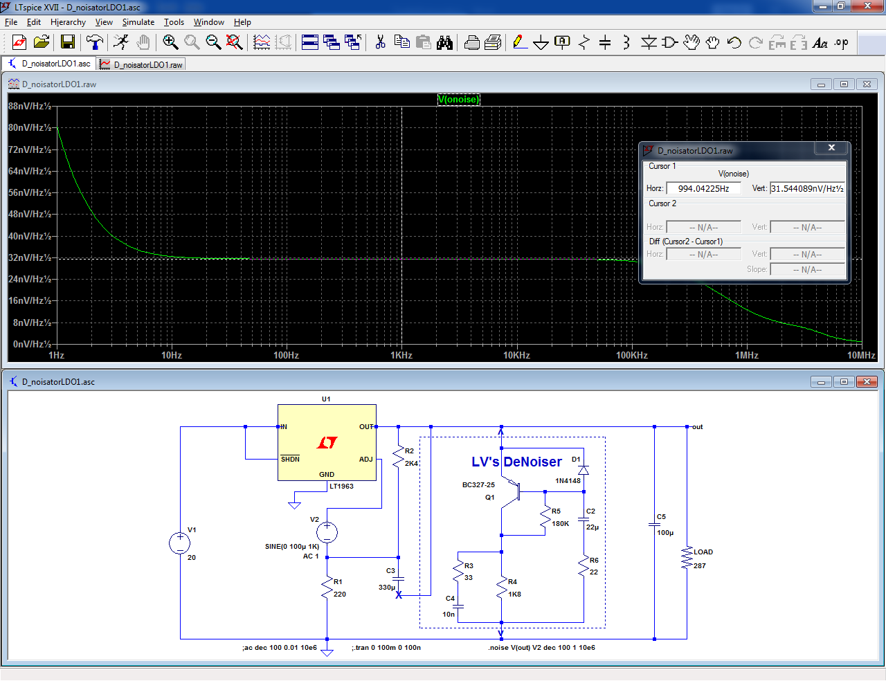

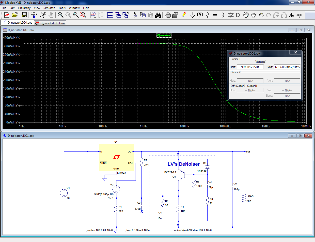

Since the LT1963 has a reliable model, it is possible to simulate the noise performance of all the options.
First, the plain vanilla regulator circuit, with just the two resistors in circuit:
attachment.php
373nV/√Hz
Then, the poor man's denoiser (bypass cap):
attachment.php
31.5nV/√Hz

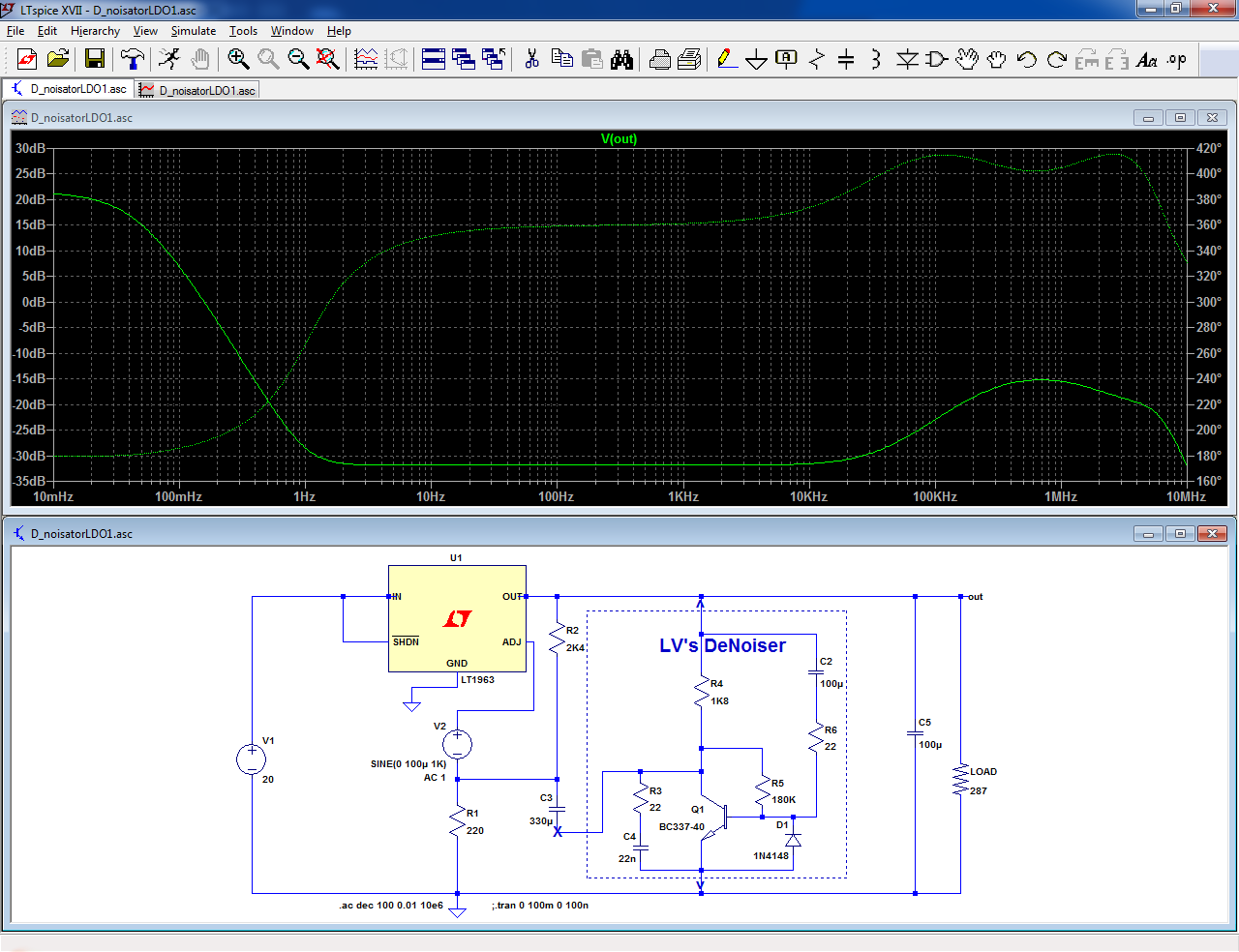

And finally, the complete denoiser in its full, glorious splendor:
attachment.php
1.04nV/√Hz
So that's a little better than the DeNoiser with LM317 +- 3nV/rHz to 1nV/rHz (but only simulated).
I like the p-p value better , which should be around 2uVpp vs 0,6uVpp . So for 5 $ more you get slightly less noise, low dropout and a shutdown/enable.
Does the PSRR get a boost too like the LM317 did ?
Yes, simulations are always a bit optimistic, and I expect the real value to be closer to 1.2~1.5nV. On the other hand, the values for the 317 denoiser are actually measured, and I have also measured other types than the BC337 as transistor:
