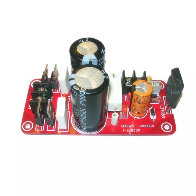

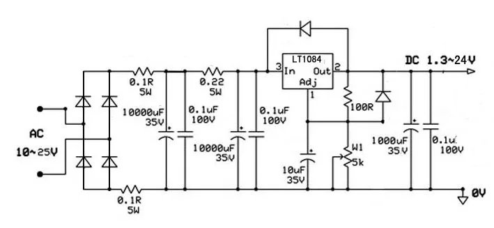

is there any way I can improve those ps board? Thank you for your advise.View attachment 898145View attachment 898146
The LT1084 works in sim, but this doesn't mean a lot (compensation etc. need to be actually tested)
For a DAC, adding a denoiser is probably worth the trouble, but I don't see any benefit for a PI (it might depend on what and how it is used for)
