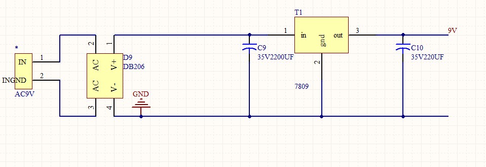

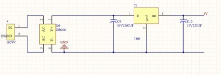

I just replaced the 100uF after the 78/79xx regs with Rubicon 1000uF. Now there is enough "umpfh" for the OpAmp stage. Will post measurements.

As for the 1000uF instead of 100uF on output of regs - the bass sounds like it should be on my headphones. Maybe for line level 100uF was OK, but for headphones definitely was needed more storage.

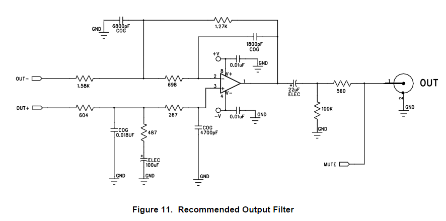

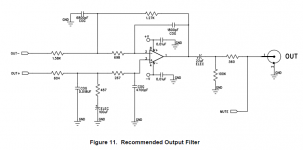

You can add those files. First two are from Lisa (ljm).
Last one is the recomended analog out stage from datasheet.

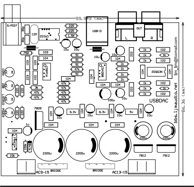

My DAC finally arrived so here is an x-ray view of the board;
http://www.pohrani.com/f/2g/v2/33hqIbEV/pcbdac.jpg
should make life easier for some... 😉

Now to fill the board with the necessary parts, which components
to put on the board you can see on the picture below;
As for choice of components; for the PLL circuit (223, 102 caps and 3k resistor) left of
CS8416, it would be good to use C0G and X7R ceramic capacitors and 1% metalfilm resistor.
I also put X7R ceramic capacitors for chip decoupling together with electrolytic caps
in parallel on the bottom side of the board...
Just avoid large "exotic" capacitors with long leads and you can't go wrong...
Next part, separating the CS8416 & CS4398 digital parts, and
preparation for the new regulators, reset circuit and input select.
From the picture below - cut the red lines and connect the green ones.
The yellow one is input select, so you can also connect it to GND
as on the picture...
