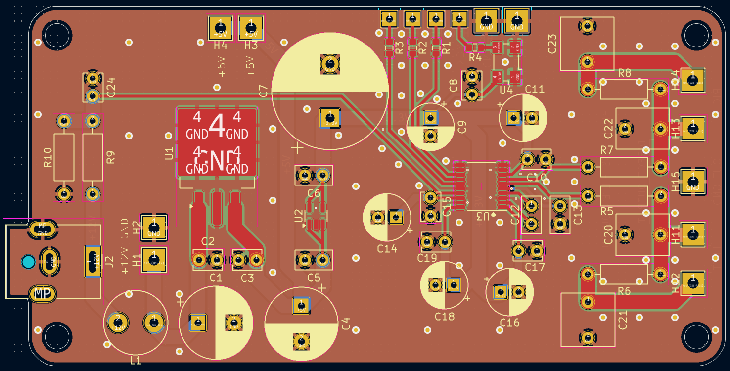

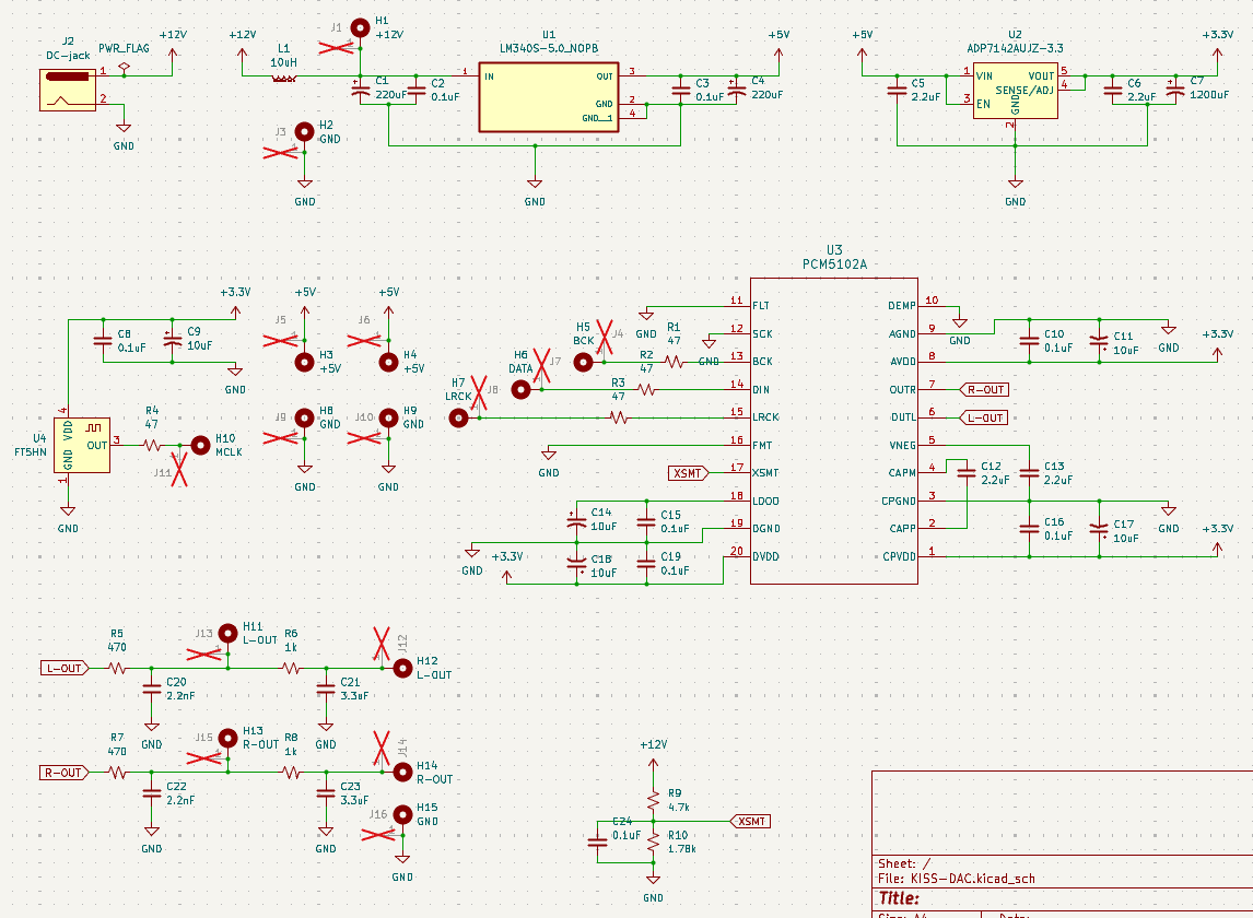

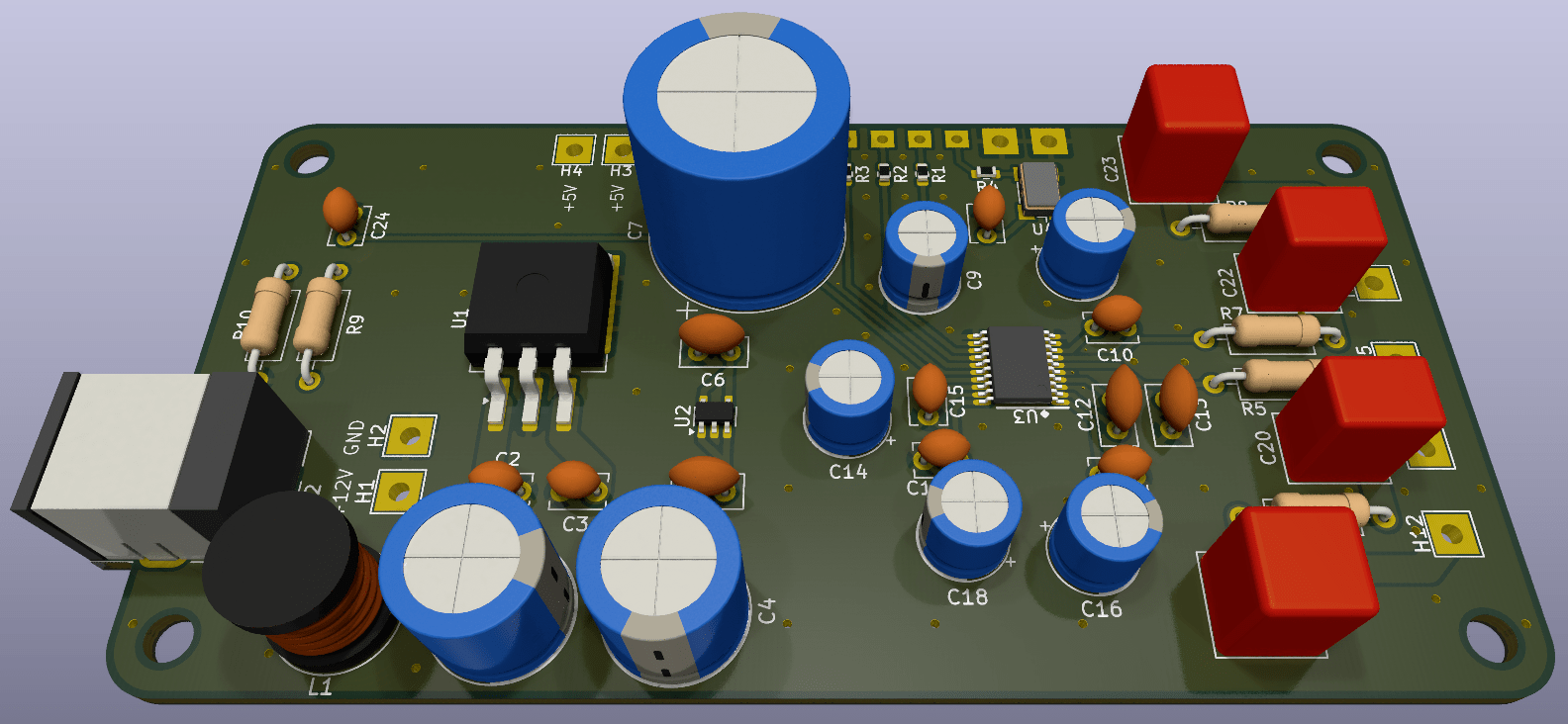

After an attempt to design a bluetooth DAC, with questionable technical choices, I decided to be reasonable and make an S/PDIF version.

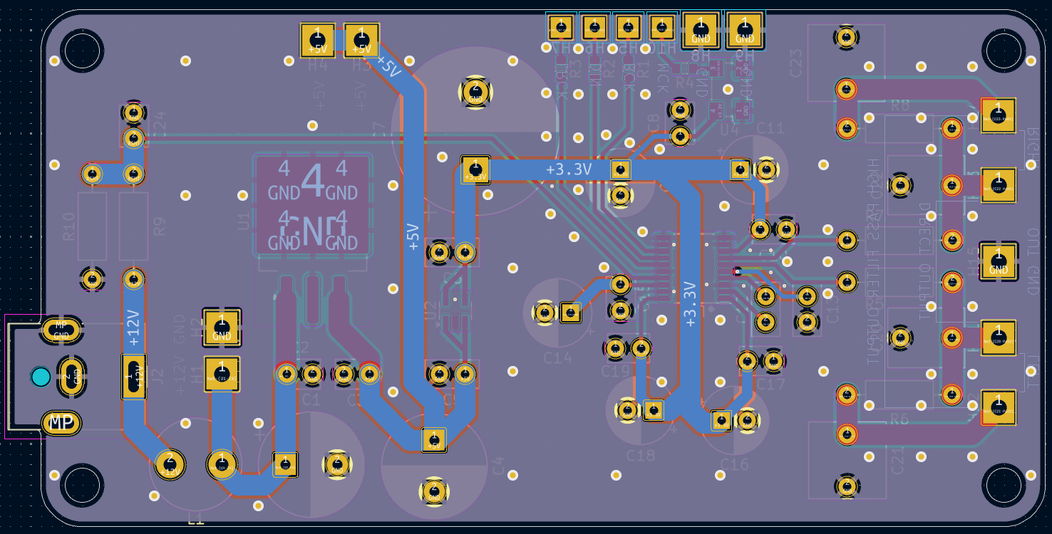

The DAC is still based on the PCM5102A chip, without additional preamplification stage, and the 100x50mm 4-layer PCB receives one ground plane per layer, connected together by vias.
I will use this module for S/PDIF to I2S conversion: https://www.audiophonics.fr/en/inte...spdif-to-i2s-dir9001-24bit-96khz-p-17274.html
For volume control, I'll use this: https://www.audiophonics.fr/en/preamplifier-modules/motorized-volume-control-board-50k-p-15006.html
From what I understand, the DIR9001 module will synchronize to the S/PDIF clock, and the PCM5102A will also synchronize via the I2S bus. I still connected the MCK pin of the DIR9001 module to an oscillator, so the DAC should keep running correctly without an S/PDIF signal, because my Tripath amp does not like to operate without a source.
I placed an LC filter at the 12V input because the DAC will be powered by an external SMPS power supply. Please tell me if the values of this filter are correct.
As advised for my previous design, the low noise 3.3V LDO is cascaded to a much larger 5V LDO to lighten its workload.

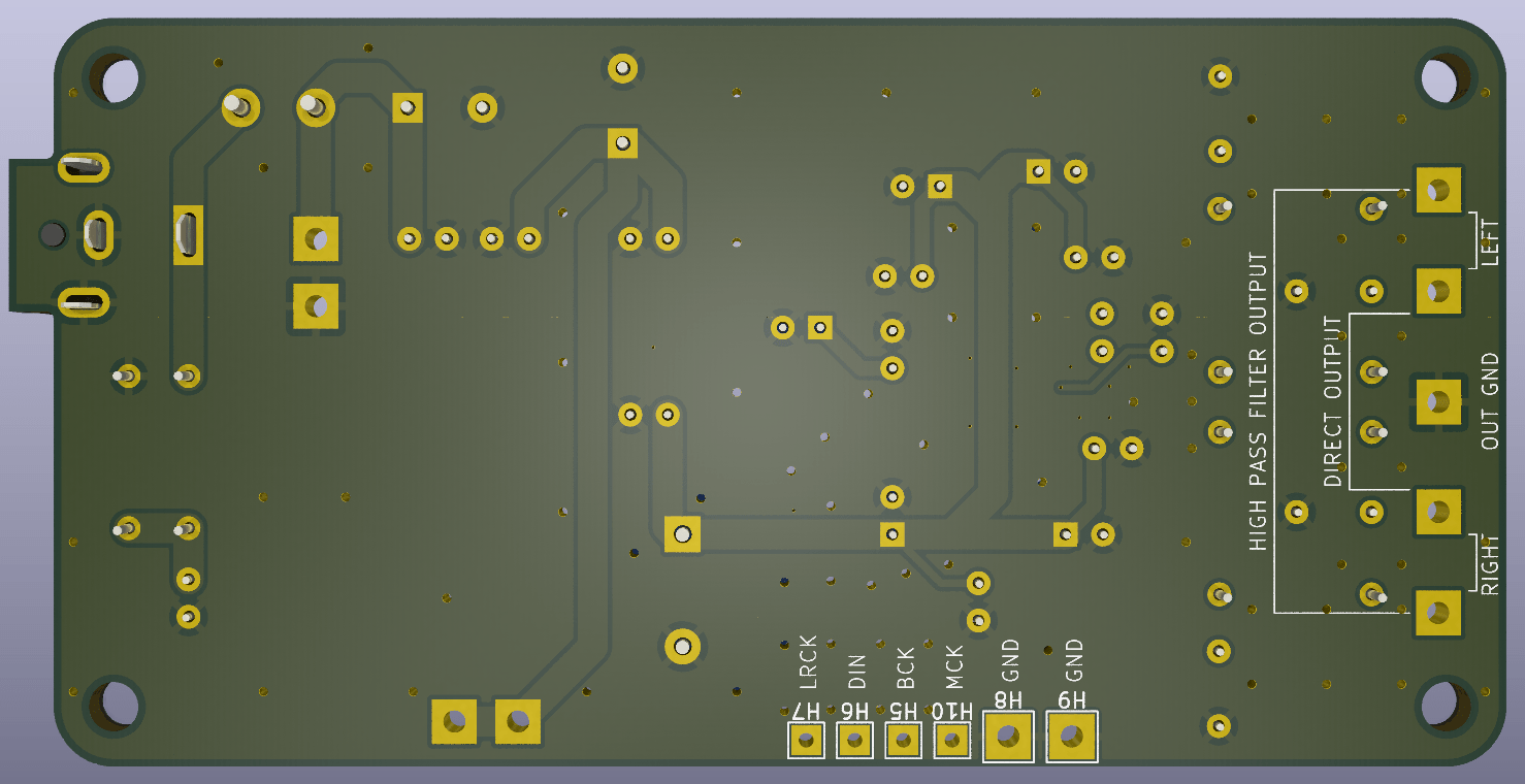

As this design was quite conventional, I couldn't resist adding a quirk, a high pass RC filter, for optional use.
Indeed, I chose the PCM5102A because it is the only decent DAC chip that I felt capable of implementing, being a beginner. But I know that it tends to be a little too generous in low frequencies.
So I added this high pass RC filter which cuts at 48Hz in the hope of being able to obtain more controlled and clean bass, if the need arises. I can use capacitors with significantly different values to fine-tune the filter. Let me know if this is a bad idea 🙂
EDIT : I just saw a big error on my high pass filter which in reality is a low pass 🤣. I am going to correct this and I am thinking of using a relay in order to be able to bypass this filter easily.
