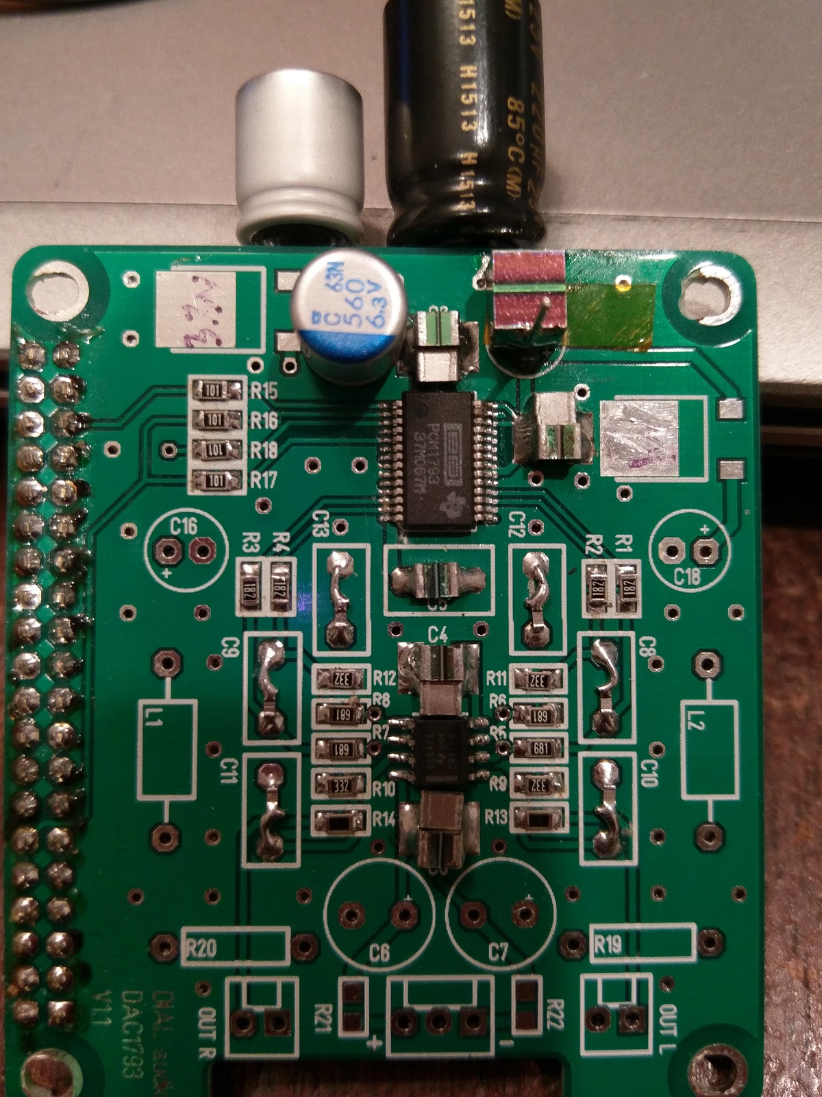

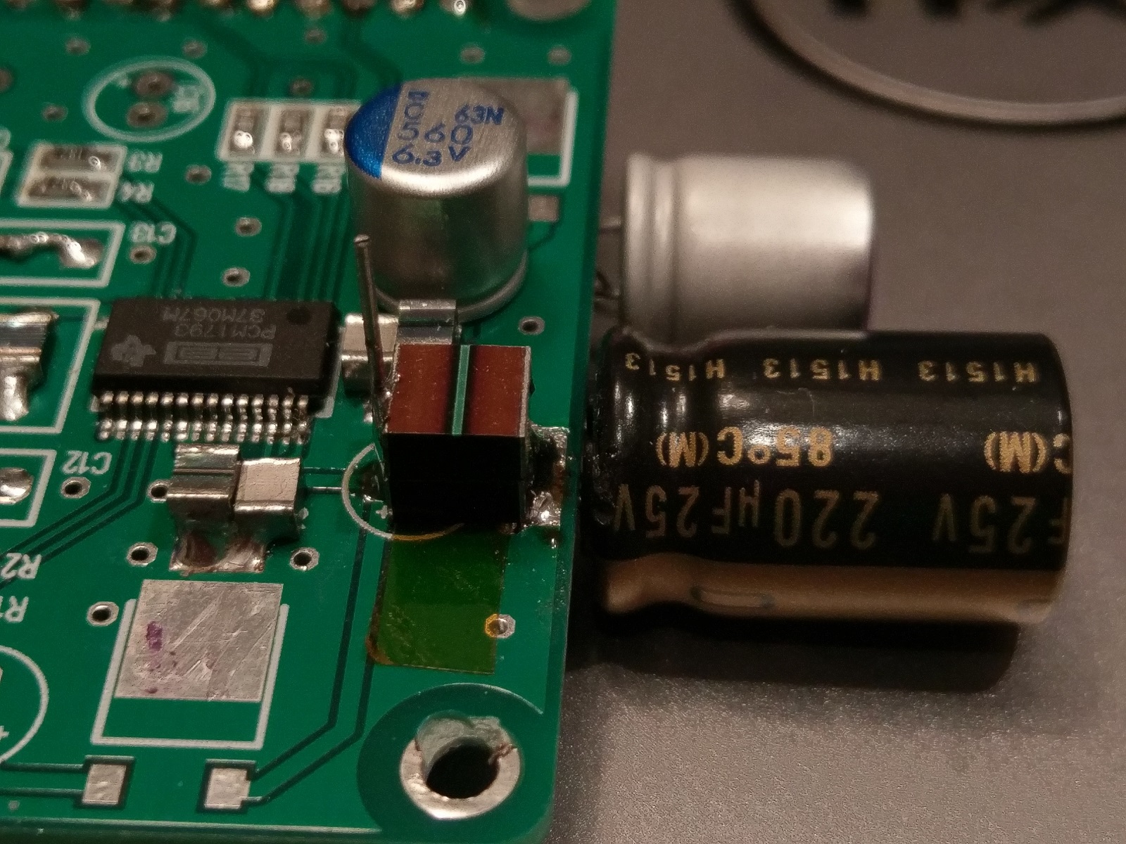

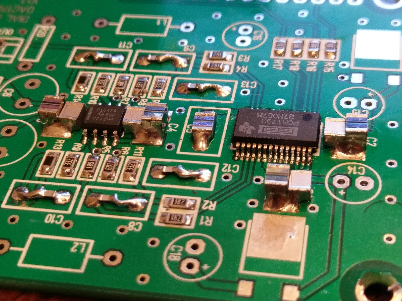

But even before I setup and listened to the stock Dial DAC I liked what I saw. So I also got a bare board from him and did a HotRod version... what I did was:
- Powering the DAC 3.3V & 5V from higher quality (IMHO) regulators with each being fed from a separate rail instead of being fed from the +15v
- Upgraded to PPS caps from mylar for the DAC and output rail bypasses
- Used 3 22uF PPS caps on the 5V DAC rail instead of a 47uf Nichicon Fine Gold (this will get upgraded with a 4th 22uF soon)
- Going to conductive polymer caps (IMHO, better for digital circuits) on the 3.3v rail again instead of a 47uf Nichicon Fine Gold
- Adding a 33F/5.5v Supercap after the regulator for both the 3.3V & 5V rails on the DAC chip
- Going to larger 220uf Nichicon Muse instead of 100uf Nichicon Fine Gold on the output stage +-15V rails
- Converting the output stage filter caps from Wima polyprops to PPS (I am planning to go back to the polyprop caps Alex uses here, I am not sure this was a good choice)
It has been running 2-3 weeks now and is currently at the top of my RPi-mounted DAC setups.
See attached pix of the HotRod build in-progress.
