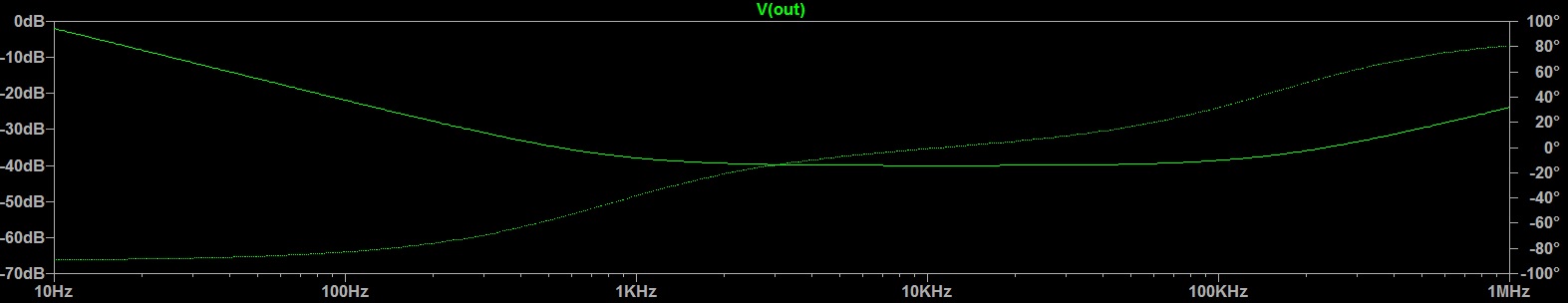

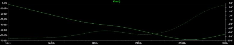

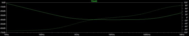

OK thanks for the tip - I used the AC analysis in LTSpice which was a new one for me. Results are in: see two frequency traces attached, one with just 2x 10mF capacitors (ESR and ESL added) and the other with the addition of a 2 microHenry inductor connecting the capacitors (with 12 mR series resistance). No bypass/parallel resistance.
As expected there is no difference below 1.5 kHz, but the attenuation in the range 10-100 kHz is quite significant. There is no sign of a gain peak at f0 as predicted. Seems good value for 80cm of bent copper (air core).

Simulation results posted on another thread:
http://www.diyaudio.com/forums/power-supplies/305589-psud-usage-questions.html#post5027432

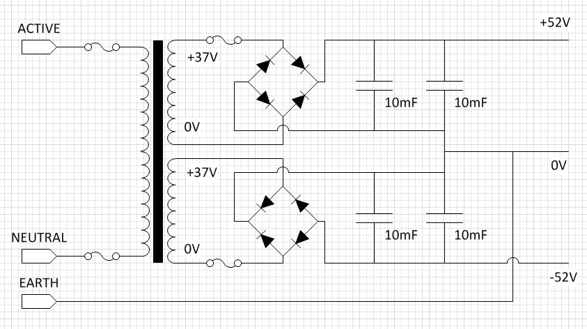

> 2x 10mF caps on each rail. ......inductor of about 1.5uH on each rail
You can rough-solve this with a stick in the dirt. (A calculator helps keep track of the decimal point.)
Being rough, I round "1.5uH" to 2uH.
freq --- 2uH ------ 10,000uFd
120Hz -- 0.0015r -- 0.14r
1KHz --- 0.012r --- 0.017r
5KHz --- 0.06r ---- 0.003r
By inspection, there will be a resonance just above 1KHz. (1.5uH and 10KuFd give 1,300Hz.)
If the resistance of the coil is greater than about 0.015 Ohms, the Q will be less than unity (low ring).
Let us "pretend" the caps have zero ESR. Real ESR will reduce Q.
DigiKey, 1.5uH, 2A-6A, thru-hole, finds 11 items with 0.008 to 0.047 Ohms.
The 38 cent part with 6,000 in stock is 0.020r, so will have Q=0.8 or so.
49 cents 4K in stock is 0.047r, Q like 0.3, no-ring for practical purpose.
10,000uFd 63V caps seem to have 0.015 to 0.050r ESR. So just one L-C will have 0.024 to 0.100 total resistance. Relative to 0.015r reactance, Q will be 0.6 to 0.15, all pretty mild.
So Q will not be a problem. But is it really attenuating the highs?
The DCRs add to the reactance (we'll blink-off the phase shift). And assume say 0.030r DCR in either coil or cap. So the real impedances are like:
120Hz -- 0.03r ---- 0.14r
1KHz --- 0.042r --- 0.05r
5KHz --- 0.09r ---- 0.03r
20KHz -- 0.36r ---- 0.03r
So small attenuation at 1KHz and not even 10dB attenuation at 5KHz, 20dB at 20KHz.
Maybe it matters. Seems small to me. For $2 the experiment may be worth trying.

rC maximimises the voltage delivered to the amplifier.
rCRC maximises the ripple attenuation and increases the Vdrop from rectifier to amplifier.
rC(L+R)C can maximise the voltage delivered to the amplifier if the R is kept small. And can attenuate the high harmonics if the L is made large.
The final C in ALL of the above is the main supply of current. The combination of this final C and the HF +MF supply rail decoupling supply ALL the current that flows to the speaker and to any correction circuits that draw transients.

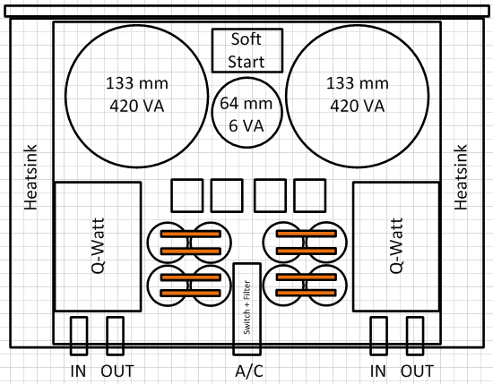

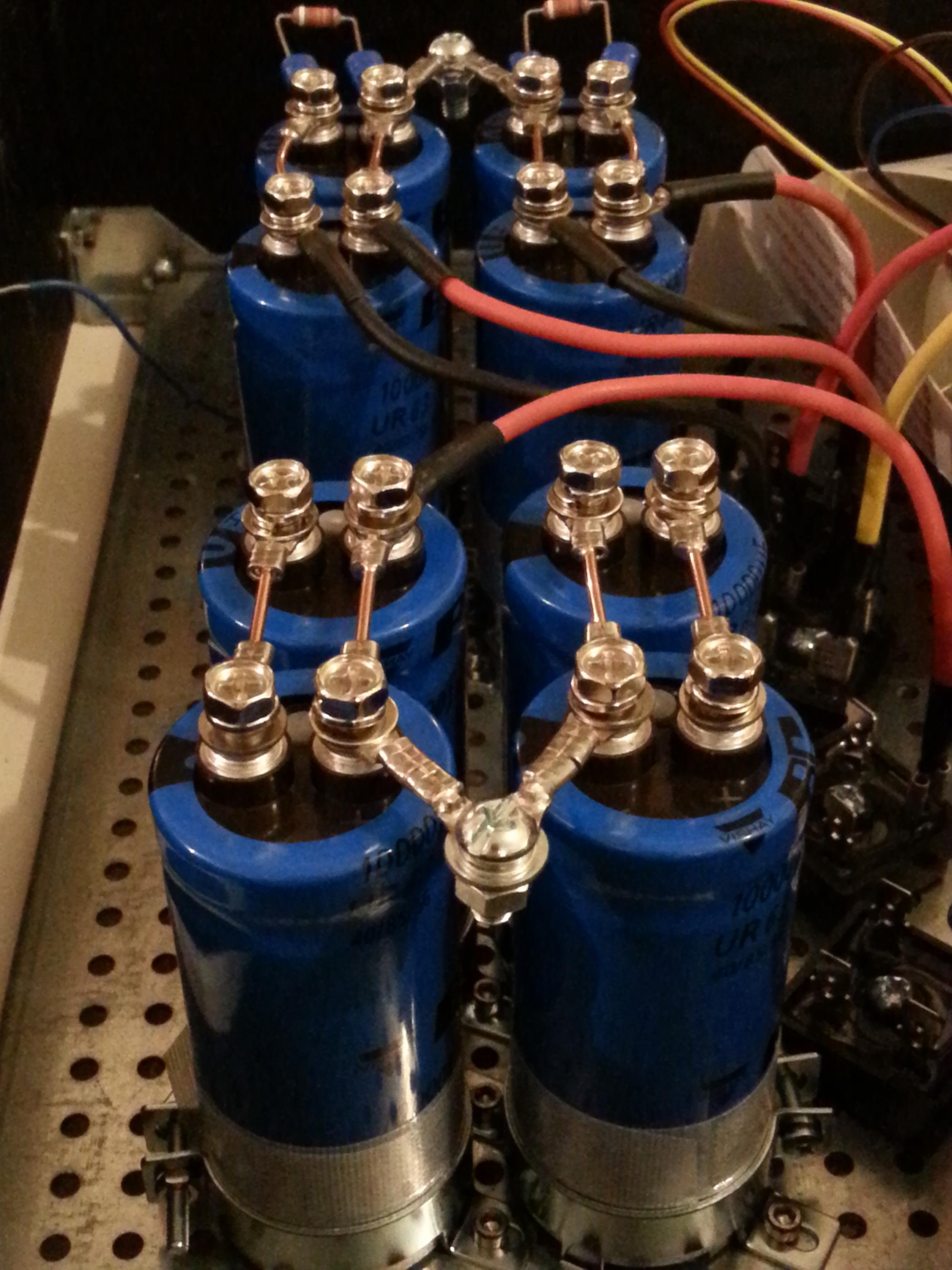

Hi trobbins. I haven't yet seen the PS output on a scope. I can do this at work in the lab - but I don't have any quantitative targets. I have not built an amp before and may never do it again. (yeah right...)popchops, the harmonic magnitudes of the current passing through the diodes will drop off rapidly from the fundamental (2x mains f). Are you happy with the level of fundamental harmonic ripply voltage that exists at the first capacitor terminals, or have some target for the second cqpacitor?
The amplifier is suitable for an unregulated power supply with decent PSRR. Obviously, less ripple is better, but my commitment in this direction will not go much beyond the investment in 4x 10 mF capacitors (for each mono channel). So at this point - I am trying to benefit from cheap 'tricks of the trade' or small improvements. I am not trying to do anything 'unconventional' from performance perspective.Would the fundamental ripple voltage cause some performance degradation of your amplifier (assuming that is your use for the power supply), or are you unsure about amplifier performance?
I have one power supply (toroidal transformer, rectifier, capacitors) for each amplifier. The soft-start circuit is common to both, on the primary side of the transformers.If it is an amplifier, then are using one power supply for two amplifiers (stereo)?
Yes - exactly. See attached.Are you using two separate power transformer secondary windings and rectifying/filtering them independently so that you can use a "quiet end" star point for the pos and neg supply grounds?
This is what I use, +-20mF per channel allows good LF extension into 8ohms speaker........ my commitment in this direction will not go much beyond the investment in 4x 10 mF capacitors (for each mono channel). So at this point - I am trying to benefit from cheap 'tricks of the trade' or small improvements.

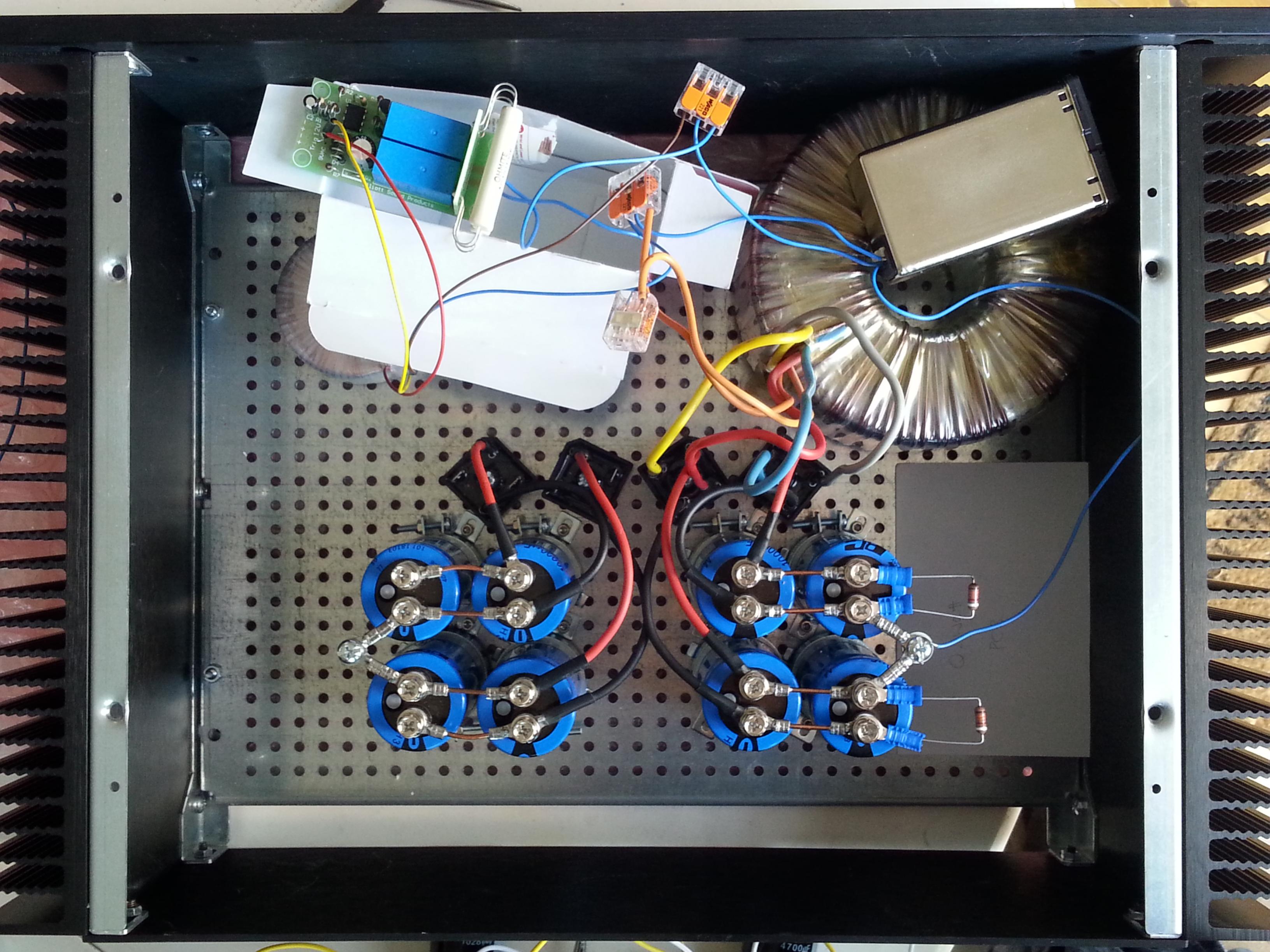

use one relay to bypass the soft start resistor, but make it a double pole version. Use two resistors, one to each transformer, then the double pole relay can switch across these resistors separately.I have one power supply (toroidal transformer, rectifier, capacitors) for each amplifier. The soft-start circuit is common to both, on the primary side of the transformers......
Have you seen my posts showing how I arrive at a suitable resistor value?
Your transformer wires look like solid core with a thin plastic tube insulator slid over. These can fatigue and break.
Replace them with a 1.5 sqmm flexible pair.
You can strip the cores from an old mains cable and just twist them together to make a good FLEXIBLE leadout about 200mm long.
These will have ~2.5milli-ohms of resistance each. If during abuse they were asked to pass 20A continuously they would each dissipate ~1W through the insulation. They would get warm, eventually. Based on this you may want to consider using a smaller gauge of flexible, 1sqmm, or even 0.75sqmm.
This extra resistance increases the resistance of the r in the rC that I mentioned a while back. It makes for a more effective filter.
Because you are building a dual mono (two channel) amplifier you may find that the Main Audio Ground to Chassis Safety connection creates extra noise from your amplifiers.
Be prepared to insert a Disconnecting Network (DN) into each Safety connection. This DN can have an optional switch to bypass the DN and make a direct connection.
Remember that the mains input Protective Earth (PE) wire MUST be permanently and directly, mechanically fixed to the Chassis.

The transformer shown was destined for scrap, it's 30 years old and 625VA. I have ordered two replacement transformers of 420 VA which are also smaller diameter. I did notice that CW (the manufacturer) fits stranded leadouts... I won't mess with Terry's wiring.
I have a couple of extra bridge rectifiers that I planned to adapt into a Disconnecting Network. Can you recommend an appropriate type of 100nF capacitor?

The more you splay the forward/return wires for any current loop, the more chance of noise egressing to your audio. General twisting of all loop wires keeps the wores close, and also minimises capacitance coupling as well.
Resistance is a simple, easy way to implement impedance for 'separating' the filter capacitors. A resistor provides defined attenuation with very little in the way of parasitics, but more attenuation means more power loss in a higher resistor value, and more heating of the electrolytic caps through conduction. One option is to buy a batch of the lowest resistance 1-3W metal films, and parallel up 5-10 or so and fit between each capacitor terminal link.
You are likely to get less rectifier-induced noise by buying a batch of UF5404, and paralleling say 3 for each bridge 'diode'. Plus have a go at tuning up a snubber for each secondary winding. And then carefully locating those devices.
No and no. If the inductor was effective at lower frequencies (which it is not) then it would reduce the AC component of the charging pulses and so reduce the ripple by a small amount. As it is it will do almost nothing; it certainly won't increase ripple.cbdb said:Won't the inductor choke the charging pulses ( which have a lot of higher freqs ) and increase your ripple?
No they won't. The inductor he is proposing is too small for that. Low order harmonics will be unchanged. Only the higher order (and thus much smaller in amplitude) harmonics will be reduced. Basically, he is splitting the charging pulse between two caps and putting nearly half of the charging current through an air-cored inductor. Fine, provided that the audio circuit is sufficiently far away to avoid magnetic induction.trobbins said:popchops, the harmonic magnitudes of the current passing through the diodes will drop off rapidly from the fundamental (2x mains f).
Good audio PSU design requires that the charging pulse loop should have as small an area as reasonably possible. This idea has the opposite effect.
The cap does not add anything to the Fault passing performance of the DN. It is there only to pass interference to the enclosure.Excellent advice - thanks.
If can be any short leaded nF cap, typically 10nF to 100nF
Similarly the resistor is only to make the "floating" audio circuits at virtually the same voltage as the enclosure. It just passes the leakage current passing from the primary to the secondary. Any value from 2r2 to 22r and low power seems to do the job.
It is in parallel with these that you can add the optional switch.
DF96, I was referring to the basic rectified half-sine periodic waveform passing the diodes, which has a reducing harmonic magnitude profile.
OK, you were saying that higher harmonics would already be small even without his inductor? Sorry for misunderstanding.
