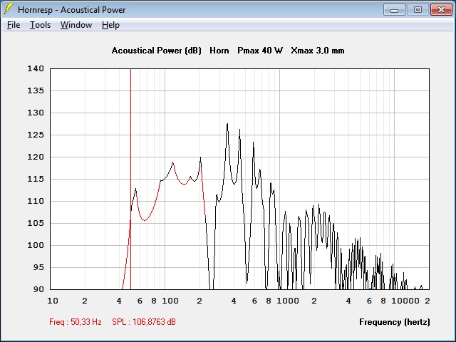

If you try to get a high power density from powerful (low Qes, High Bl, high mms) drivers like B&C 12NW100 in a tapped horn you get a very high compression or a very deep depression in the middle of the passband, like i show below:

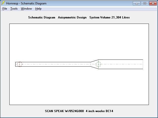

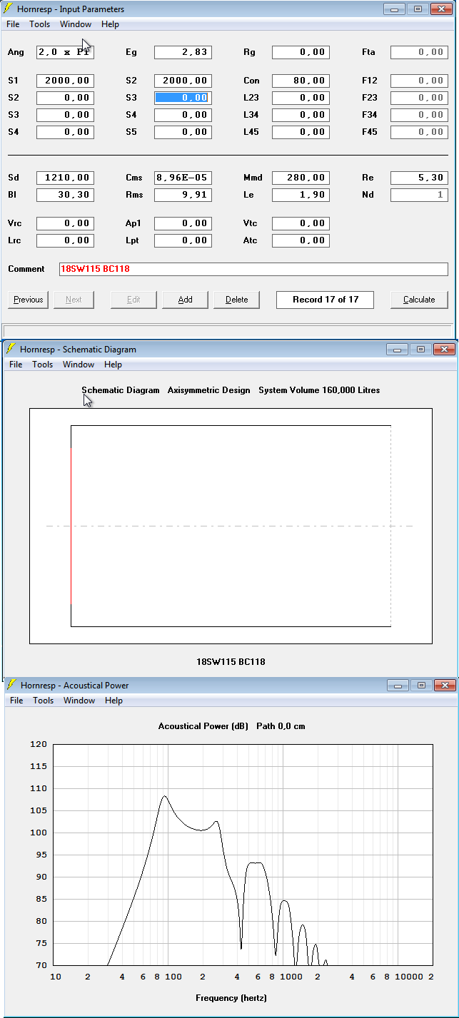

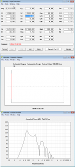

To fill that depression and get a much higher efficiency you can add a front resonator like a quarterwave bandpass design:
[image]http://oi58.tinypic.com/2eewo6e.jpg[/image]
And you get a combined output like this:
[image]http://oi61.tinypic.com/15wkvfq.jpg[/image]
The quarterwave based front resonator will increse the efficiency very dramatic, and will act like a filter, lowering distortion.
The phaserespons of this modified tapped pipe/tapped horn is very similar to the phaserespons from the BC412 and BC415.
This is not optimized and there are several more aspects of it that is not shown in the very simplified Hornresp-simms.
Johannes

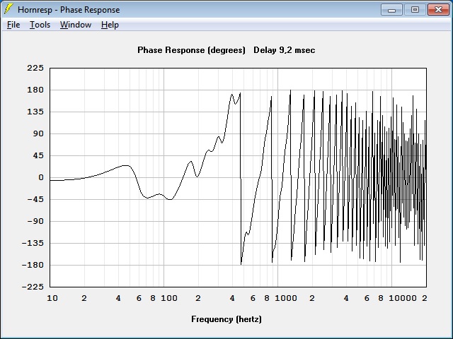

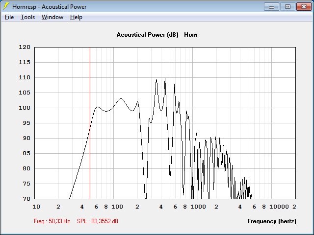

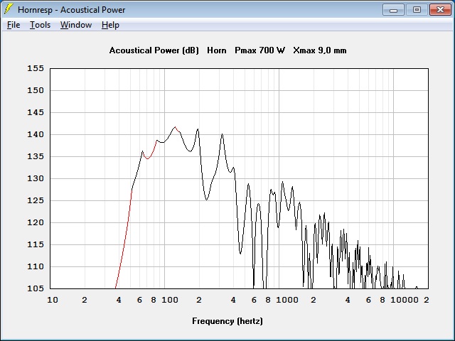

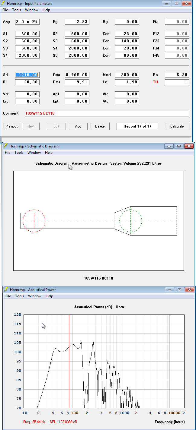

![BC210-spl.jpg BC210-spl.jpg](https://www.diyaudio.com/community/data/attachments/403/403215-9b288602dbfd6674517a82aa75ca36be.jpg)
![BC210-phase.jpg BC210-phase.jpg](https://www.diyaudio.com/community/data/attachments/403/403221-2dcc3c38f2586a1ce03b7da0f7a59512.jpg)
![BC210-maxspl.jpg BC210-maxspl.jpg](https://www.diyaudio.com/community/data/attachments/403/403224-310ad905b70fafc038bdca2b65b07fb4.jpg)
Here is three Hornresp pictures.
Please compare both phase and spl with his BC-415. Very similar.
The max spl is pretty impressive for two 10 inch Faital Pro 10HP1020 in an single enclosure, 2 pi. No tapped horn with a single 12 or two 10 inch drivers i have ever simmed or built can deliver this kind of spl with the pronounced peak around 90 Hz and this extreme efficiency.
Johannes

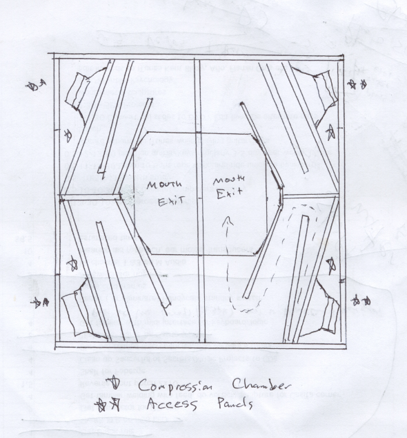

Hi Circlomanen,
You may well have an interesting idea.
Google the the patent: US 2004/0238268 A1. Weltersys had a suggestion for the inside of the BC415.
A quick estimate of the path length using this fold scheme yields a 2.08m distance which is only good for 80Hz. I think there needs to be more folds to it because the response curve has a knee at 36Hz.
