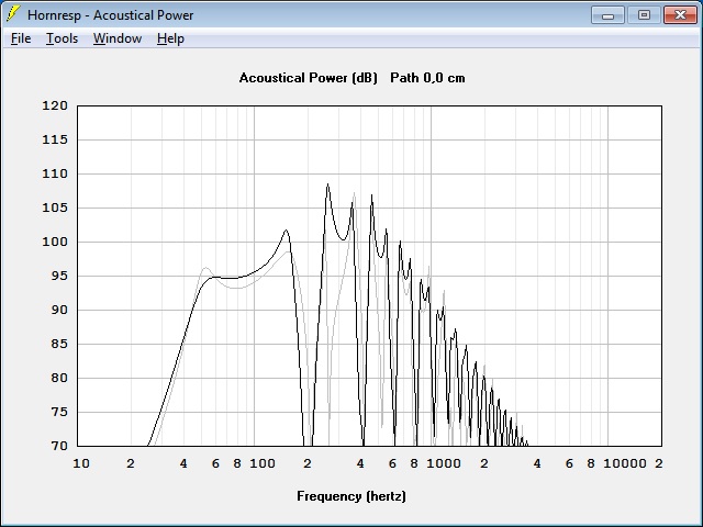

the SPL on Danley's box was 114dB at 2.83v and this one is 105dB
I think he meassures with all the drivers parallel with a total driver load of 2 ohm. If i wired them in parallel in hornresp i get 113,6 dB/2,83v/m efficiency to.
What might get Circlomanen's FLH even closer would be to add segments 3 and 4 to reflect the front face of the enclosure, but it doesn't seem to make much of a difference when I tried it
It is easier to just simm them in 1 pi instead. Not correct in the lower region of the passband, but much more correct above 50 Hz or soo.

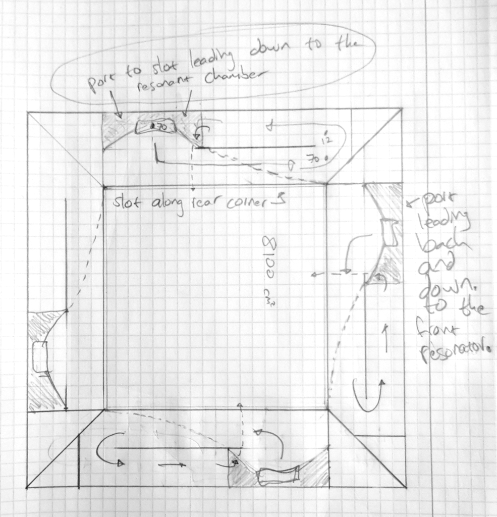

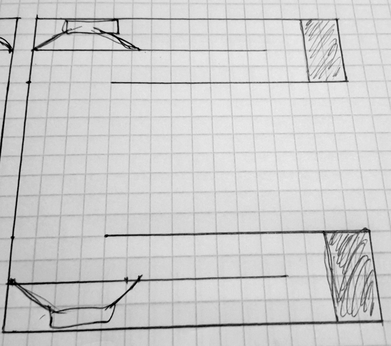

![BC415-layout.png BC415-layout.png](https://www.diyaudio.com/community/data/attachments/405/405279-34420a152a0f7acc9c4692c4da89bb74.jpg)
This is how i would build the box if i had some large sheets of plywood and 4 B&C 15SW115 lying around.
This is just a guess. I am sure Danley has all kinds of differnt refinements, and a much more elaborate tuning. I don't believe he uses straight pipes like i do, but i belive this is the genral principle behind his new BC-horns.
Johannes

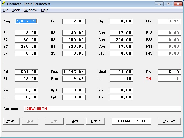

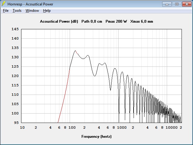

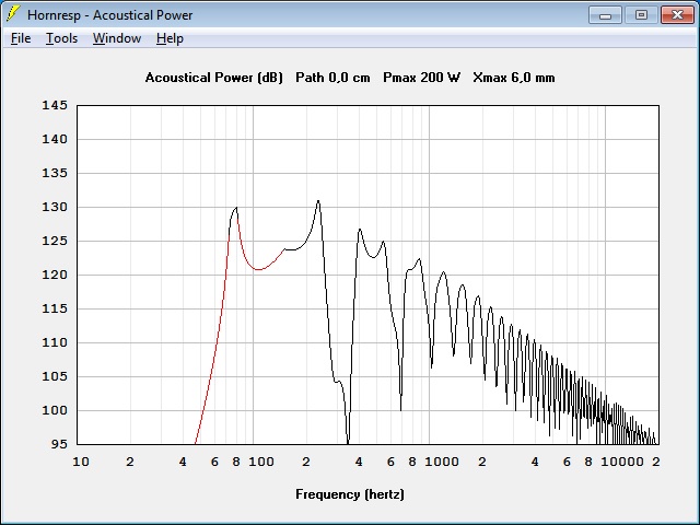

I want to "Out-THAM15" the THAM15 with a smaller box, without going to extremes in power and driver cost. Using two B&C 21IPAL in a small closed box with many kilowatts of power is not very cost efficient, especially so for the DIY comunity.
I think this is a good example of what acan be accomplished with this variation of the tapped horn.
I want to call it THDB12. I don´t have any plans yet, but i could probably draw something if there is some interest. I don´t like CAD, since i have a hard time trying to learn it..

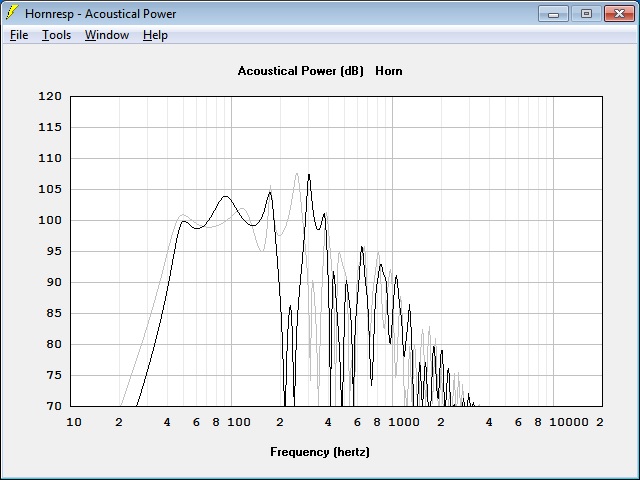

As can be seen, my THDB12 has 2,6 dB more maximum output at 80 Hz. It has a similar overall efficiency, with small variations. It lacks a dB spl-capacity below 60 Hz, but will play 2,6 - 4 dB above 70 Hz. The region between 70 and 120 Hz is very important, as a very substantial amount of the energy in music is centered there. A lack of energy in this region will make the horn sound dull. The exact opposite to what people say about the DSL BC412/415.
This is a smaller box (130,6 L) with a B&C 12NW100 compared to a larger box (167 L) with a B&C 15TBX100.
I have never heard this kind of box yet, so it is only theoretical at the moment. I believe it will sound fantastic with an enormous "kick" and attack, but i don´t know for sure.
Johannes

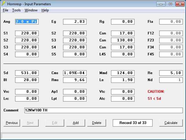

![THDB12-data.jpg THDB12-data.jpg](https://www.diyaudio.com/community/data/attachments/405/405715-4239b7e2c78b950e8a69ebc571b25475.jpg)

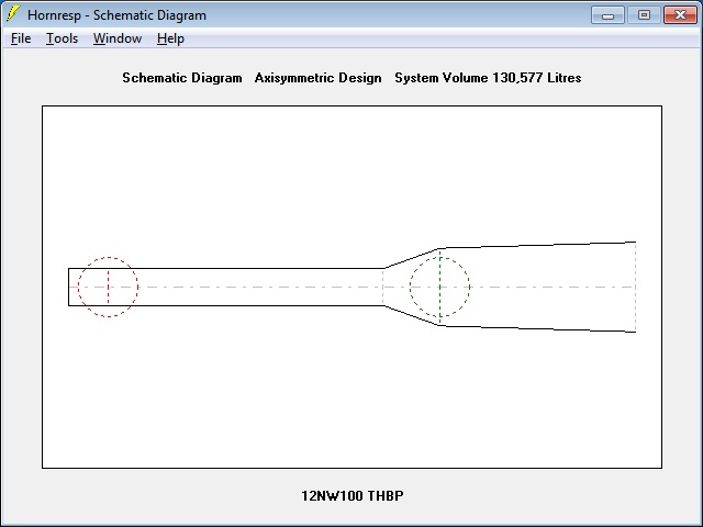

![THDB12-size.jpg THDB12-size.jpg](https://www.diyaudio.com/community/data/attachments/405/405719-368e4fff1d4a076164fcbedaea4522c8.jpg)

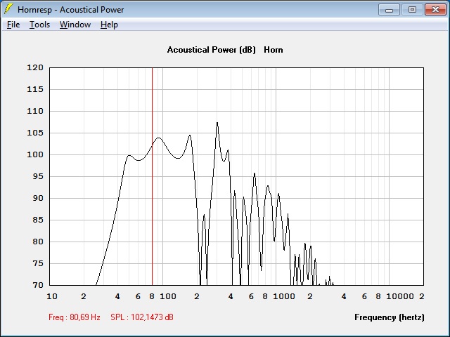

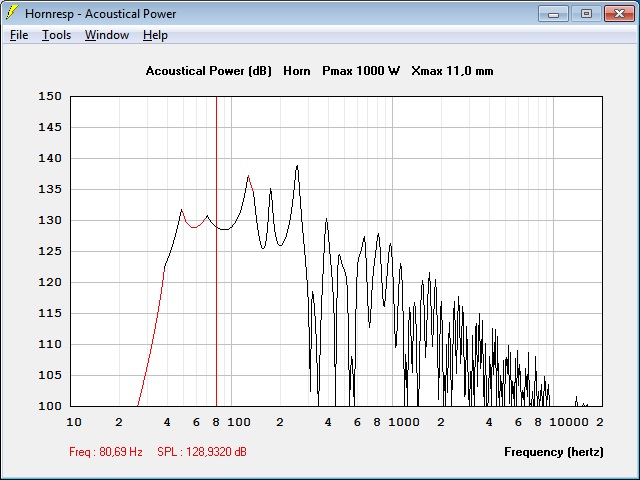

![THDB12-spl-80Hz.jpg THDB12-spl-80Hz.jpg](https://www.diyaudio.com/community/data/attachments/405/405723-ed087762c5d99d4f8089b9727d0eb610.jpg)
![THAM15-maxspl-80Hz.jpg THAM15-maxspl-80Hz.jpg](https://www.diyaudio.com/community/data/attachments/405/405728-b967cd5ec896e2a9fb84347d37038746.jpg)
![THDB12-spl-vs-THAM15.jpg THDB12-spl-vs-THAM15.jpg](https://www.diyaudio.com/community/data/attachments/405/405729-1c33298df1748f7fe88e7667f40dc440.jpg)
Johannes

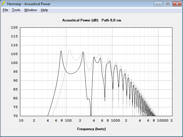

The spl charts below is a 60 liter, one meter long QW pipe (not tapped) and an one meter long hyperbolic horn (not tapped) with 1788 cm2 mouth. Both 60 liters.
This is part of why i can get more spl and the same low cut of with a 12 inch 10 mm xmax driver in a smaller box, compared with THAM15, with a 15 inch driver with 11 mm xmax in a larger box.
Johannes

I think a tapped horn has higher SPL per unit power than a plain 1/4-wave resonator that is not a horn. If you also consider a broad flat response, the FLH is probably better than a TH
Hornresp seems to contradict your statement (see simulated comparison above in prevous post, between QW pipe - non expanding - and an expanding horn).
I try to stick to verifiable facts as much as possible. I have hard time building 20 boxes a day to measure and verify Hornresp to within a dB or so. Hornresp is at least consistent enough in any deviation from reality, that i can ignore these deviations for these simple comparisons.
Yes, the horn has a broad flat response compared to a straight non expanding quarterwave resonator. I define a quarter wave pipe as a non expanding (with 1% or so), straight pipe, anything expanding is a horn, even though it might be compromized in size.
The pure non expanding quarter-wave resonator will have a deeper response with more spl, compared to a horn of the same size (once again see the hornresp simulations i provided above). Instead of contradicting me based on "think" and "believe", please show me with a Hornresp/Akabak sim (like i try to do for everything i claim).
It is much easier to have a meaningful discussion that leads to a greater understanding and hopefully a development if there is at least some reapetable verifiable facts like a Hornresp simulation. It would be best to build and measure everything, but since no one wants to build a lot of boxes each day for a simple discussion, we should settle for a acceptable level of accuracy - Hornresp or Akabak..
Johannes

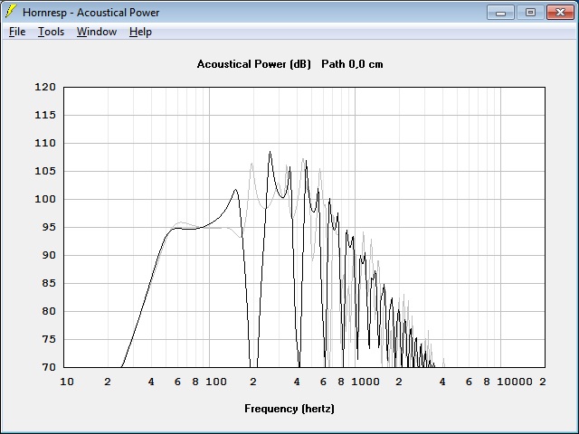

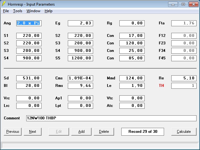

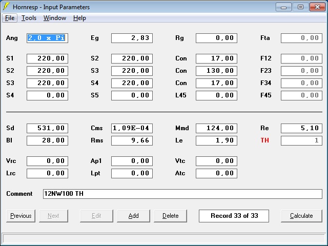

![EXPANDING-TH-data.jpg EXPANDING-TH-data.jpg](https://www.diyaudio.com/community/data/attachments/407/407505-25095f579d5a519459e26782d4b7b201.jpg)
![TP-data (1).jpg TP-data (1).jpg](https://www.diyaudio.com/community/data/attachments/407/407506-dcd066c469ce4f4d79c5cc9e71a46152.jpg)
![QW-data.jpg QW-data.jpg](https://www.diyaudio.com/community/data/attachments/407/407509-d0374a218506fdc7801b4996642bb671.jpg)
![QW-vs-TH.jpg QW-vs-TH.jpg](https://www.diyaudio.com/community/data/attachments/407/407516-776e143f64902d1dab83aca119266a38.jpg)
Quarter wave vs Tapped Horn
![QW-vs-TP.jpg QW-vs-TP.jpg](https://www.diyaudio.com/community/data/attachments/407/407519-01fa952fbff7aef6123751bed12b64ad.jpg)
Quarterwave vs Tapped Pipe (non expanding tapped horn)
I made some simulations. I tried to keep the total volume the same, but the expanding tapped horn got 0,7 liters more. Same driver (B&C12NW100) same power and same width of the passband (within reason). I tried to keep the lower corner as close as possible, and no extreme high Q peaks...
I can´t say it is a clear cut win for the expanding TH, especially considering the extreme compression i had to use to get the size down to the same 36 liters.
Johannes
