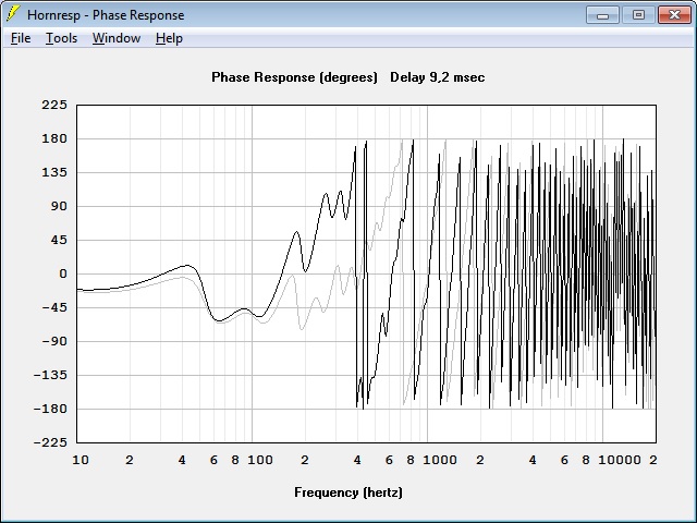

A comparison of the phase-response from the THBP (black line) and the FLH from Just a guy.
If this is the real phase-response then i think it is safe to rule out FLH as a contender for the BC415.
If this is the real phase-response then i think it is safe to rule out FLH as a contender for the BC415...

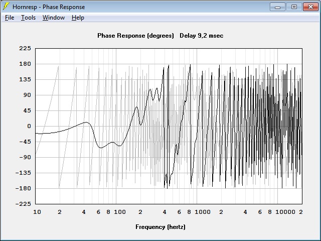

Here is the right picture.
It's the right picture but it's the wrong phase. Notice Hornresp automatically sets the delay at 81 ms for the flh (not sure why but it's clearly not right) and 9.2 ms (or something) for the other design (which is much more reasonable based on path length).
If the response curve is the same and the path length (delay) is the same, the phase will be the same. Adjust the delay manually and see for yourself.
Don't rule out flh as a possiblility for the BC subs yet.

I'm not sure if you missed my point or not. I wasn't trying to make a great design, I was trying to copy what you had as exactly as possible with different alignments, this required a bit of compression in some alignments. The compression is clearly too high but that's not the point. Compression can be lowered, the design can be changed to have the same amount of bass but a different response curve shape. (My first example shows this, the simple tapped horn has same compression ratio as your design, they put out the same amount of bass but the response curve shape is different, IMO better, with the simple tapped horn.)
My point was that given the same size, no alignment is a clear winner, they all put out the same amount of bass.
Your original design is undersized (smaller than optimum), that forced some compromise in my examples, like high compression.

In AkAbak you can set the size of the baffle, and set the location of the radiator within the baffle as well as its area. The baffle edge diffraction effects are accounted for so you do not need to use a separate program. In addition to this the location of the nearby walls like floor or ceiling or back wall also play a part in the bass extension due to modifying the PI steradian angle of output. It is not simply 1, or 2 PI but actually calculated based on distance from boundaries. It will be interesting to see what a 60x60 in baffle does to a sub output in 4pi space.
The horns will always be more efficient than straight boxes but it's not because of the alignment, it due to the fact that the horn will be much larger. It needs to be larger to get the same low knee as the straight tl.
Doesn't matter, the TH mouth side tap isn't doing much of anything either except filling in a dip that occurs naturally in transmission lines, as I showed. (Actually in both cases both sides of the driver are doing something very significant, half the flh energy is not just wasted heating the sealed box (it's working on annulling the reactance so the flh is tuned right), and the mouth side tap in a tapped horn is not adding 3 db - it's doing something important, but it's not adding any sensitivity or efficiency.)
Sealed isn't a resonant enclosure so it doesn't apply to this conversation. FLH does apply because it's got a huge resonator (flare) hanging off one end of it. Sealed vs ported is not an appropriate comparison, ported vs 4th order bandpass is a much more valid comparison, except in most cases the front chamber of a 4th order bandpass is specifically used as a filter to intentionally introduce losses.
All transmission lines have two output sources, the direct driver radiation and the output from the mouth. The only difference between Graph 1 and Graph 2 in post 88 is I changed TH (tapped horn) to Od (offset driver where the driver is in the same spot as the throat side tap but on the outside wall of the box, like any normal tl). There is no tl where both sides of the driver are not used, otherwise it wouldn't be a tl.
I already did that in post 79, same size box and sensitivity is almost identical. It's an unusual stepped tapped horn but it's a tapped horn. And my matching flh has a high compression ratio but it's valid to show that max potential sensitivity is restricted by size (not alignment), and liter for liter the alignments perform ~ the same. But if you want to choose another tapped horn design I can match it with a FLH and show you again. If the design you choose is quite undersized I might need a high compression ratio and possibly an odd flare shape to match your sensitivity and response curve shape but I can do it. Sensitivity and response curve shape will be the same.
Ok you have convinced me. Sensitivity of a TH is not better than another alignment given same volume.
