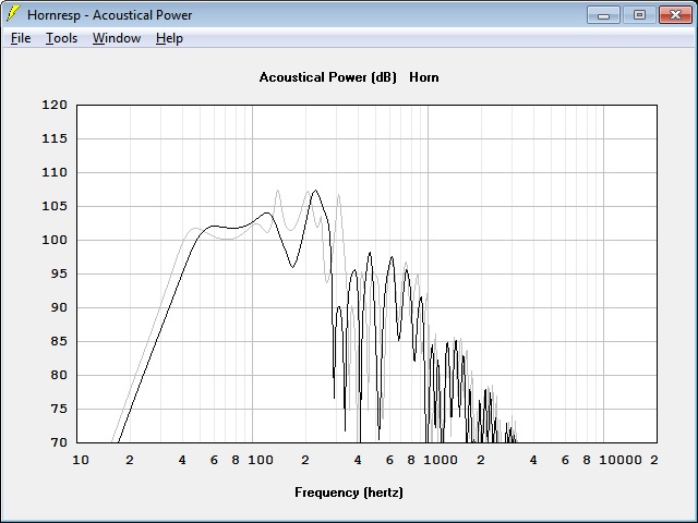

Here is the Hornresp simulation comparing the THAM18 (266 liter) with a B&C18TBX100 with a TH18 (313 liter) from earlier in this thread with a 18SOUND 18LW2400 driver.
The THAM18 has measured response down to 38 Hz in 2 pi, and we read about someone claiming deep response into the low 20s cornerloaded in a living room.

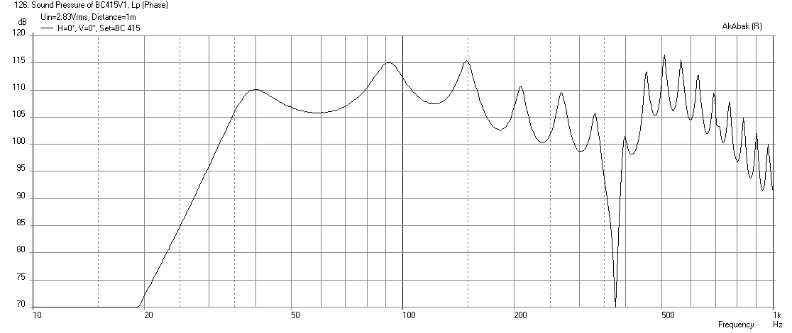

So here is what the Akabak sim gives as first cut at 1m and 2.83v wired 4 parallel:

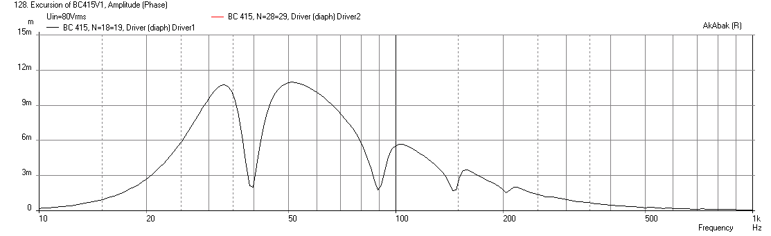

Here is cone displacement at 80v to reach 11mm xmax (another question is if xmax is listed as 9mm why are you using 11mm?). I am using -24dB BW high pass filter at 35Hz as prescribed by spec sheet:

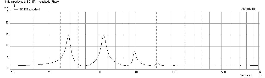

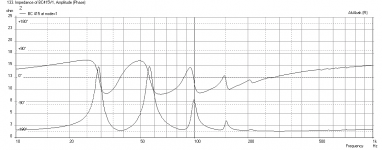

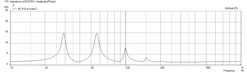

And here is the predicted impedance:
![445920d1414665964-danley-bc-subs-reverse-engineered-bc415-impedance-v1.png](https://www.diyaudio.com/forums/attachments/subwoofers/445920d1414665964-danley-bc-subs-reverse-engineered-bc415-impedance-v1.png)

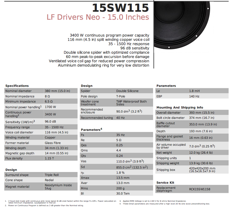

Considering the 6800 watt continuous power rating, the 15SW115 is the only 15 inch driver that i know of capable of 1700 watt (6800/4).
9 mm is a theoretical number based on length of the voice coil etc... 11 mm is the measured xmax (xvar) at 10% distortion. I believe more in measurements then theoretical calculations... I wish everyone would settle on "xvar"...

I like you simulations xrk971! Great job.
Do you have a phase simulation?
Johannes

So maybe I should sim with B&C 15SW115? I like the measured xmax too, never heard of it called xvar though. Good to know now.

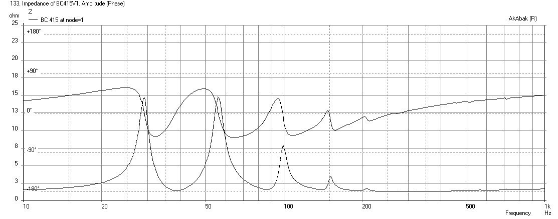

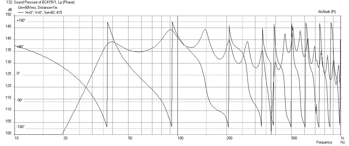

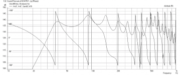

I am not sure which phase is being shown in spec sheet. Acoustic phase in mic measurement or impedance phase?
Here is Acoustic Phase:
![445926d1414669500-danley-bc-subs-reverse-engineered-bc415-freq-1m-max-splv1-phase.png](https://www.diyaudio.com/forums/attachments/subwoofers/445926d1414669500-danley-bc-subs-reverse-engineered-bc415-freq-1m-max-splv1-phase.png)
Impedance Phase:
![445927d1414669500-danley-bc-subs-reverse-engineered-bc415-impedance-v1-phase.png](https://www.diyaudio.com/forums/attachments/subwoofers/445927d1414669500-danley-bc-subs-reverse-engineered-bc415-impedance-v1-phase.png)

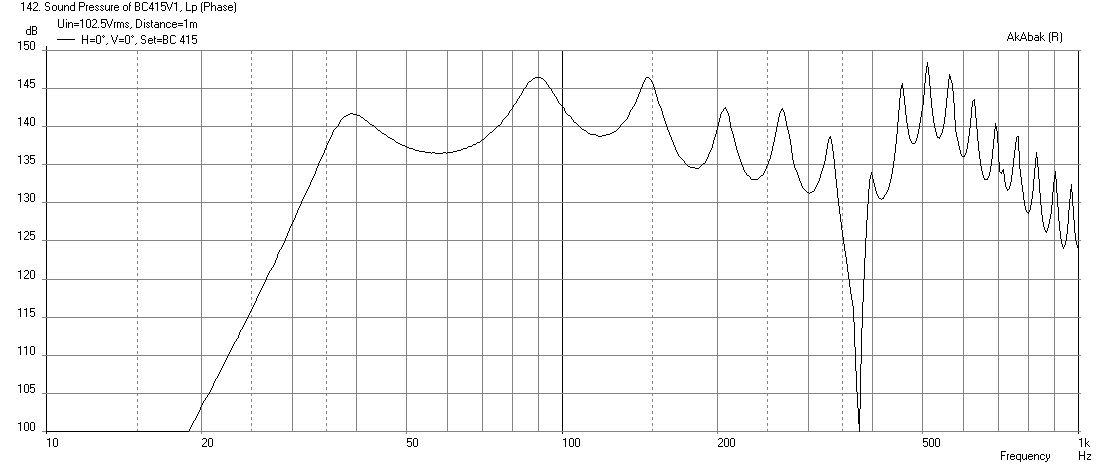

Here is the same speaker with the new 15SW115 driver - max SPL is now 142dB at 102.5 volts! to reach 13.5mm xmax:
![445932d1414670317-danley-bc-subs-reverse-engineered-bc415-freq-1m-max-splv1-15sw115.png](https://www.diyaudio.com/forums/attachments/subwoofers/445932d1414670317-danley-bc-subs-reverse-engineered-bc415-freq-1m-max-splv1-15sw115.png)
Peak power into system is 6.43kW at 87Hz or 1608 watts a piece. That is some serious heat - you could cook hotdogs with the heat coming out the back vent on the magnet

1) The B&C 15SW115 is a good guess, DSL uses the driver AES power specs for their specs, for instance the TH-118 still has the higher power rating of the 18Sound 18" driver pictured on the spec sheet even though they have long since switched to the BC18SW115-4. The BC18SW115-4 has a higher 16mmXvar (where magnet strength is falling by 20% IIRC the Xvar definition) than it's Xmax of 14mm, it produces little distortion at Xvar.1)So maybe I should sim with B&C 15SW115? I like the measured xmax too, never heard of it called xvar though.

3)Here is the same speaker with the new 15SW115 driver - max SPL is now 142dB at 102.5 volts! to reach 13.5mm xmax:
4)Peak power into system is 6.43kW at 87Hz or 1608 watts a piece. That is some serious heat - you could cook hotdogs with the heat coming out the back vent on the magnet![]()
2) Acoustic phase. Set your phase to the correct delay time in your sim and it will unwrap all those 360 degree turns in the LF and look similar to what the BC specs show.
3) Use the 13mm Xvar figure, in the case of the 15SW115 Xvar is slightly less than Xmax, the magnet would be running out of "push" at 13.5mm, especially with the BC loading.

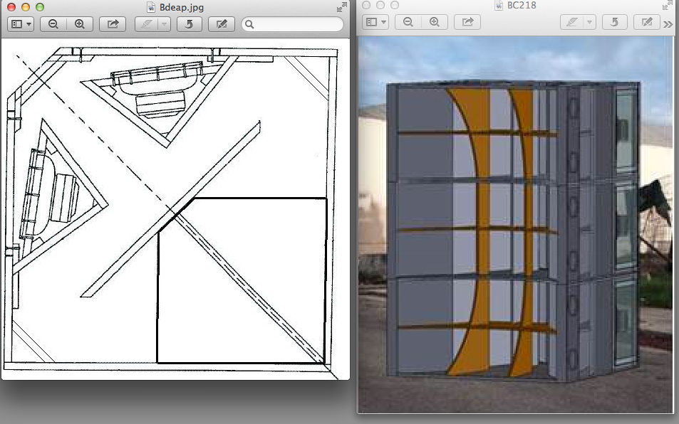

My back of the envelope drawing was based on the BDEAP (Tom's similar design for Sound Physics) prior to the later BC18 configurations pictures Ivan Beaver posted, which seem to confirm the similarity of the two designs.

Weltersys, when you say adjust phase in the sim to unwrap the phase. Do you mean see what the delay is from the IR then apply an all pass filter delay to null out the delay seen in the IR? And that will flatten the phase?

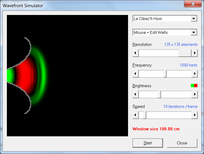

All horns have the bubble.
Our simulators (Akabak and Hornresp) are aware of the bubble, they account for the bubble in all our simulations. Always have.
I don't think the boundary in this design is adding horn length, I don't think there's anything going on that Akabak can't handle when diffraction is introduced into the model. If boundaries caused more length, mounting a driver flush in a wall would add more horn length. It doesn't, although it may look similar to the effect of adding horn length. All it's doing is providing a boundary. The effect of that is diffraction. If we were to flush mount a horn mouth into a floor/wall junction of a very large wall (larger than the lowest frequency played through the horn), we would set our Ang to 1 pi (which effectively gives the diffraction profile of a very large floor/wall boundary) and trust the software to figure out the bubble math, and the sim would be accurate. For smaller boundaries like this a more flexible diffraction simulation is required, like what you are doing. I'm not sure why we suddenly don't trust our software to calculate the bubble.
I just checked out the spec sheet for the sub in question and your sim is remarkably close considering no one really knows the internal dimensions or driver used. There are a couple of tweaks you could make to the sim to make it look more like the spec sheet measurement before assuming the bubble is adding horn length in ways that it doesn't with all the other designs we see daily.
TD designed it so the frontal area and bubble area were equal. That doesn't mean we can't simulate the cab with our existing software or that the horn is operating in some strange new way. I'll be pretty surprised if someone can prove there's anything more than diffraction happening.
Just to clarify - AkAbak uses the standard Webster plane wavefront model and does not take the "bubble" into account. The Hornresp isophase wavefront model does.
