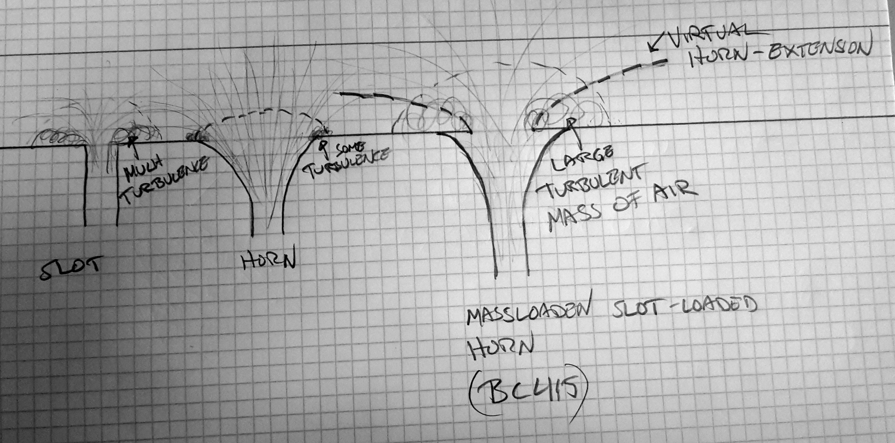

Every kind of openening exiting a flat surface will have some kind of bubble. The size of the bubble is dependent on the crosssection area of the horn.
The difference is how you modify and create this boundary effect, to either maximize it or make it smaller. Compare with the waterflow around a hull. A blunt shipping container being pulled through the water will create a huge wave from the large flat front. The same amounta and weight of steel shaped like long slender hull will barle make a visiable wake at the same speed.

A large wall boundary around a sharp edged orifice (like the BC415) will produce what is called a "sudden expansion" flow in fluid mechanics. This type of flow is characterized by a large vortical recirculation donut around the jet exiting the orifice. The sudden expansion flow expands rapidly vs a straight walled jet into a boundary-less free space where the jet flow entrains (pulls) the surrounding flow as it exits and is narrower and goes farther before spreading due to normal viscous dissipation associated with boundary layer formed between the jet flow and quiescent air around the jet.
Acoustically, I think the sudden expansion will have lower frequency resonances associated with the larger scale vortex. The flow expands at a faster rate and in all cases with higher SPL's will likely be turbulent. In which case, neither the HR or AkAbak models which are solving a simplified wave equation rather than the full time dependent viscous Navier-Stokes equations, can capture. So I think as TD says, some manual "correction" factors will need to be applied. However, if one were to use a 3d time dependent flow solver (like what is used for aerospace flows in rocket nozzles), the simulation just will not capture all the nuances. Given that AkAbak is a 1d lumped element model, it does a surprisingly good job to get us "almost" there to the solution.

The sharp edge at the mouth will "trip" the flow near the edge and create the vortical recirculation donut , but the air closer to the center of the port will flow more laminar or straight. The vortical recirculation donut will shape the wave like an extended horn-section outside of the box, effectively create an larger horn then the box itself.
If the mouth did not have that sharp constriction edge creating the vortical recirculation donut, the horn would have the normal 60% of horn-mouth diameter bubble. Of course the horn has to have an expansion-rate that "sees" the outside vortical recirculation donut as a continuation of the horn.

This is a nice theory, a horn flare built literally out of (vortexes of) air.
