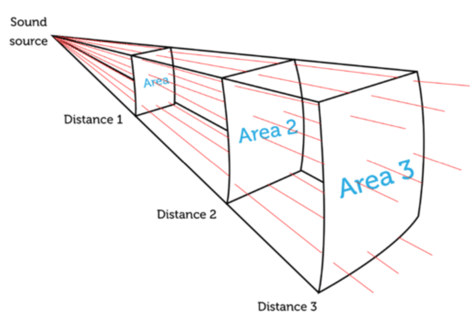

"As sound waves travel farther from their source, the more spread out their energy becomes. You can see how this works in the Figure below. As distance from the sound source increases, the area covered by the sound waves increases. The same amount of energy is spread over a greater area, so the intensity and loudness of the sound is less. This explains why even loud sounds fade away as you move farther from the source."
CK12-Foundation
What am I missing?
