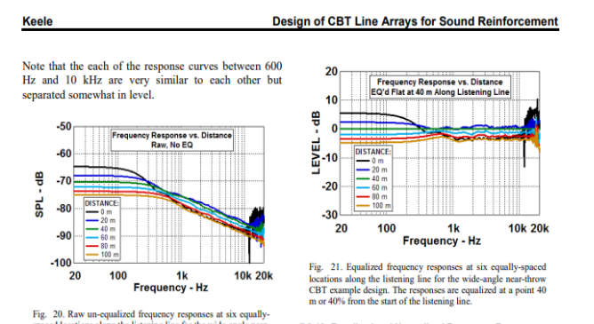

I do know that audio, once in the far field, falls at 6dB per distance doubling regardless of pattern. (and ignoring air temp, humidity... effects on high frequencies etc,)
Far field is a bit important. Go back to Juhazi's chart in #24.
The line between near field and far field is marked by when SPL starts obeying inverse square law.
Inside that near field distance, closer to the speaker, drivers are acting a bit independently, and SPL may fall slower than 6dB per octave.
An old rule of thumb is that multi-way measurements need to be taken no closer than 3X the longest baffle dimension. IOW, nearfield multi-way measurements are a no-no.

Point Sources
The SPL from an ideal point source radiator falls at the rate of 6 dB per doubling of distance. The Intensity of sound from the point source falls off as the inverse square of the distance. This is known as the inverse square law. The energy radiated from the point source is evenly distributed over the surface of an expanding sphere. The surface area of the sphere is inversely proportional to the distance (radius of the sphere) squared.
Infinite Line Sources
The SPL from an infinitely long line source falls off at a rate of 3 dB per doubling of distance. This is because the energy distribution is now over the surface of a cylinder, rather than a sphere as in the case of the point source. Because the surface area of the expanding cylinder is inversely proportional to distance, NOT distance squared, it follows that the energy density falls simply with distance from the source, rather than distance squared.
Now, I do think it's a little weird why that strange magic would apply only to line source control patterns but not horn control patterns. Nevertheless, I'd never expect the great ones deign to explain it.
It's not strange magic, the important information is that bolded in your quote above. An ideal line source produces a cylindrical wavefront and a horn a spherical one.
Most line sources are not ideal and therefore the -3dB with doubling of distance does not hold over all frequencies.
An example of that here Line Array Attenuation - Ideal vs Actual

Hi bradleypnw,Now, I do think it's a little weird why that strange magic would apply only to line source control patterns but not horn control patterns. Nevertheless, I'd never expect the great ones deign to explain it.
I'm only repeating and building on what's already been said in attempt to help clarify 6dB falloff vs 3dB falloff...
The relevant text from the TA article you quoted, was at its end:
"A finite line source will behave more as an infinite line when the observation point is very close to the line compared to its length. At greater distances the source looks more like a point radiator and the SPL will fall at 6 dB per doubling of distance.
A finite plane source likewise will exhibit constant SPL with distance only when the observation point is very close to the plane compared to the dimensions of the plane. At larger distances the finite plane source behaves more like a point radiator and the SPL will fall at 6 dB per doubling of distance."
This again gets to near field (very close observation point) vs far field.
Very close means just that!
So I doubt anyone is going to listen to a Summa or Hyperion close enough to be in the near field.
That "line arrays only fall at 3dB" is one of the biggest marketing myths floating. A unicorn imagined from a theoretical infinitely long straight line.
