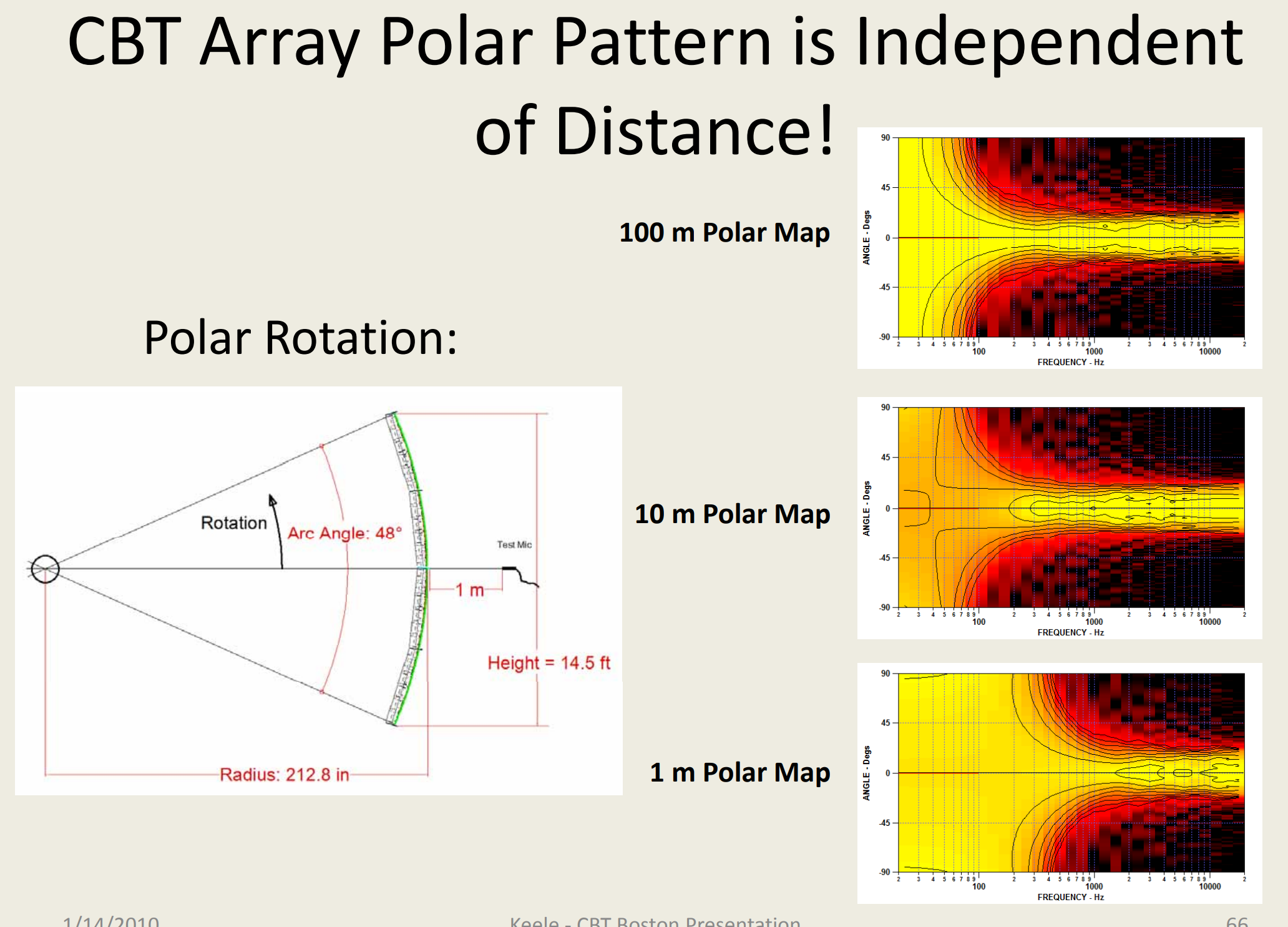

For anyone else who is interested, Floyd Toole discusses the value of reduced attenuation/distance in home theater here:
And Keele's related note:
(Note by Don Keele Oct. 2011: The CBT36 would work superbly in this application. The pair of systems should be mounted upside down on the ceiling on either side of the video room and aimed cross fired into the room. For optimum results, the ears of the listeners should be in an approximate range that extends from the bottom of the hanging array (its top) to a point two feet lower. This would effectively equalize level variations across a 10 to 15 foot wide listening room!)

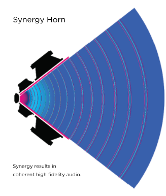

Danley doesn't show a bubble floating out the front of their horn. Does anyone else see a bubble floating out the end of their horn and subsequently radiating into a sphere in the attached image?

Here's another one of a Synergy and now it has a curve to it
That image looks like a Jericho which would have some line features due to the paraline of tweeters and other drivers funnelling into a horn with greater vertical dimensions. I doubt they thought anyone would take it as you did.Danley doesn't show a bubble floating out the front of their horn. Does anyone else see a bubble floating out the end of their horn and subsequently radiating into a sphere in the attached image?

Just look at the image posted by fluid. Both the top view and side view would show that same behavior. Does that make it more clear?

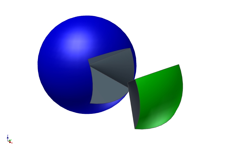

I'll show a 60 x 60 degree part of a sphere:

Hey guys, thanks for posting those. I think the misunderstanding is that shape causes attenuation rather than surface area.
wesayso's image shows surface area so it's easier to demonstrate. Cut three slices of the extracted 60 degree section and sum the surface areas. Then cut three slices of a full sphere and sum the surface areas. That tells you which surface area increases at the greater rate.
WRT attenuation over distance the shape doesn't matter the increase in surface area matters. Do you spread the energy out over a larger surface area or a smaller surface area over distance?

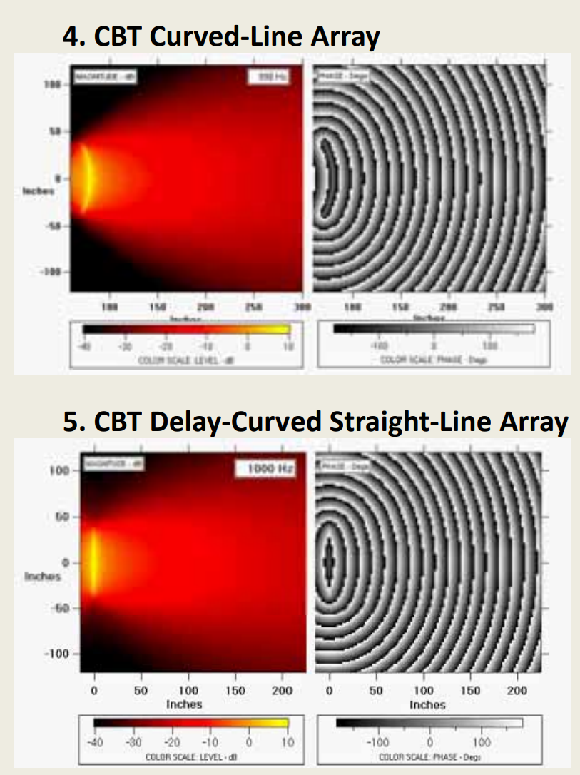

Both the physically curved and the time delayed CBTs generate the same shape. However, the monopole CBT narrows the vertical without narrowing the horizontal. Side note: one advantage with a straight DSP CBT is that you can easily adjust delay and shading to control vertical beam coverage. Anyway, you can see how the shape of Keele's CBT radiation looks similar to Fluid's image. Again, it isn't about shape it's about surface area expansion.
In previous posts, there was a question about how far an array can hold its pattern (i.e. 3dB drop-off over distance) so I included Keele's slide 66. Also, if you read through Keele's slides you can see why you don't need a floor to ceiling array in a small room.

There are many ways to get to a similar result. A floor to ceiling array generally uses a single amplifier and takes up virtually no floor space. It can be passively frequency shaded if desired too. A straight delay shaded line can approximate a CBT in the same footprint but at the cost of DSP and amplifiers. A CBT as Keele makes them takes up a lot of floor space. They are all good options and have their own benefits and trade offs.Also, if you read through Keele's slides you can see why you don't need a floor to ceiling array in a small room.
