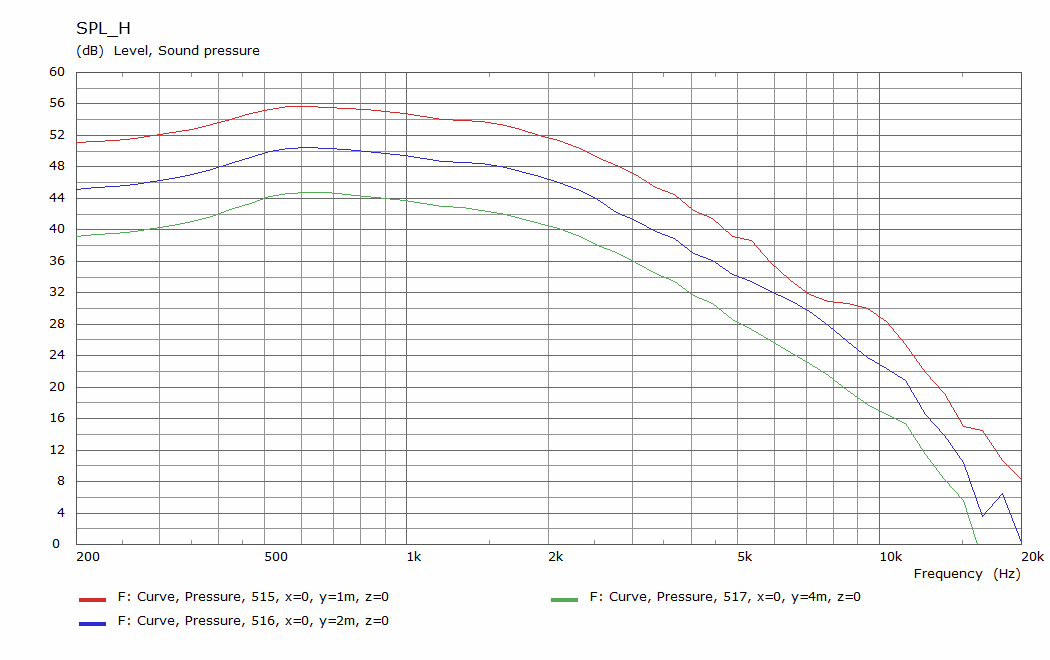

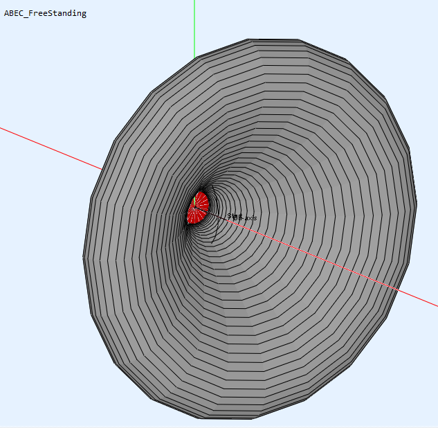

To add to the mathematical explanation above
Here is a horn in a BEM simulation with the output at 1m, 2m and 4m
attachment.php
attachment.php

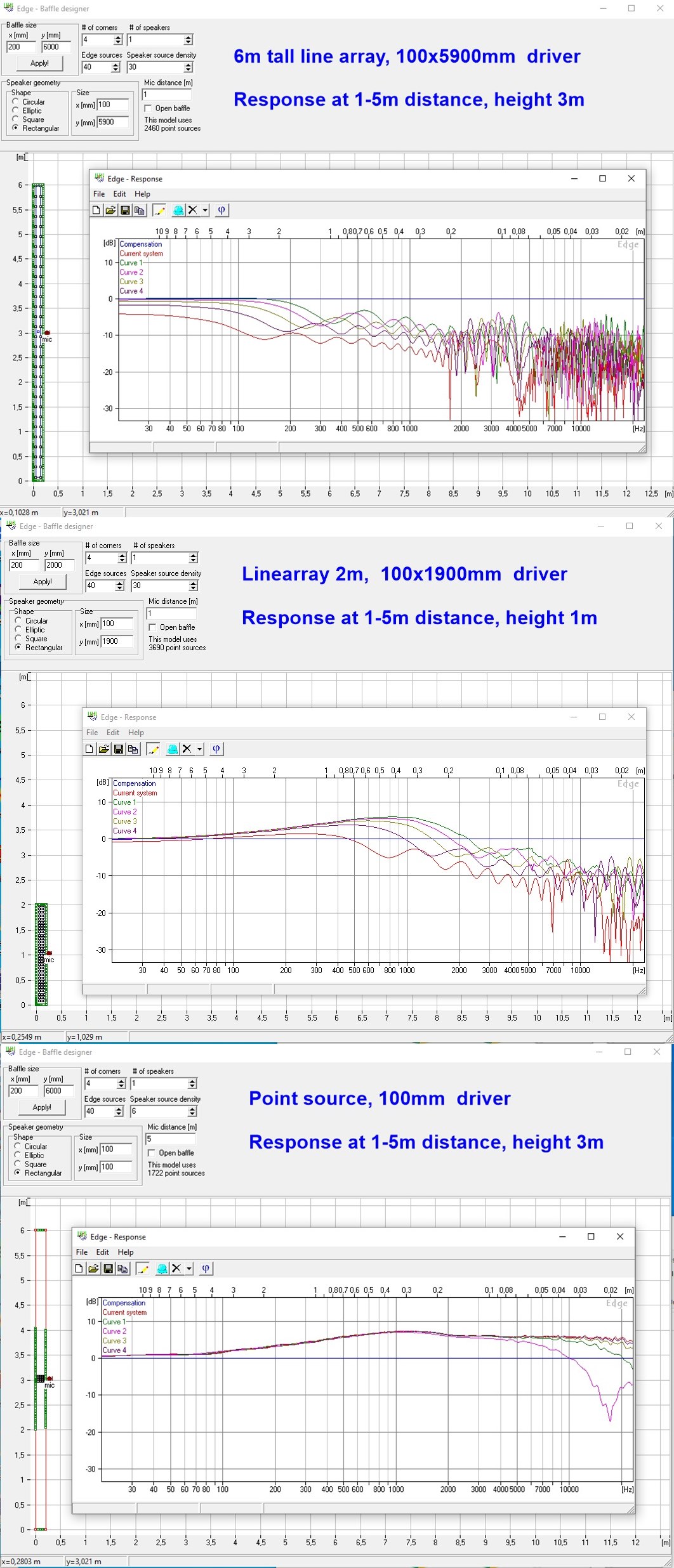

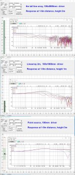

Line arrays don't radiate as tubes IRL. Distance variation will introduce diffraction variation which is also frequency-dependent.
At very long distance, air friction will tame high frequencies more than lows. This effect is not noticed at home (overruled by effect of typically narrower radiation)
The Edge simulations don't show spl drop based on mic distance, only interferences.Here 2m vs. 6m tall arrays
Jeah measurements show whats happening more easily than trying to tackle the situation with maths. Maths get complicated the moment one realizes sound isn't radiating from single point in space, or from a perfect line and then there is the environment.
