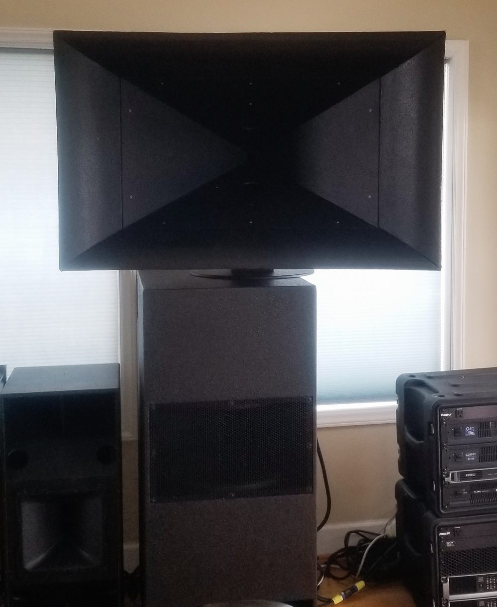

Here's a larger synergy that has horiz pattern control to 190Hz. (49"wide)
It has removable secondary flares that when off, reduce horiz pattern control to 260 Hz. (36" wide)
I can listen to it either way, quite happily.
![syn7 right.jpg syn7 right.jpg](https://www.diyaudio.com/community/data/attachments/851/851943-ebd4a2c1033474571d1edd2789d8f519.jpg)
It crosses to sub at 100Hz, which is right at 1/4WL c-2-c, on top of the PPSL sub as shown.
For seated listening, on a standard vented sub without a cavity over the driver, 1/4WL c-2-c tightens up to 160Hz.
So far, i think keeping c-2-c within 1/4WL, syn to sub, has mattered more than the mouth sizes.

Ok, trying to guess more about the Hyperion.
I'm thinking the top section is very similar to the SM-60F...both appear to have a 5" coaxial, and two 8" drivers. We can see both mid-range ports and reflex ports for the 8 inchers.
In the lower section, I love the opposed side firing 15" sub drivers. Big time vibration reduction.
I think the reason for the feet is what appears to be incorporating a downward firing reflex port.
Whether that Hyperion sub take is correct or not, i think side-firing opposed, with downward reflex port, is a great idea.
Less volume needed than my current clamshell slot loaded subs (no slot volume needed). And the box height could make make reflex port length much easier to fit in, for going lower.
Opposed firing sub drivers are simply a must imho.
