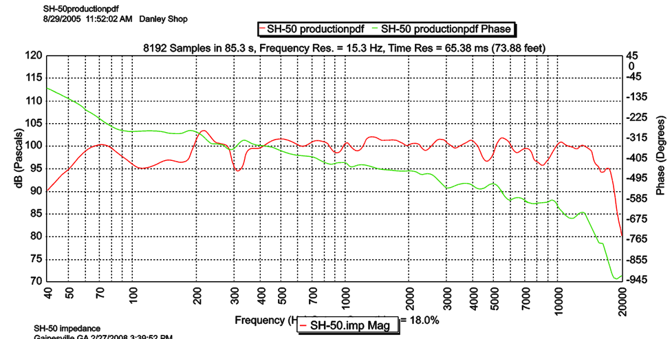

Soldermizer,
I listened to the SH-50 years ago in a well optimized and measured setup, here are my (and others) impressions:
Danley SH-50
Here is a picture of the setup and comments by the owner:
Danley SH-50

The HF "boost" is typical to achieve "flat" response using a passive crossover with a constant directivity horn/HF driver. A series capacitor is used to bypass the attenuation resistors used at the low end of the HF driver. The overall cabinet sensitivity is reduced to that of the raw sensitivity of the HF driver above around 10kHz.Raw frequency response for the SH-50 is pretty flat though with no HF boost, I would guess HF boost was performed in the processing?
