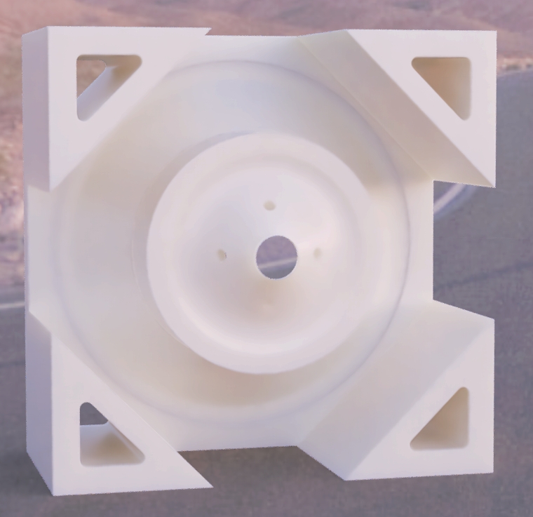

Hi Mark
As far as I can recall, the 5" coax driver is claimed by BMS to have a dispersion of 90 degrees vertical and horisontal. Actually the compression-driver is playing through a 90 degree conical horn, that is part of the magnet-structure of the 5" dome speaker. So you wedge a 60 degree circular horn into a 90 degree horn, making it airtight and with an allmost seemless transition! And then you make holes in the 60 degree horn at the right places for the 5" cone to fire into the synergy-horn. The SM60F horn appears to be round in the throat section, changing to an allmost square shape at the mouth. There is a cut-away-picture of the SM60F somewhere.
Maybe that is all known to you guys. I´ve spend quit some time thinking how to copy that idea with a 3D printer, the 5" coax-driver is not that expensive. But I´m probably going for an AXI2050 or big 4594HE BMS coax-compressiondriver in my hopefully upcoming synergy build.
Regards
Steffen
Regards
Steffen

Perhaps you have not seen this thread before ?
Bookshelf Synergy with a 6.5" Coax in a reflex box
It doesn't lend itself to flat wooden panels and works better when the H and V are the same or even better when the horn is axisymmetric.

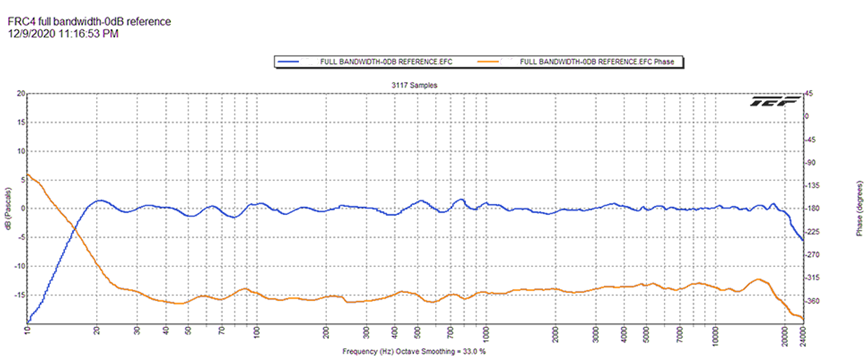

I explored that question here, a few years ago: Prosound Coaxial Hacking
I had similar concerns: if you look at the frequency response of just about every prosound coax, the tweeter response is not great.
It would be interesting to evaluate if flattening the frequency response with DSP would be sufficient to make it sound "HiFi."
This may be the case, because the response curves of these coaxes is consistent. IE, the response isn't FLAT but it's consistent, and because it's consistent it may be able to make a significant improvement with DSP EQ.
