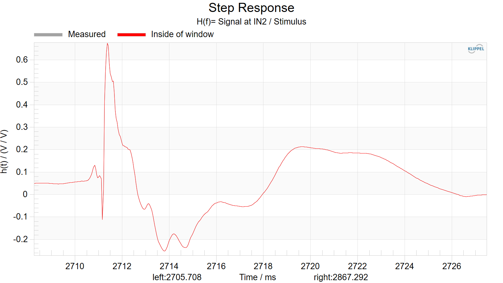

How about step response on-axis?

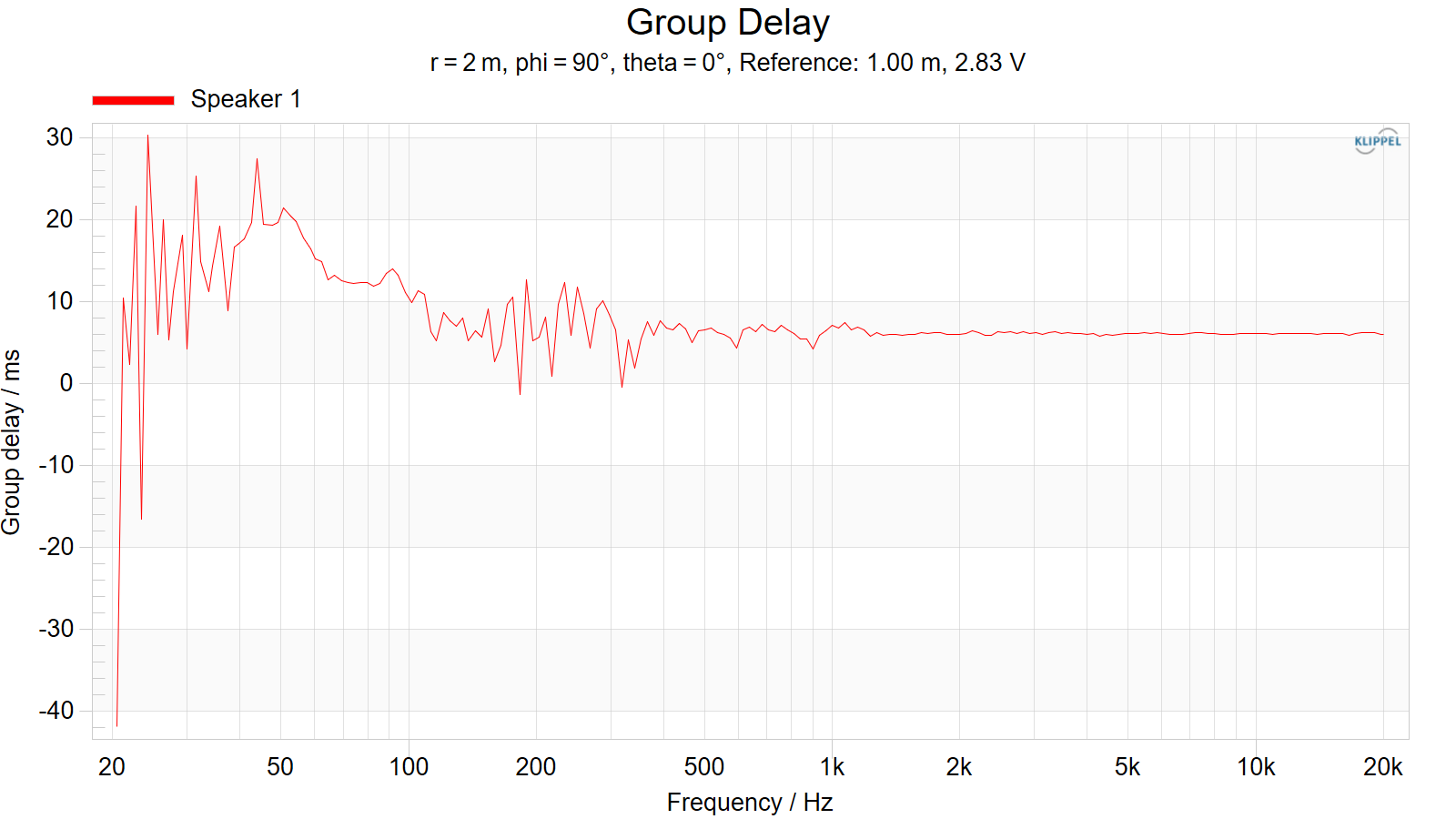

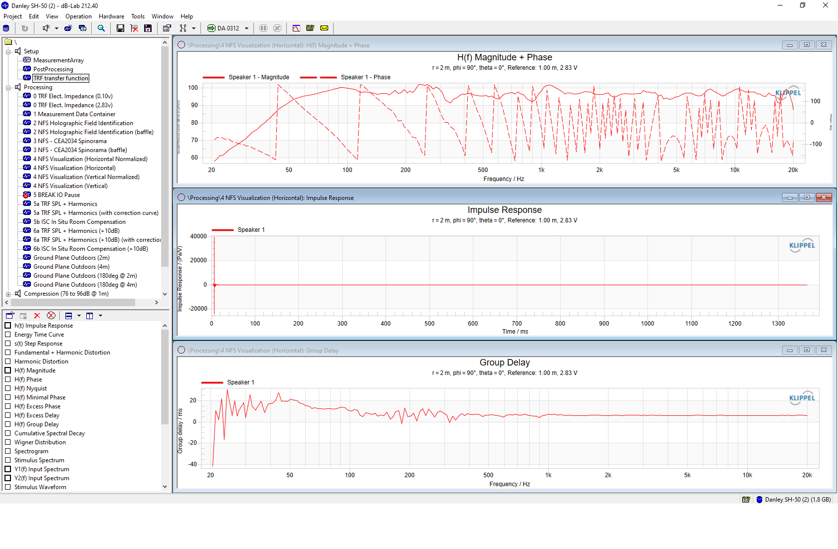

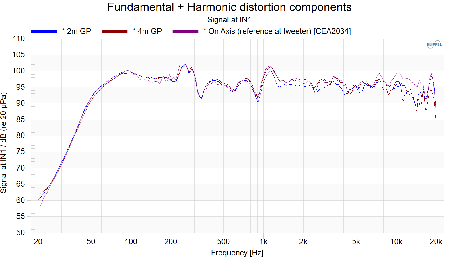

Thanks for your patience. See attached.
I've attacahed 3 images.
First is a groundplane comparison at 2m and 4m to that of the anechoic data. (above the midrange there is expected difference because the speaker wasn't angled toward the mic; I only cared about verifying the LF data of the anechoic response)
Second is an 'overall' shot showing the IR range of anechoic data, GD and phase/mag.
Third is enlarged GD.
Keep in mind this is anechoic data with response resolution of 0.73Hz. I know it will look funny but that's most likely because you've been used to gated measurements. Even the GP measurements you see in my comparison are gated to about 170ms (~6Hz increment/resolution) and you can see how this drives a difference in the lower frequencies. For point of reference, most gated "quasi-anechoic" measurements are 3-5ms which is about 200-300Hz resolution. Most GP data I see is gated no higher than 200ms; if that. Again, just clarifying because I know it won't look "right" if you don't understand this ahead of time.
Okay, that's it. Hope ya'll appreciate it and we can move on...
- Erin

Thanks Rick. That's one of the nicest compliments that I've ever received. And I don't find you annoying--only serious about your music reproduction--just like myself. We both look at the problem space and the solution space differently, but our ears apparently work very similarly.
And I also understand the situation a lot better with Erin's rig. I think I see why he's so focused on the money thing right now. I also believe that I understand why he's investing in Klippel NFS--because people on forums like this won't listen to those that don't have $10K, $20K or even $100K test rigs (and I can think of one person on another forum that apparently started catering to that sort of thing...and that person isn't Erin).
So Erin, sorry that I didn't understand the limitations of your current/prior NFS setup. I have thought (in my dreams) of what I'd do with an NFS rig, but then reality sets in fairly rapidly after that initial thought. I've actually talked about the added resolution of an NFS that could be used to identify more minute issues in loudspeaker implementation (like in-box resonances and driver issues, etc.). I don't want to detract from that effort, but perhaps a bit more transparency on your part would have avoided the events today. Lessons learned.
The biggest single point that I intended to make is that most people are chasing things like flat SPL on-axis, and have not realized or learned on their own that on-axis SPL flatness is about the only loudspeaker performance capability that can easily be remedied. Controlled directivity, extremely low modulation distortion (at full volume) and linear or flat acoustic (not electrical impedance) phase growth are the capabilities that do make a difference.
Tom Danley has actually made it easy with his initial Unity Horn design, and has showed the importance of linear/flat phase growth with the Synergy Horns. With the Hyperion, he has apparently translated that into extremely flat SPL/phase response via FIR filtering (down to a very low frequency), along with the other items I mentioned above. He's given up directivity below ~500 Hz, but I think he realizes that "narrow loudspeakers" are too difficult a subject to overcome in the consumer's expectations, so he's given up on full-range directivity, and instead added the FIR filtering for home duty. I don't give up on full-range directivity, in fact, I've found it to be a transformational capability. Perhaps more on that subject later--and not in this thread (or perhaps this forum, if it continues to drift toward "lowest common denominator" behavior).
With the K-402-MEH, I actually look at that design sort of like a "paint by numbers" loudspeaker. Mr. Danley has made it easy for us to follow the bread crumbs--if you let yourself do so and pay close attention to what he says. So I don't think of the K-402-MEH as anything but a fusion of two men's ideas: Roy Delgado (the K-402 horn profile and PWK's two-way designs) and Tom Danley (the basic MEH design, and phase flatness). I didn't do much else but follow their lead and do a little thinking about how to put the two ideas together.
Chris
