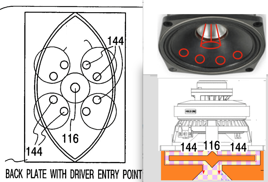

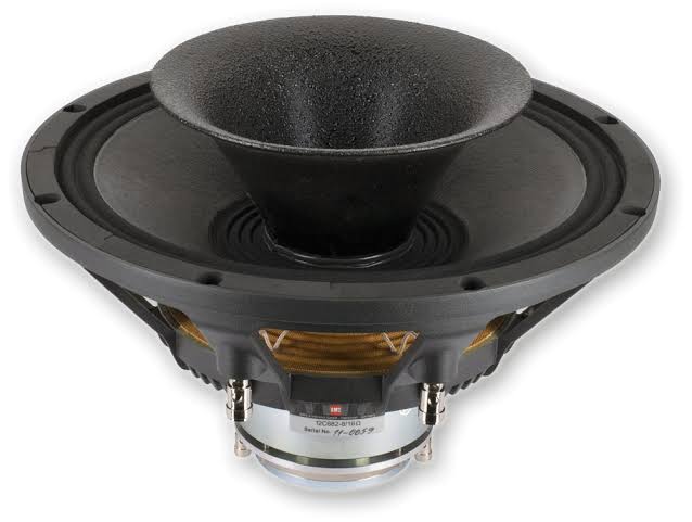

hey partrick good day ,is the shb10 coax driver having this kind of horn shape or a tube,? just like this on the photo
The SBH10, SBH20 and ILE# use 5" coax with 1" HF diaphragms on multiple Paraline devices in an arrangement something like this:
I'd guess the connection of the HF driver output to the Paraline entry point, "116" in the above diagram, is probably around 25mm (1") in diameter, surrounded by woofer entrance points, "144" in the above diagram.
The connection to the Paraline would not be an actual horn like the coaxial driver you attached in post #299 uses.
Art
