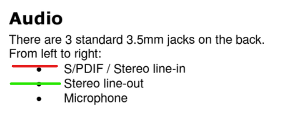

I am using since years Daphile (thanks!), on an old fit-pc2 with an external USB-DAC. Now my setup changes and I run into a problem, maybe someone can point me in the right direction?
I got some new active speakers (Q Acoustics Q Active 200), which have an optical input on their wireless hub, but no USB-input. So, ideally I want to use the optical output of the fit-pc2 to this input. My older USB-DAC (an Audiolab 8200CD CD-Player/DAC) needs some repair and I would like to slim the current setup down.

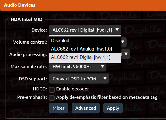

I connected a short optical cable, but when selecting the digital output in Daphile I do not get sound. Using an analogue connection works when I switch to the analogue output setting. The Mixers are all enabled. So I did a few investigations...

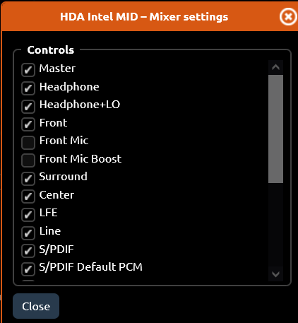

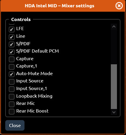

Here my audio and mixer settings:
As mentioned, analog works, digital not. I assume for digital I need both S/PDIF Mixer settings and Master, but I tried also everything active, didn't help.
The optical connector is a combination 3.5mm jack & Mini-Toslink. Here the relavant manual pages, I used the red marked connector for the optical mini-TOSLINK cable and the green for the analogue 3.5mm jack.

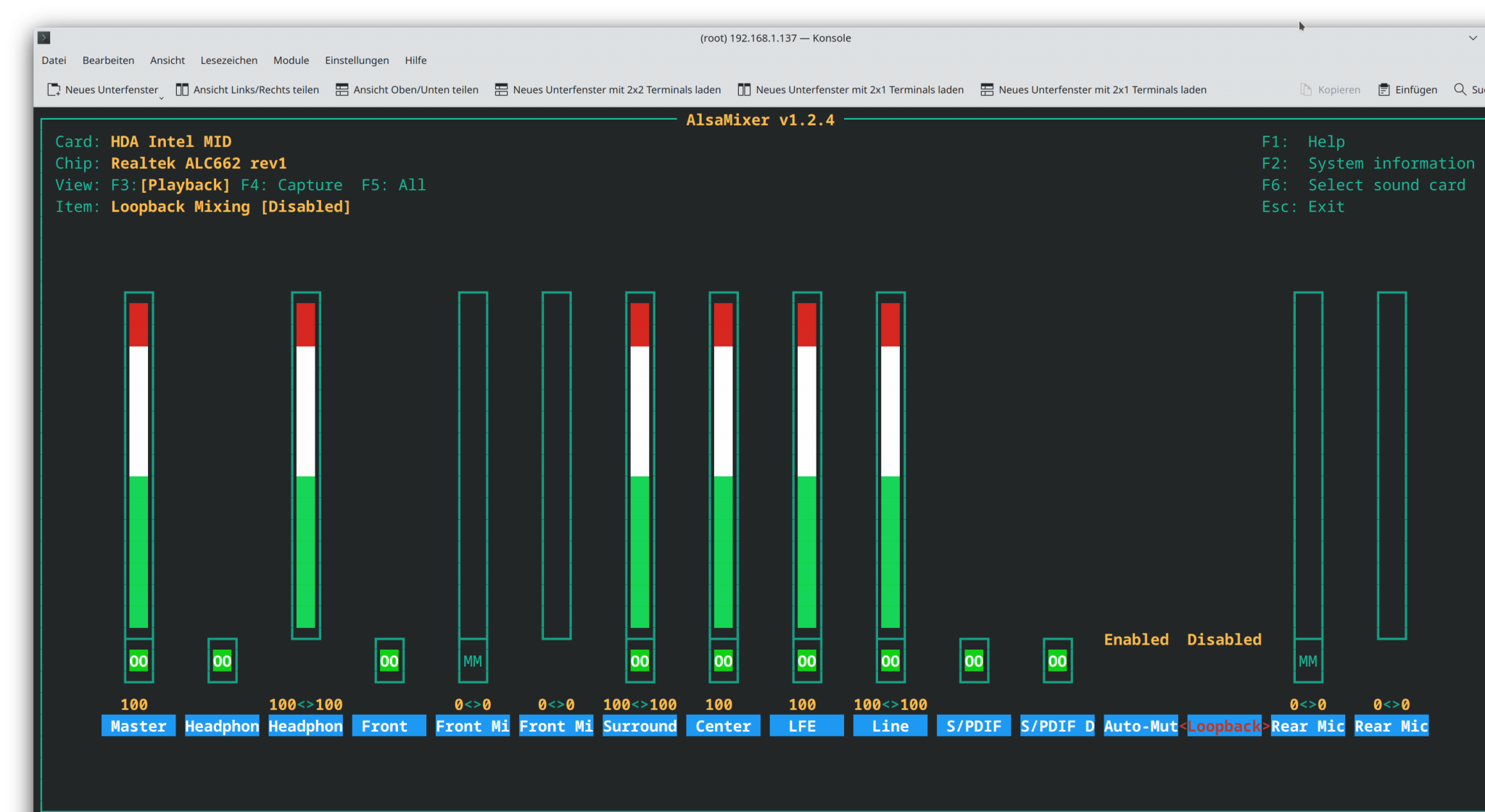

- Alsamixer:

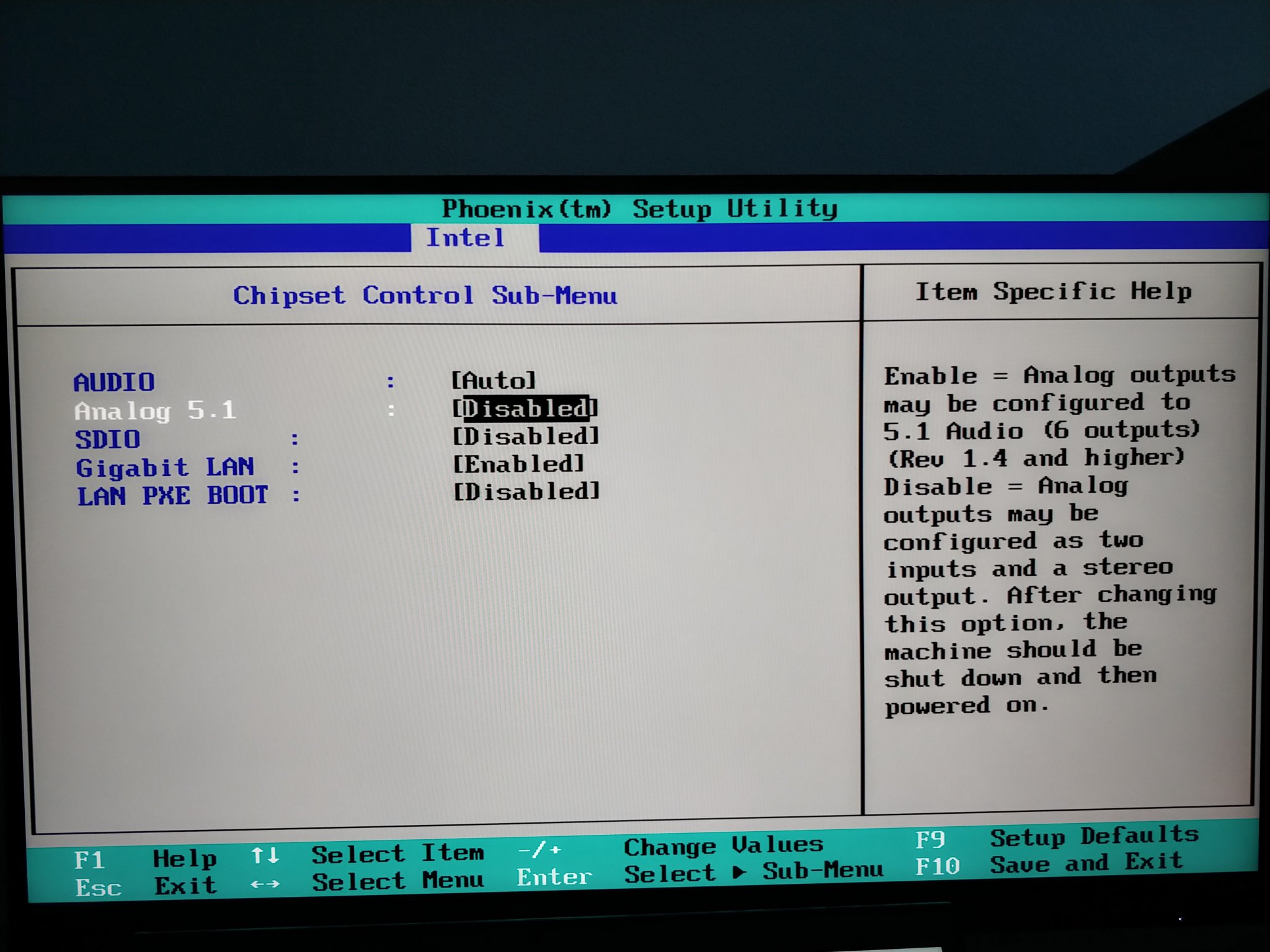

- Checked the BIOS. There was a setting to enable/disable "Analogue 5.1". When activated, I don't get the analogue output anymore, I think this routes 6 output channels through the 3 connectors instead of the standard configuration (input/output/mic). Not sure if it makes a difference for S/PDIF, for me both settings didn't work.
For me, all this looks good, but I still don't get an output through the optical output...

- Alsamixer:
View attachment 1014341 View attachment 1014342 View attachment 1014343

- Alsamixer:
First thing to check… is the optical cable lit up when connected? It should glow red if it's active.
What's the Audio>Auto setting in your bios about? If there's a option to switch analog/digital that hopefully will sort things out
No, I haven't seen it lit up, but I'll double-check. The Audio setting in BIOS is only Auto/Disable....First thing to check… is the optical cable lit up when connected? It should glow red if it's active.

In Windows, I needed to go into the Realtek control panel to manaully switch between analog/digital. If there's a way to do the same in whatever flavour of Linux DAPhile is based off, I'm not smart enough to brain it out. Best I can suggest is search your MOBO and see if you can find any info about enabling optical outNo, I haven't seen it lit up, but I'll double-check. The Audio setting in BIOS is only Auto/Disable....

The good thing: The fit-pc2 was originally sold with Ubuntu, so there must be a Linux way to get it running. The latest entry I find from the manufacturer's side is for Linux Mint 13 (2012): http://www.fit-pc.com/wiki/index.php?title=Linux_Mint_13_on_fit-PC2 . Wondering if the mentioned EMGD drivers (Intel® Embedded Media and Graphics Driver) are needed, or something else?
Oh no! In all the fit-pc2 documentation I see only "S/PDIF". I assumed that is an optical one. Now, I found in an old forum thread that it is actually a coax S/PDIF on the 3.5mm jack, not Mini-TOSLINK! That explains it, haha.
The hub which I need to connect to has only an optical input, but not coax. So I need some kind of conversion either USB->optical or coax->optical. Analog is working, but analogue signals get converted by the Q Acoustic hub to digital to stream wireless to the speakers, so it would be D/A->A/D->D/A...

https://www.compulab.com/wp-content/uploads/2011/08/SBC-FITPC2i-Reference-Guide.pdf chapter "4.5. Audio Interface (P4, P9)" details the 4-pin jack (pin 2 electrical SPDIF out).Now, I found in an old forum thread that it is actually a coax S/PDIF on the 3.5mm jack, not Mini-TOSLINK!
Sure. But that's the fit-pc2i, not the fit-pc2 which I have. It wasn't stated clearly in the user manual (posted excerpts above) or any other source I could find. Not sure how much the 2i is different from the 2, but it didn't came to my mind to search for a different model then I have. But still, of course I shouldn't have assumed it's optical.https://www.compulab.com/wp-content/uploads/2011/08/SBC-FITPC2i-Reference-Guide.pdf chapter "4.5. Audio Interface (P4, P9)" details the 4-pin jack (pin 2 electrical SPDIF out).
Edit: found now the corresponding document for the 2: https://www.google.com/url?q=https:...ploads/2011/08/SBC-FITPC2-Reference-Guide.pdf , but also there I don't find it clearly stated, not like for the 2i
Compare the audio parts of https://fit-iot.s3.amazonaws.com/download/fit-pc2/documents/fit-pc2-top-level-block-diagram.pdf and https://fit-iot.s3.amazonaws.com/download/fit-pc2i/documents/fit-pc2i-top-level-block-diagram.pdf - they are identical.Sure. But that's the fit-pc2i, not the fit-pc2 which I have.

Thanks again everyone. As said, once I realized (post #4,626) this isn't an optical output as I need it, I knew my options.
And I might just been successful installing my old M-Audio Transit USB soundcard (an older simple USB soundcard I had laying around, with optical and analog output). The problem was, this thing needs some firmware loaded into it over USB to do something, otherwise it is not recognized. Solution: Found the required driver/firmware package (madfuload) for this thing for Ubuntu, convert the Ubuntu deb-package to tgz for Gentoo (using alien on a Ubuntu PC), send it to the Daphile-PC, unpack and move the files where they should be. And this card shows up! Still have to make a listening test later (was doing it remotely), but it shows up in the GUI and in aplay, so it looks like it is working! If it is: Case solved, I have an optical output without buying something extra.
