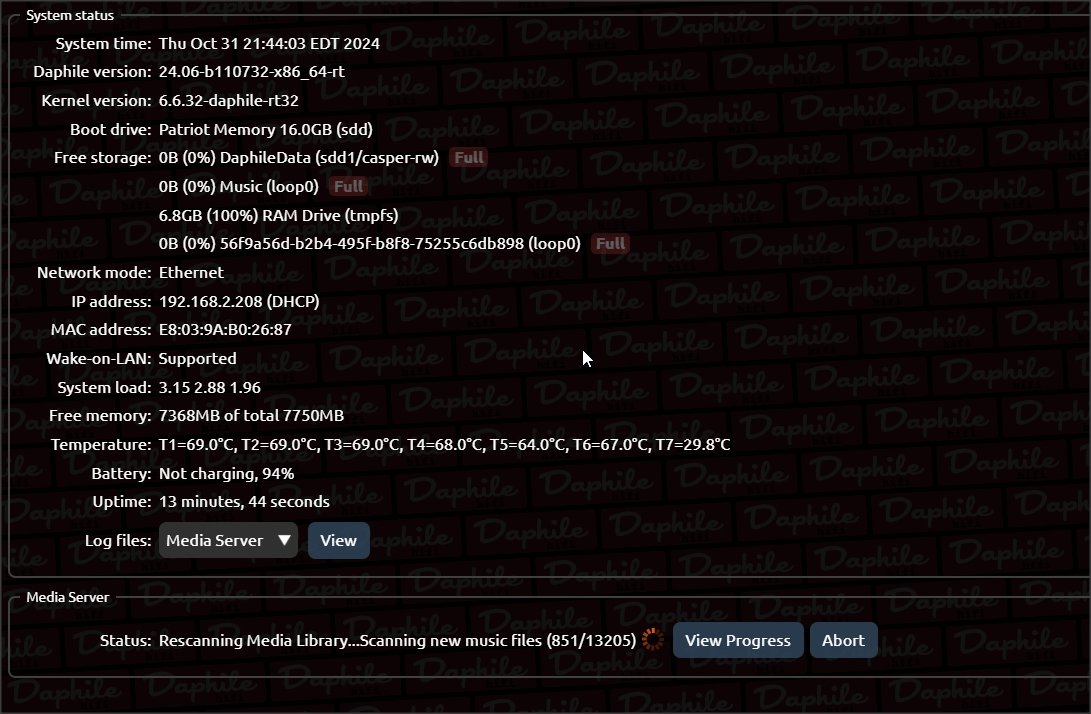

I have been enjoying Daphile (daphile-23.01-b041628-x86_64-rt) without any issues since last year. I try to upgrade to the latest version (daphile-24.06-b110732-x86_64-rt) this week and run into an odd problem.
My system includes:
The PC booted up OK. After putting in the NFS address and restart, it paused during ‘Rescanning Media Library…Scanning new music files’ and about 5 minutes later will show error ‘Free storage Full’.
Media Server Log file:
[24-10-31 21:31:27.6536] main::init (386) Starting Logitech Media Server (v8.5.3, gited497b6, Daphile 24.06-b110732-x86_64-rt) perl 5.038002 - x86_64-linux-thread-multi
[24-10-31 21:31:28.8334] main::checkDataSource (1109) Warning: Schema updated or no media found in the database, initiating scan.
[24-10-31 21:32:32.5947] Slim::Schema::Storage::throw_exception (121) Error: DBI Exception: DBD::SQLite::st execute failed: database or disk is full [for Statement "UPDATE metainformation SET value = ? WHERE ( name = ? )" with ParamValues: 1=0, 2='isScanning']
I have tried to boot from my other Samsung laptop and got the same result but paused at a different file location. Any suggestions are welcome.

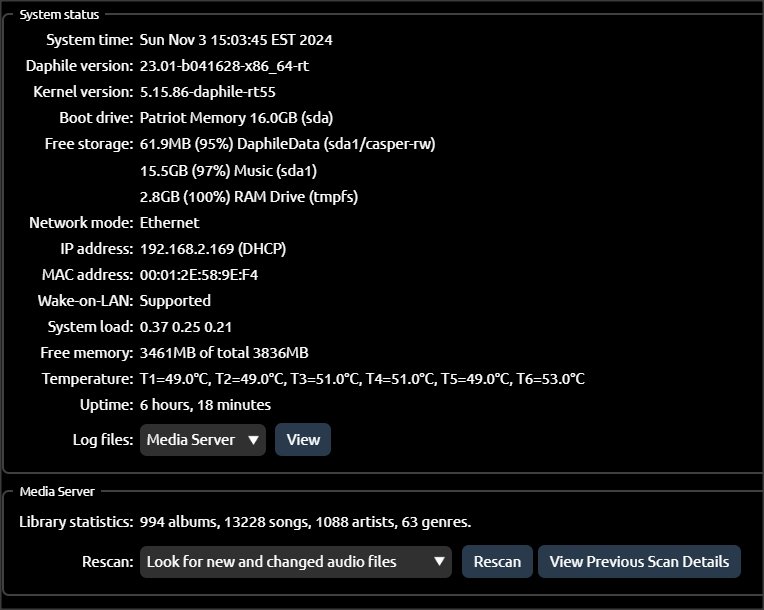

When a new version of Daphile is installed on my 16GB USB drive and boot up in my PC (Zotac ZBOX nano), it will always do a rescan of everything. And it is during this first scan that Daphile got stuck around the 1300~1500th file. I have tried to move some of the albums around, the same problem will appear on a different spot.
I don't think any of the storage space is full. My DS932+ has >7TB of free space. Running the older version (daphile-23.01-b041628-x86_64-rt), everything comes up fine. Free memory on the PC is 3461MB of the total 3836MB. Boot drive Free Storage is 61.9MB (95%) DaphileData. You can see the attach pic for details.
I can try a 32GB USB drive and see if it can fix the problem.
USB drives will do this. It should restart after a few minutes, the write speed of the drive is not high and Daphile does write a bunch of info to the drive while scanning. For very large libraries it is recommended to use a faster storage mechanism. You could also use a SSD for the initial scan, then dump the image on to the USB drive.

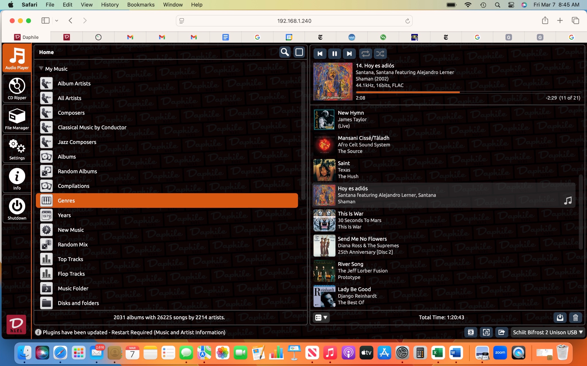

Here's a fun question: is there a way to edit the list below "My Music" on the left side of the screen? I'm not sure what "Flop Tracks" means, and I don't see a reason to specifically call out "Classical Music by Conductor" and "Jazz Composers".

Hey Scott,
If I'm understanding the question correctly, go into Settings> Advanced Settings and to select what is viewable. Easier said than done.
You need to be in correct sub-section to see all available library sorting selections. I'm not home, but if you don't get an answer today, I can check my server tonight.
