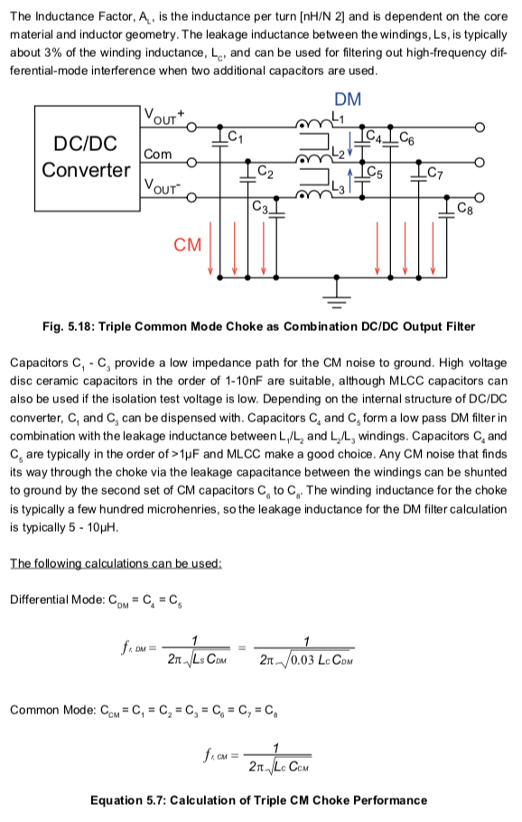

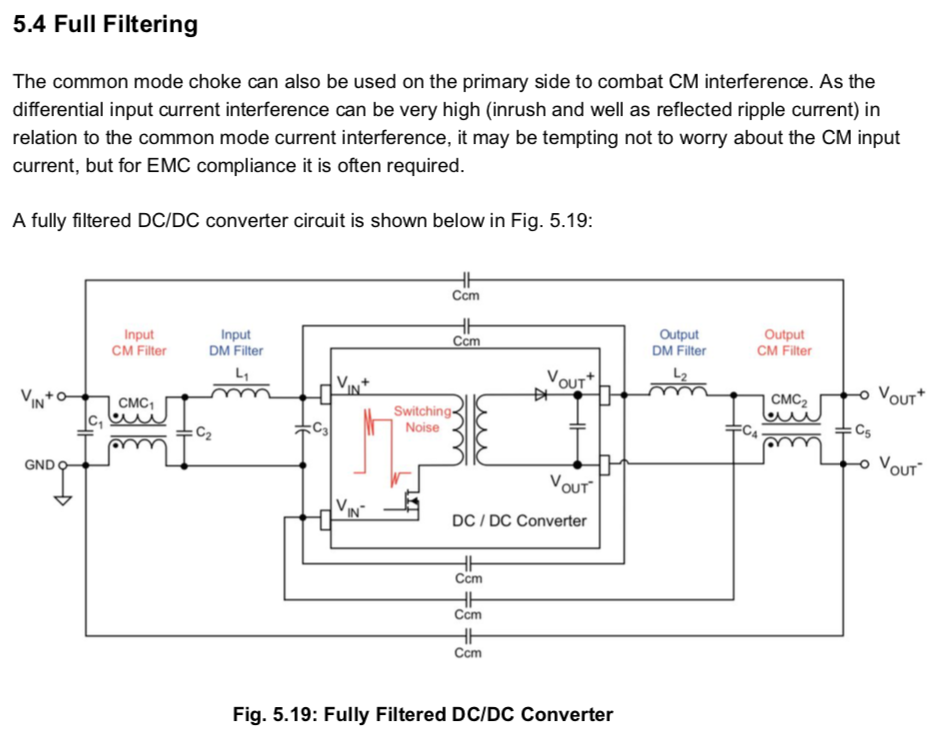

I'm still at the stage of trying to understand things, but i will probably follow your schematics 100%. One extra doubt is, in that DC-DC Book linked above, Recom CTO includes a choke in the input and one in the output (since all the pins are affected), see capture.The last two quotes are spot on on what is going on. On my boards I use both CM choke to have broad band CM filtering and caps to short the CM loop at HF. The HF bridge across the isolation barrier in audio equipment does not add problems since it acts at frequencies not relevant for audio. In other equipment, where true isolation is needed for safety reasons such capacitors may be an issue as mentioned in the last quote. If you are concerned about the effect of those capacitors across the isolation barrier just skip them and use the CM choke only.

The output CM choke will be difficult to incorporate due to bi-polar output of the DC-DC converter which ideally would require a three winding choke.
You're absolutely right, again 🙂
Bi-polar output chokes are also treated in that book, see captures below
I wrote Steve Roberts from Recom, he's been sooooo nice answering my doubts as well. Everyone is so nice, guys, thank you! Basically I was freaking out about the caps possibly breaking the isolation. Answer: they don't.
Also asked him about 3 winding chokes:
Würth Elektronik WE-SL3 series (e.g. DigiKey 732-14096-2-ND), TDK ACM2520 (e.g. DigiKey 445-4842-2-ND) or Murata NGF series (e.g. Digikey 490-18604-2-ND) are all freely available. The need for an output filter is dependent on the application – you may get away just with an input filter and output capacitors.
Great! I've got away with the input filter and output capacitors 😉 I just added ferrite beads to the converter outs to get rid of the switching noise spikes.
