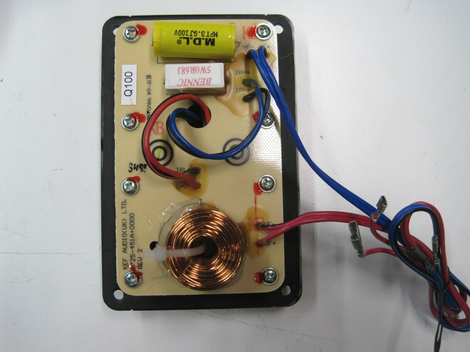

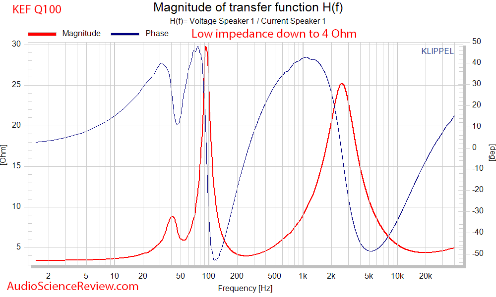

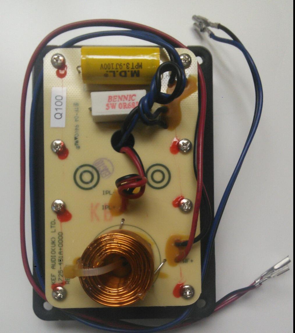

Hold off buying a Dayton crossover for the moment - I want to revise my suggestion of which one to buy.
Before choosing which Dayton crossover is best suited to your needs, we really need to be sure what the impedance of the tweeter is.
Why? Because if you use a 4 ohm tweeter with an 8 ohm crossover, the crossover frequency point will double, and is likely to leave a hole in the middle of the reproduction.
It is said that the Uni-Q drivers in the KEF LS50 are 4 ohm, but we need to be sure about yours.
If you disconnect the Uni-Q mid/bass and tweeter from the electronics, you can then measure the dc resistance of each driver with a multimeter and report back here with your measurements. Then we can choose the most appropriate Dayton crossover fron SoundImports.
Meanwhile, the original suggestion of simply wiring a non-polar capacitor in series with the tweeter in order to get the speakers up and running, as previously explained, is the way to progress.

I've checked, and the active X300A employs the same Uni-Q driver as the passive Q100.What is the passive KEF speaker which is the twin brother of the X300A?
The specs of the Q100 state a nominal impedance of 8 ohm, but that does not necessarily mean the tweeter is 8 ohm.
A DC resistance measurement of the tweeter will keep us right!

Actually, the Q100 crossover is surprisingly simple - one coil, one capacitor and one resistor!
It would be much cheaper to duplicate it by buying the individual components.
Would you be prepared to undertake building your own version of the crossover with some help from us?
