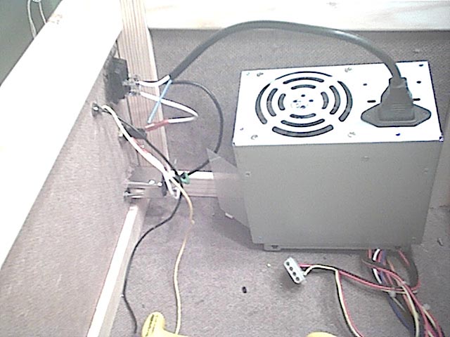

i got myself an extra pc psu and i am ready to build a psu for my panel. plese explain to me how to do it in more detail. the panel is a positive center. what color cable from the power supply do i solder to the positive center. And what color cable from the pc power supply do i solder to the outside negative. If anyone has some pictures of building a power supply for there sharp please post. I am not that great with soldering and electronics but i think i got the idea of what i need to do here.
I have one of those barrel ends for my rs power supply with two pins coming out of it. I would assume the easiest way would be to take that and solder the pc wires to it. Im not sure how i tell tho what pin is the center.
Also my pc power supply has many diff sets of cables, probably meant for all diff types of tasks (cdrom power , hd power , ect) does it matter from which set i choose to take power from?

Okie doky...if you want +12V for your panle...grab those molex connectors...and cut the yellow and a black wire...the yello will be your +12V and the Ground will be your black wire...test with a voltmeter to be sure...I assume your PSU can power up without a load...if it doesn't...get a resistor and put it between the Red and Black lines..(+5V and GND) creates a load for the PSU to run properly...it will probably not be necessary for an AT PSU...

well i tried using compulter power supply then i tried a 12v 3.3amper power supply and i still had the same problems. I am guessing its damages panel. I wish their was one set way with instructions on how to strip a good quality fairly cheap monitor. I wouldnt mind stripping an lcd but i would deff want 1. cheap, 2.good instructions.
I am prety sure this doesnt exist. O well i guess back to flee bay.
