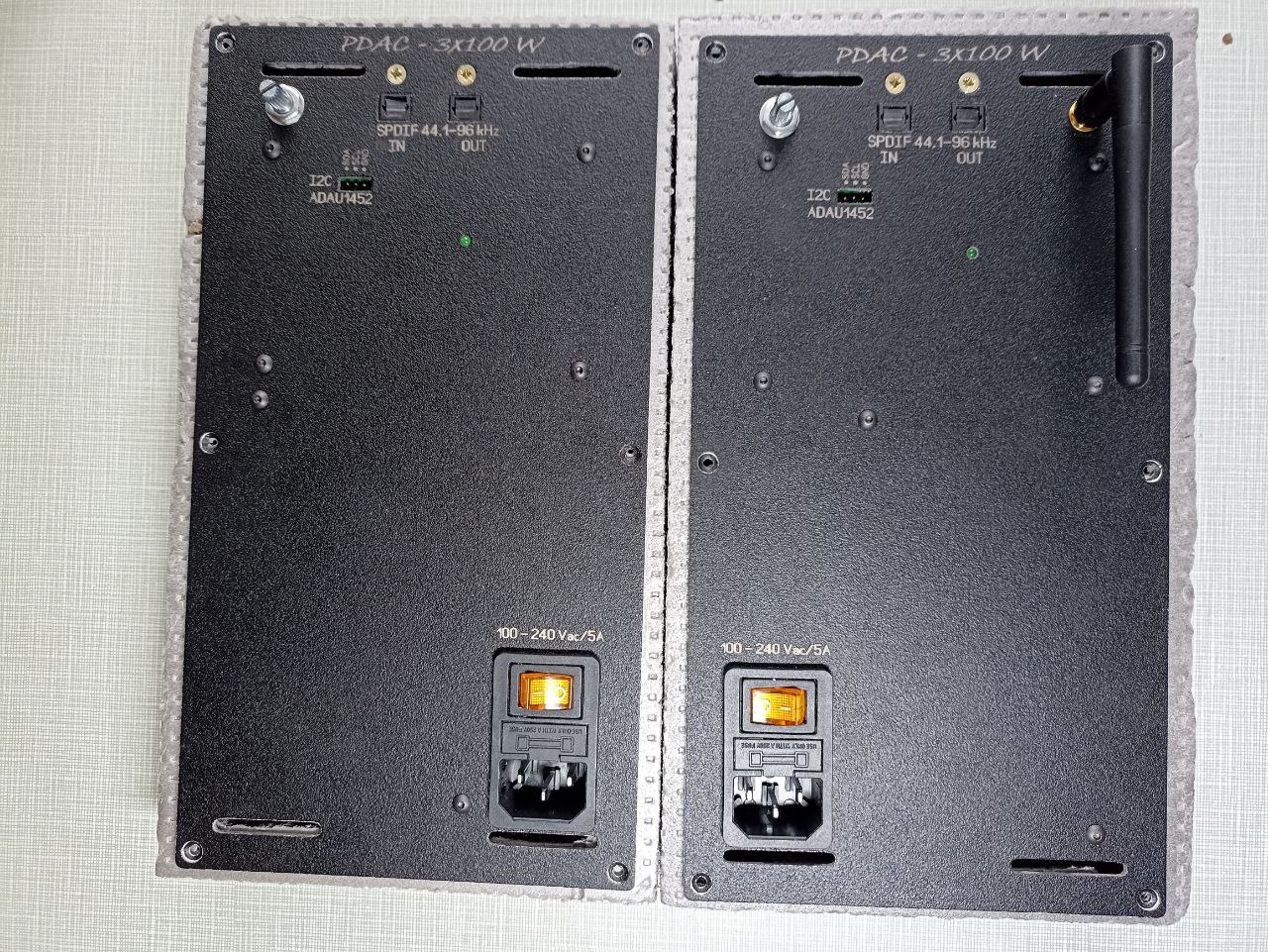

Could this be the answer to my question?
Pay attention to this option. Made specifically for active three-way speakers. Each channel holds 100W at 4 Ohms with nonlinear distortion less than 0.01% at 100W, and has a noise level below 106 dB(A). More detailed information is in the links.
https://www.diyaudio.com/community/threads/3-way-dsp-amp.415065/#post-7734899
https://www.diyaudio.com/community/threads/board-3-way-dsp-amp.415079/
https://www.diyaudio.com/community/...ac-with-dsp-adau1452-100w-per-channel.410804/
Now I’m sitting here listening to this implementation, which after testing I’ll put up for sale.

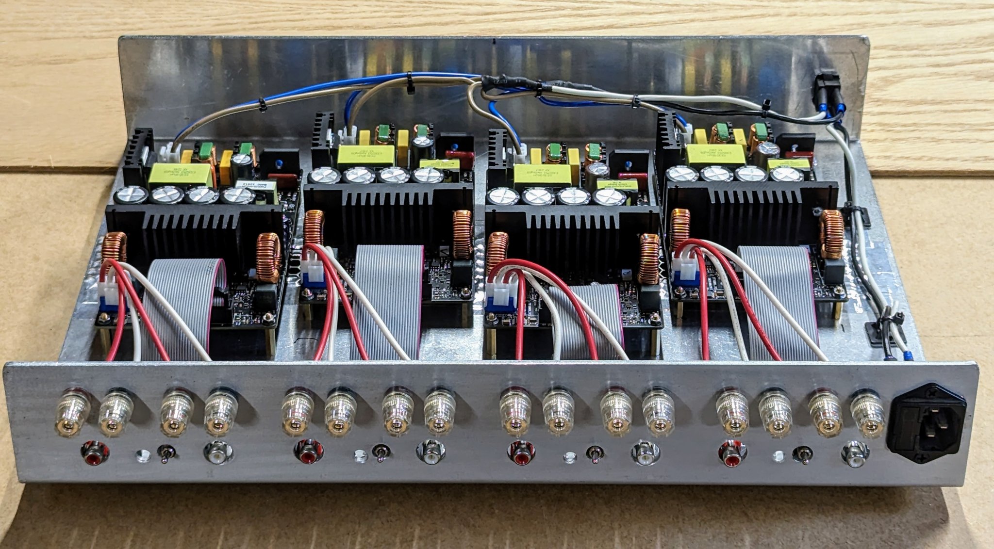

I use https://sound-au.com/project127.htm in mine. These are however DIY amps, but are easy to make.
I use two stereo amps per speaker as I have two bass units with a bit of EQ so need a little extra power. I use a 28-0-28 transformer that gives me +-40V for about 80W per amp.
I have a small living room so there is waaaay more power than I need, but I chose them because they are good enough amps and are really small - apart from the heatsink that takes the full width of my very slim cabinets.
My crossovers are analogue and Rod also sells boards for these.
Hope that helps.

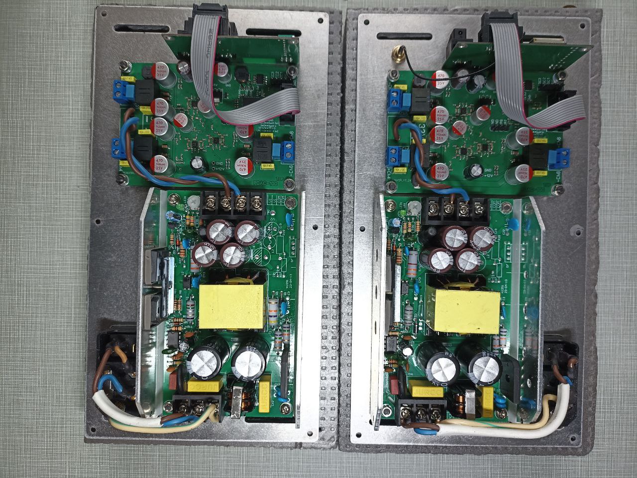

@uriy-ch your projects look very interesting. Still absorbing the content of the threads you linked. I'm sure I'm going to have questions, do you want me to post them here or to one of your other threads?
I'm sure I'm going to have questions, do you want me to post them here or to one of those other threads?
Decide for yourself what is more convenient for you, I am ready to answer questions here and there.
By the way, I named the price for DSP amplifiers on a plate, and in this thread I posted a dxf file for laser cutting for those who can cut plates at home and thus save money by buying only the DSP amplifier itself.
https://www.diyaudio.com/community/...for-3-way-active-speaker.421239/#post-7872876
Amazing work @uriy-ch
Several of us @hifijim @ernperkins @cowanaudio have been talking about a good solution for a 3 way DSP amp, meanwhile, you’ve been designing it!
@waxx of course one can have outboard crossovers and separate amps for 110+ dB SNR and 0.0001% distortion, but really, only the engineers want that.
Your solution looks very good, and enough for a 3 way, even with a big ported 8-10” woofer! Please link me to your completed plate amps on eBay- I will support your venture!
