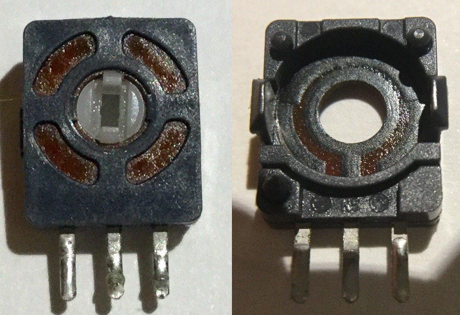

The original Alps Alpine thumbstick sensor w/ 10k pots have no identification. Testing the pots revealed they were log or semi-log.
The replacement analog sensor on hand is the Polyshine FJP10K-S1, which uses 10k linear pots. This is a common replacement that is well constructed.

I connected a 12k resistor to the common return (pin 1) to center (pin 2) and it behaved very smooth like the original log Alps pots. The problem was the ADC saw it as if the stick was off centered in that arrangement.

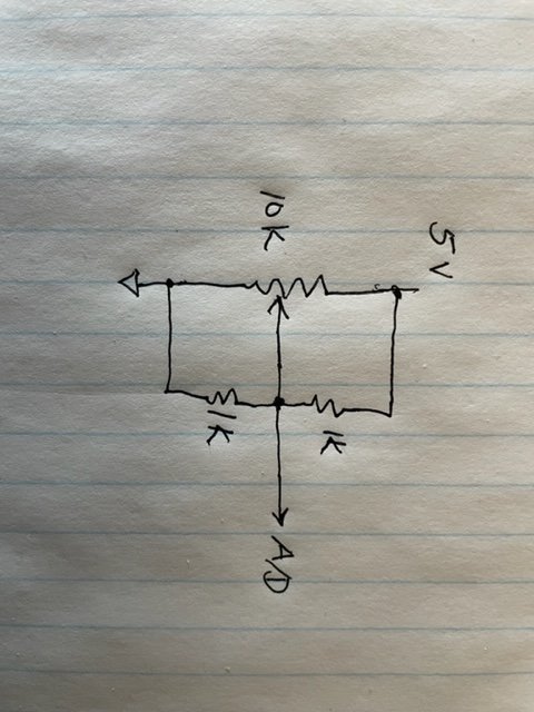

You didn't indicate how the pot was connected, but I've guessed as below and have suggested 1K load resistors. Max wiper current would be 5mA, and rotational sensitivity would be reduced to about 1/6 re without the loading resistors. Not sure if guess of pot connection is correct or if this is what you're wanting...
I tried that method and I just couldn't get it right. Your earlier diagram gave me the idea of using a resistor on pin 1 as in my last diagram, and using that centered it right up.

I do. I was able to plot the resistance of one half turn using 5 degree increments. The left-hand side of the graph (0 degrees) is the thumbstick at dead center.
The original Alps was made for 30 degrees of travel, and the analog thumb stick modules were mechanically limited at this exact point. The first 5 and 10 degrees is more gradual.
The Polyshines and others have reached the end of their tracks before 25 degrees. This corresponds with the newer gaming consoles using sticks limited to 23 degrees. They appear to be truly linear.

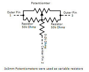

A different method was tried and seemed to work better. I had to use the arrangement pictured here, with 3x3mm mini pots used as variable resistors. The 50k pots on pins 1-2 and 2-3 set the expo as an S-curve like before and fine tuned the center position. The high values facilitate finding a suitable range, which wasn't easy, as the S-curve was different than the C-shaped expo curve of a single resistor. 27-30k Ohms each was a good compromise. The 2k mini pot on the center pin, pin 2 leading to the circuit board, set the sensitivity without noticeably expanding the deadzone at center, and seemed to be what was needed.
