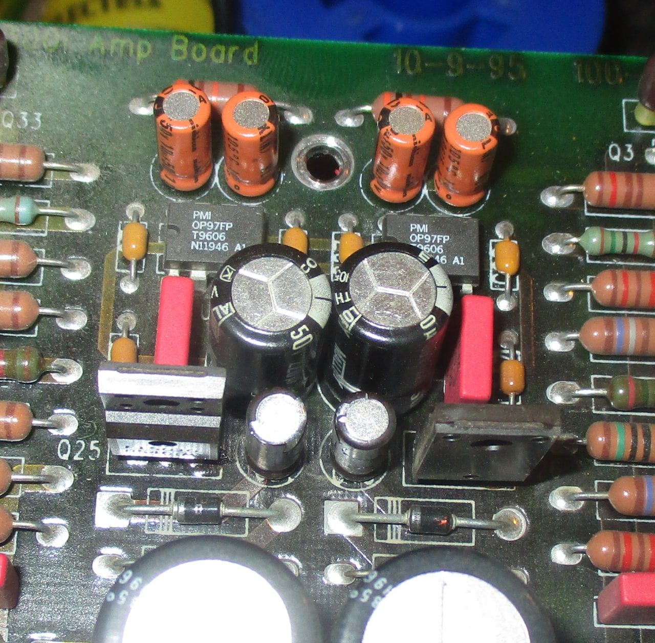

Krell KAV300i has its low voltage rails made with a simple linear reg with zeners for reference and those things run so hot that not only the resistors burn, but all the capacitors nearby too.
The brown ones used to be nice and orange in distant past lol.
I still have to figure out why the amp is misbehaving, its final output stage is outside the feedback loop and there's rising freq response with volume level, and both channels differ. Unfortunately the layout inside makes detective work a bit difficult. One day I'll have enough desk space to have it open and under close scrutiny...
