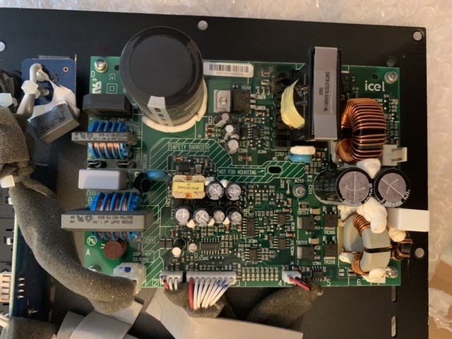

(picture) 400W SMPS/Ice class D that fails and takes out the woofer. Nice woofer (pix).
B& W DOES make a good sub , you just have to go up to 2000$ (Hypex 1000 + Hypex SMPS) , woofer is beyond bada$$.
2K is a lot just to get to the quality level that was the norm for cheap stuff in the 20th century. I still find 80's amps made in Japan
that just need filter caps and TLC.
I'm glad I know the "insides" of this consumer fluff. I buy 7$ SMPS's on Ebay and replace all the caps with Nichicon's/Panasonic's. Tidy up the sloppy
soldering and switching devices with no thermal compound - the new (reworked) now....12$ SMPS lasts decades.

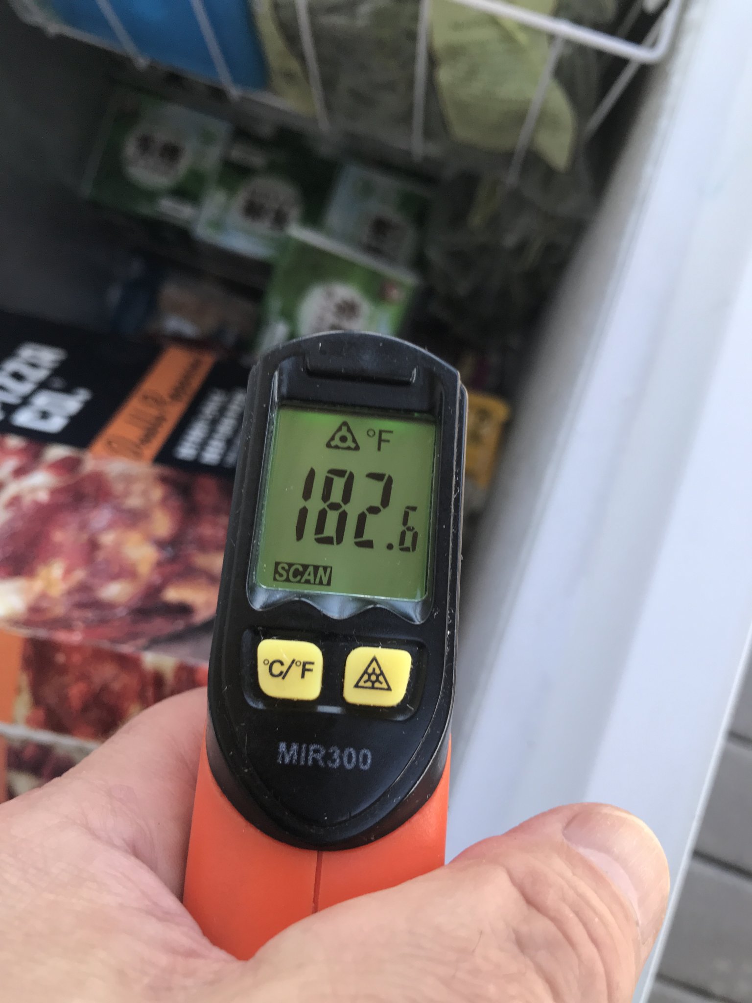

The first is an infrared thermometer I got from Costco years ago. Works great on Celsius but on Farhenheit, at temps below 32F, it has math errors. The photo is a reading of my freezer. No wonder the ice cream is always soft.

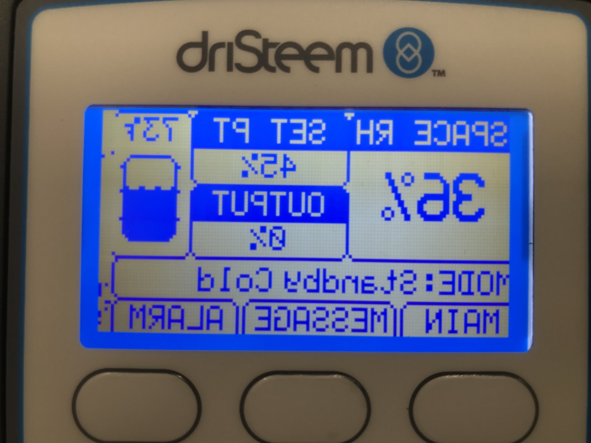

The second is the control panel for a humidification system we have at work. After 10 years the display died, so they sent us a replacement. This worked but the text was backwards. After a year, three more replacements, two firmare updates and countless phone calls, we finally had a system that could be read without a mirror.

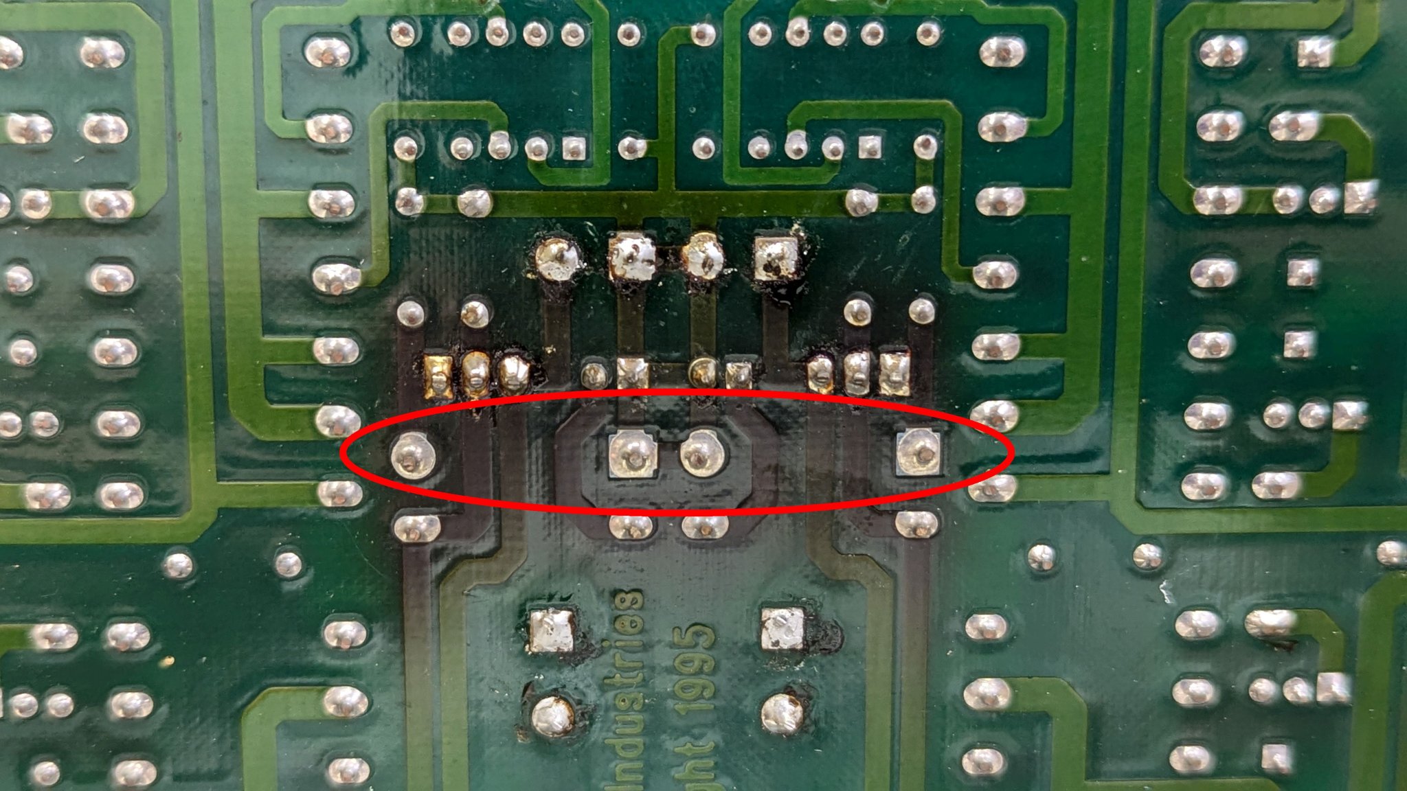

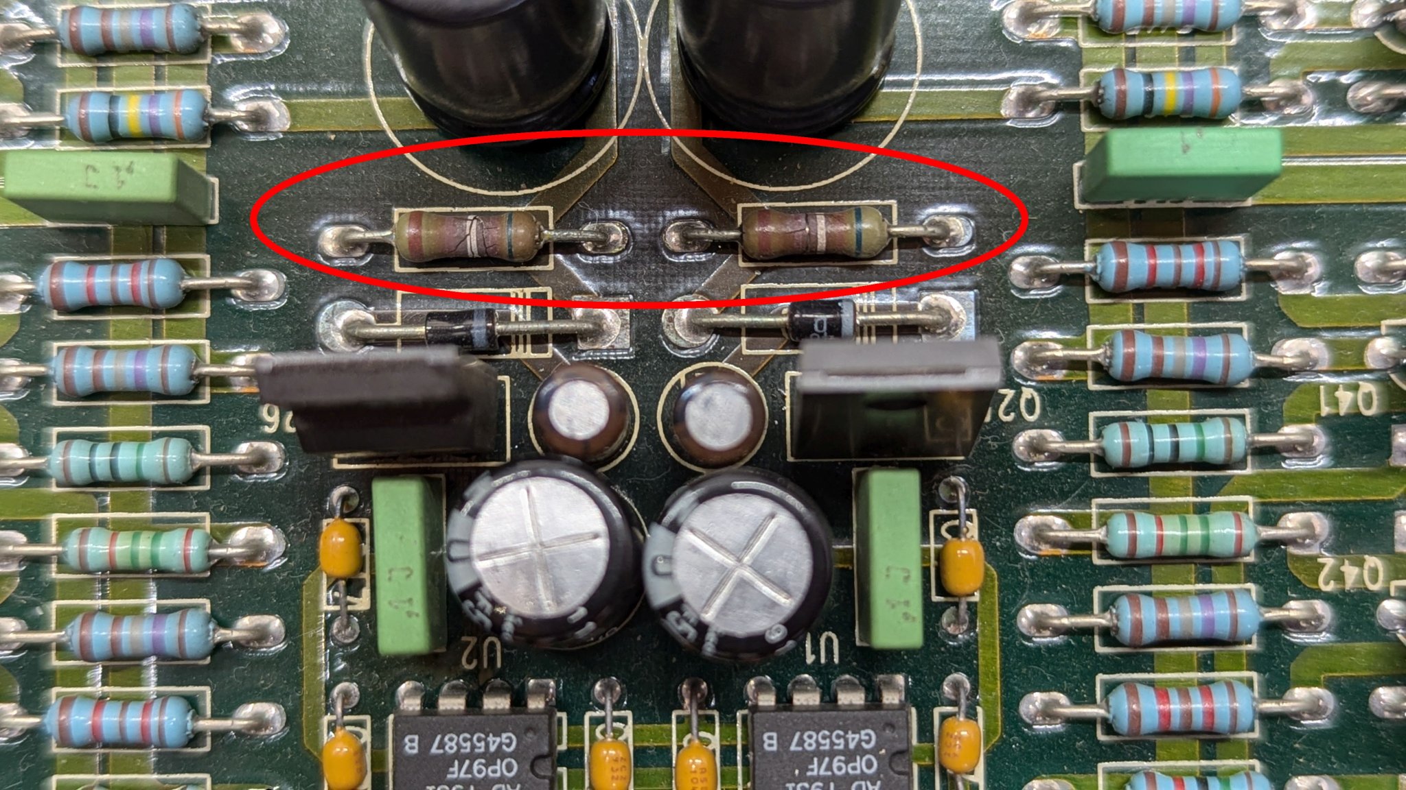

A while back someone posted about burned parts in a Krell KAV300i amp. I recently bought one in working condition on ebay, assuming I would need to recap it. When it arrived I opened it up and sure enough, the main power supply filter caps were bulging a bit. In a previous post someone posted pix of some toasted parts in their amp. Mine had the same issue.
In my amp, two resistors in the 18V regulator circuit were cooked so badly that the outer cover of the resistors had turned brown and cracked. The two 10uF 50V caps between the transistors had also turned brown:

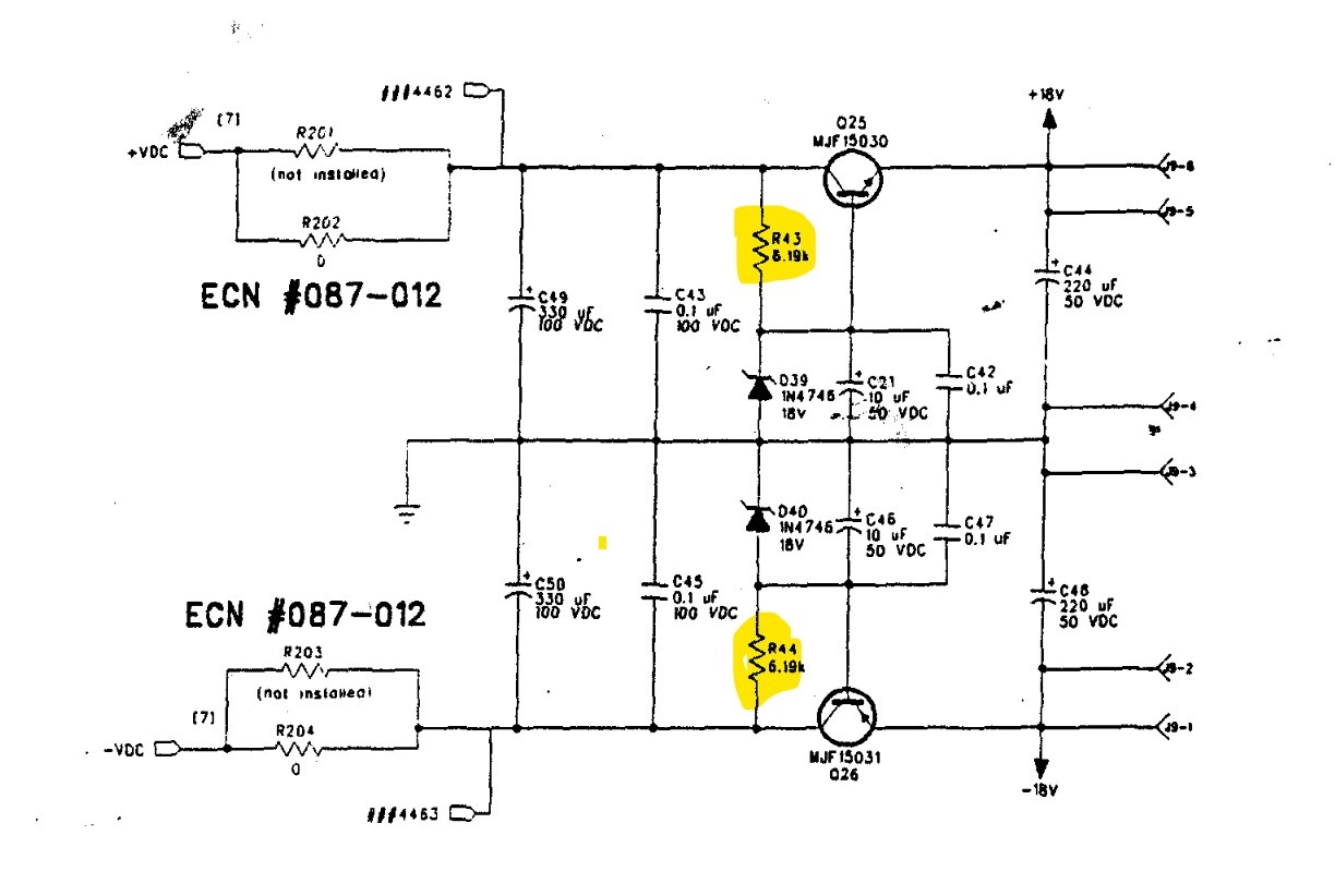

The VDC references the +/- 60V main power rails, so the 6.19k resistors should only have about 7 mA going through them which works out to 0.28W, so they are not likely to be the main heat source. The transistors have 42V from C to E. If there's even 50 mA there, they will be dissipating about 2W each, so yeah, they're probably going to run warm.
The transistors have isolated tabs, so it should be easy to attach a heatsink even in the limited space between the poweramp and preamp boards.
I have replaced all the electrolytic caps in the amp- Nichicon EKWs in most spots, and for the 10uF 50V caps I used some Kemet ultra long life, low ESR parts. I'm waiting for a few more parts to arrive then I'll do the final work on the amp.
With respect to the Krell KAV300i, is the transformer center-tapped? I know that's a silly question but often folks try to create a synthetic ground rail without taking into account the differential current drawn by the poz and neg rails over time.
The service manual I have is missing the main power supply page(s), but there are 4 wires connecting the transformer to the power amp board, so it looks like two windings, each with a bridge rectifier. They're probably tying two of the rectifier outputs together on the DC side.
Maybe if the 10uF capacitors C21 and C46 get more leaky with time & heat, the current through the zener resistors might increase more than the original designer intended.
That seems possible, but the toasted area is centered on the two transistors, with heat conducted up and down (in the photo) by the PCB traces. I'll be adding small aluminum strips as heatsinks to the transistors and standing the new resistors off the PCB. In the photo the resistors connect at the circled pads. I should probably go ahead and replace those transistors as they have apparently been running hot for a long time. Those two parts cost about $3, so an easy and cheap replacement- no excuses...
That's the plan. I'll be replacing the resistors, electrolytic and film caps, transistors, and Zener diodes in that area of the board. It should be pretty easy, as long as the cooked traces don't lift off the board when I desolder the parts. I'll post a photo of the final fix when it's done.
The biggest flaw in this amp's design is probably the fact that they put the output transistor heatsinks inside the chassis with minimal ventilation holes. Even if I were to cut more holes in the top and bottom covers, the heatsinks are oriented horizontally with fins running from front to back, not very conducive to convective air flow, though I suppose if you give the hot air a means to escape, it will be replaced by cooler room air.
Maybe I'll mill some slots directly over the heatsinks in the top and bottom covers...
Those two small electrolytics in between the power transistors are the ones I'd be most worried about. Nichicon's UBX product line is good up to 150C , and so is Vishay Beyschlag series 160 RLA. Both are in stock at DigiKey. It's easy to find higher wattage diodes and resistors, but not electrolytic capacitors so much.
