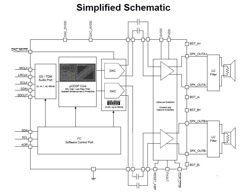

Attached the simplified schematics from the project.
In my final set-up a Stm32 nucleo board will contrrol several amp boards:
- configure the miniDSPs,
- receive music from USB (async),
- manage the volume,
- send the I2S audio streams, based on the board clock,
- control the few I/O (like mute) and acquire the amps outputs (fault...)

Requesting the files on the TI community, I have now the TAS3251EVM Gerber and CAD files.
As the used CAD is Altium, and I don't have this professional product. I used a web service Altium2KiCAD to translate the files. It does not seems perfect, but looks like a starting point. At least it allows to start study the TI design.
Unfortunately, it is a 4 layers board. Top and bottom are the key layers. One internal is almost plain copper. The second internal one has some traces to the TAS3251 and for PFFB part.
I have to study if I can go to 2 layers PCB, which would be much cheaper. However as it is my second PCB attempt, I will be very interested by the advice of knowledgeable ones to avoid big mistakes.
I also have to install the PPC3 TI tool that allows to generate the TAS3251 config headers, to ensure that it can be achieved without buying the real TAS3251EVM. I'm a bit cautious about those policies where you are blocked in a proprietary system designed for another customer target (big consumer electronics companies).
Last, I wonder if implementing the psot filter feedback part is useful or not, if looking for the best sonic performance and not the best measurements. Anybody compared ?

As of today:
I just get the access to the TAS3251 module in TI configuration tool PPC3. Good to have. I will now study it and confirm the possibility to configure the chip without having the TAS3251EVM board.
Studying the different reference designs, it happens that the TPA3255EVM has only 2 layers. Fine ! This confirms the acceptability ! I will do a mix between the TPA EVM. concepts and the TAS EVM ones.
I'm currently learning about KiCAD basics. I will try to submit a schematic for the project soon.
