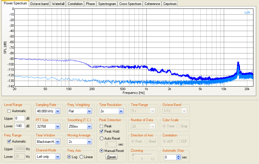

Here's the results for the TPA3128 on a 1.0mm board when knocking at the side edge of the PCB with some Murata 2u2/25V MLCC in place (input coupling):

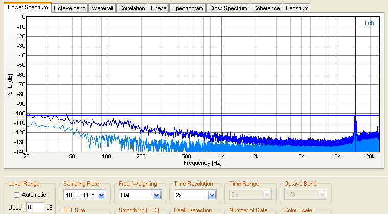

We then modified the mounting to vertical mounting like so that the MLCC is standing like a tombstone on one pad and is then wire-connected to the other pad. The resulting improvement is shown here:
As already written above, the mechanical influence can be reduced when mounting the MLCC with their long body side to the short side of the board. It is a good practice to keep this in mind when using MLCC. As a side-effect/benefit, flex-cracking-risc is much lower when doing so. (For the latter, flex/soft-termination-caps might help as well.)
