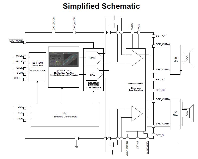

Why are you taking out the DAC-output? What is it for?
I, not sure what your question is. I'll make an attempt to answer. Let me know if it provides the expected answer or please clarify the question.
The TAS3251 is a DSP+DAC +TPA3251 on the same silicium. The wires from the DAC go out of the chip on some pin, and have to be connected to the amp part of the chip via some other pins: its is an external connection. So you see the DAC outputs connected to the amp inputs.
