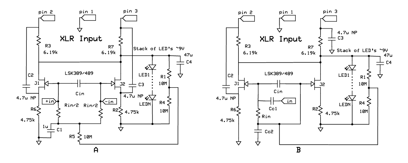

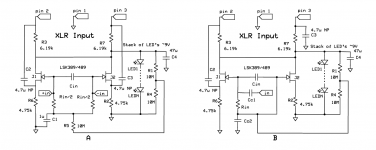

Hans here's a couple of ideas for a simple buffer for MM/MI into a phantom powered mic input. Differential and single ended. You may want to increase that 47u cap and of course you can use zeners or IC shunt regulators.

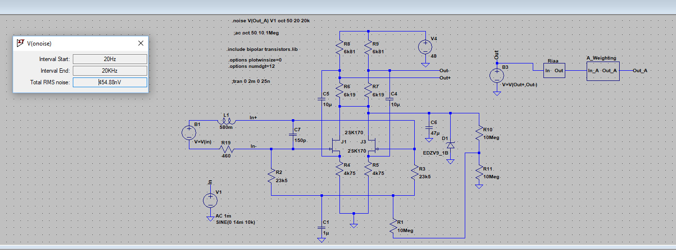

I've put the Balanced version in LTspice. Noise from 20Hz to 20Khz is 455nV after Riaa and A-Weighting, corresponding to 3.2nV/rtHz.
So when you put the output in a Mic input of some 2i2 device with a high enough input impedance, you have your gear complete.
Hans
That looks good, perfect (for MM/MI) in front of many of the field recorders too. I have one more version that might be of interest but it will take a couple of days to draw up. As drawn I think you could give each FET more current if you need to drive a little more load, but I think the levels are so low it does not matter.
The single ended version above is less interesting and you don't need the second FET. It was originally meant to be a jumper programmed SE/Diff circuit.
I have also built versions using the floating battery idea (9V) for completeness. It would be nice to put all the versions together in a library so everyone can choose what works best for them.
Scott, two parts that I suggest to be changed:
C1 of 1uF serves no function, but reduces CMRR.
This one could be replaced by a 47pF cap for HF suppression
C2 and C3 cause the output impedance to be very high at LF, 1k5@20Hz going to 65 Ohm@10Khz.
When changing into 47uF, this impedance drops to 165 Ohm@20Hz.
Hans.

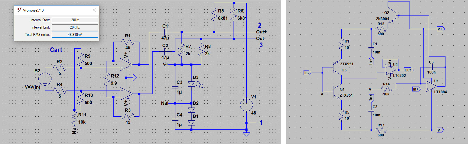

Here's a HeadAmp with Phantom Power, in this case displayed with a gain of 20dB. The OpAmp in the left image is shown in detail on the right. Equivalent A-weighted input noise of this HeadAmp is 50nv including the 10 Ohm Cart. With a Gain of 20dB this translates into 500nV at the output. The 2i2 produces 316nV eq a-weighted input noise, so both add up to 590nV or 59nV RTI, resulting in 78.5 dBA S/N. Gain can be changed without any problem from 20dB to 26dB in case of using a Cart with a lower output.
Power supply comes from 2 Diodes and one LED, giving resp 1,2 Volt and 4 Volt. Current through the ZTX851/ZTX951 is adjusted to 1 mA with R12/R13.
Hans

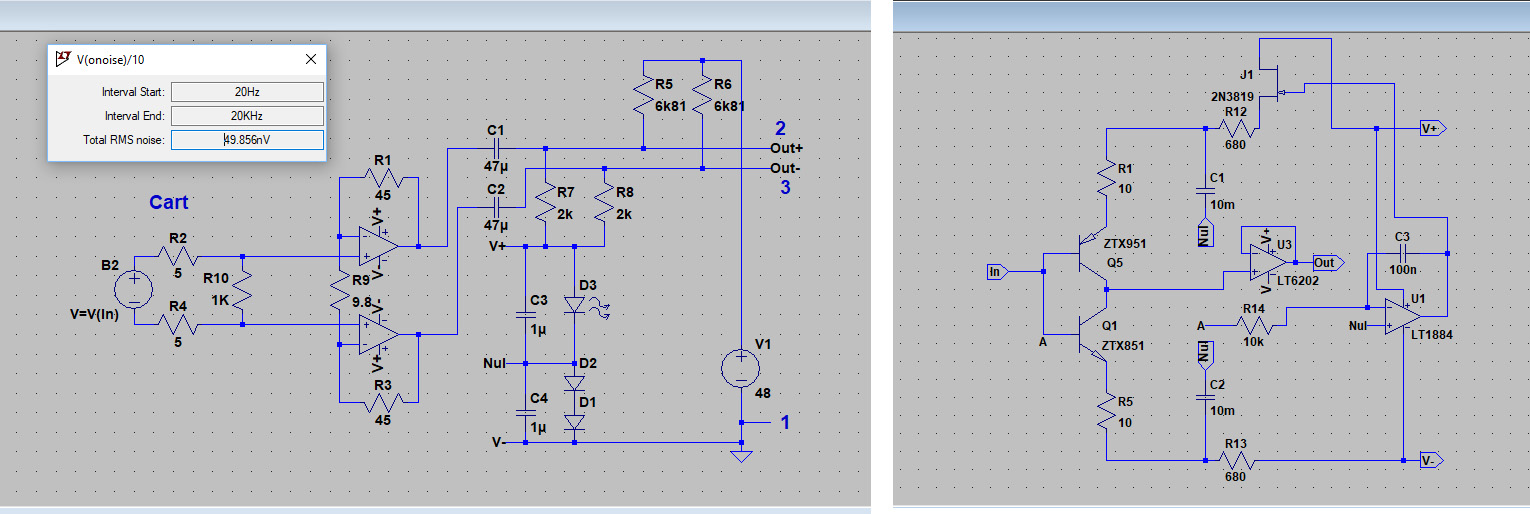

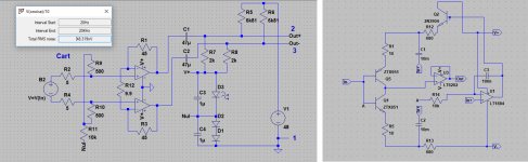

I presented a circuit in my last posting #36 that works in LTSpice, but will most likely not function in real life.
For the time being, it will work perfectly as a current input amp, but I will have to make some changes to make it also work as a voltage input amp.
Hans
And here is the correct voltage input version. There was nothing really wrong, just a matter of confusingly using the label 'Nul' on different positions, which I have changed immediately. And since for a certain current an NPN has a better defined Vbe than a Fet for Vgs, I have replaced the 2N3818 for a 2N3904, but both are possible as long as the steering output of the LT1884 stays at least 0.5 Volt within its power supply voltages. Last but not least, I had forgotten to connect the Cart to Nul.
Hans
