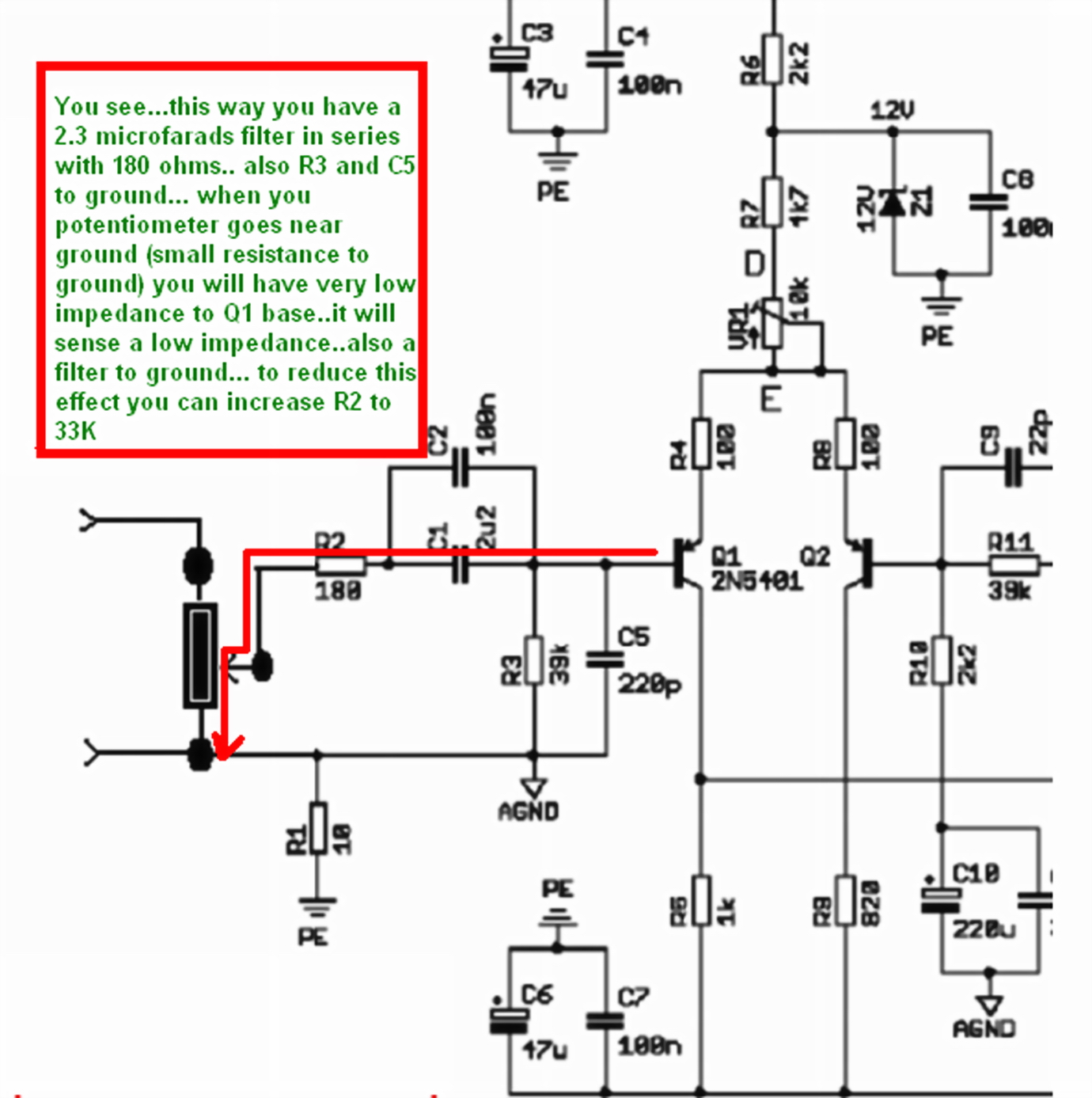

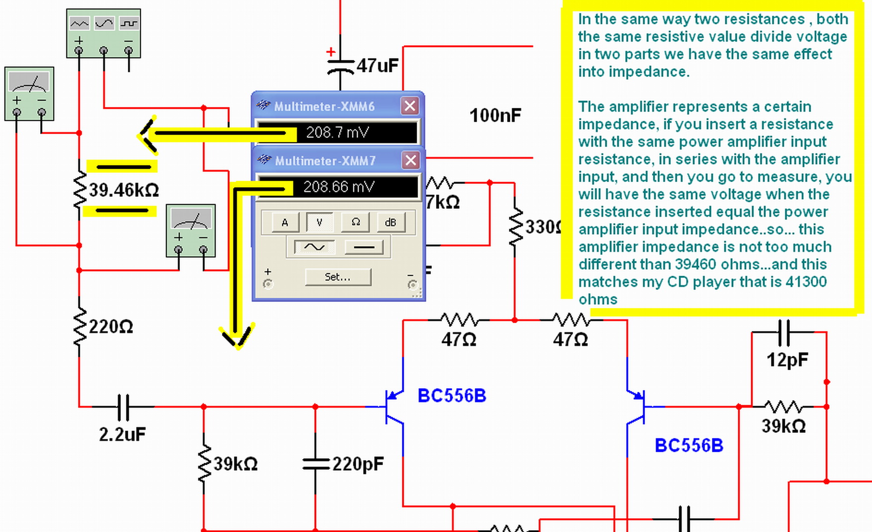

Rudi..... observe these 2 images attached.
The power amplifier input impedance is around 39K...so.... the good potentiometer to be connected is 39K or higher than that....not to load the input.
Images talk by themselves.
be happy.
Carlos

The LTP at the front end of the amplifier will work better when fed from a low source impedance.
Increasing the source impedance will make most LTP circuit create more distortion in their output signal.
A low source impedance is always beneficial.
Some designers may optimise the LTP to work better from a higher source impedance, but this is (I believe) relatively rare. The Crimson I built up came with a comment that it was optimised to operate witha 5k source impedance and since 1k0 was already fitted on the PCB, Crimson recommended that an extra 4k be inserted in the signal feed.
A Zin = 39k is inviting a pot <=10k. or better still, insert a buffer after the pot.
Oh!..... thank you...i am perceiving something that makes sense
I will reduce the impedance Andrew.
thank you...i was thinking about that just now!
I am trying to match the input resistance to ground...but better is to reduce.
What about to include a resistance in parallel with the pot, connected to the pot extremes resistance...let's say 22K?

I don't like the idea od adding parallel resistor to the pot.
It lowers Zin for little to zero benefit.
