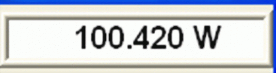

OMW, these things are stinking up my room... just tested the first one and get a nice 35.7VDC after the PSU on both rails
Good Macd...will be an excelent idea... we gonna be very happy to know your findings
Klaas is rigth...will be much more safe.
Having images... please.... post them to us Macd.
I will be waiting your feedback Macd....having images, please, send me and i can post them.
regards,
Carlos
Nordic
Some factories use those stinking material on transformers.
Maybe one entire day under the sun will help your transformer not to smell so bad.
Now you gonna reach 100 watts Nordic.
R10 resistance...change them to 1K8 because of the gain.
