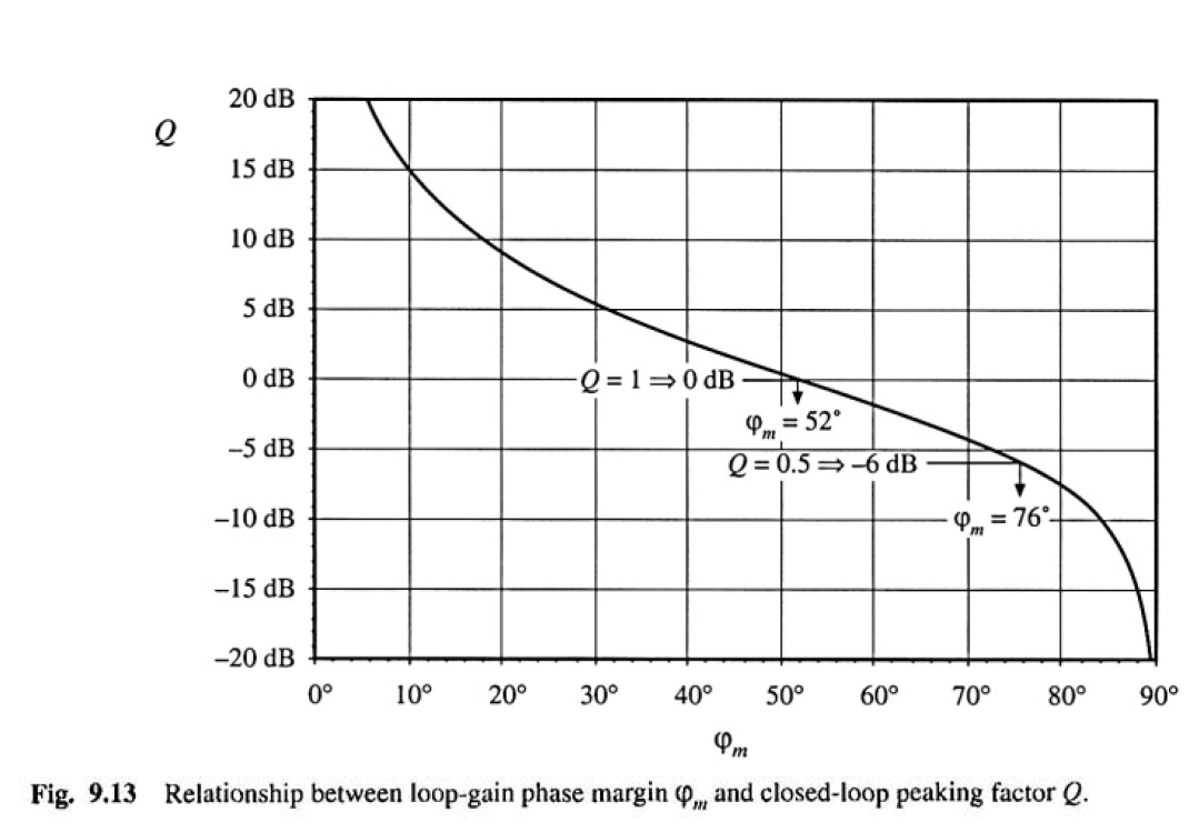

...From all the discussions I've read about this stuff, this seems like a pretty darn good amount, of both...
What discussions were those?
Both are borderline.
Do a Tian plot as the amp is close to clip, this is often the worst-case that sets the limits.
Maybe it won't be for your amp, I would be curious to see the plot.
All over spread out across the forums. Lots discussed about margins, mixed up with other stuff.
Under what criteria? This is where I find most confusion. The various opinions mention lots of different values, no actual consensus.
And that's why I ask the question again, but I guess that will vary depending on who answers.
What is the correct amount? What criteria is used to arrive at those values?
That's confusing to me, as doing a sim with a Tian probe is an AC analysis, not a transient, and I don't see how referring to clipping in an AC analysis context can work.
How would you do that? There is no signal at the amp's input in an AC analysis, and that's been mentioned lately, that it should be "zeroed out".
And the Tian probe sim is stepped with values of 1 and -1, so how to relate any of this with a clipping condition?
..a sim with a Tian probe is an AC analysis, not a transient, and I don't see..
It is an AC analysis, I wrote "close to clip".
It's easy for a DC coupled amp, just have a DC offset at the amp input that drives the output close to the rails.
