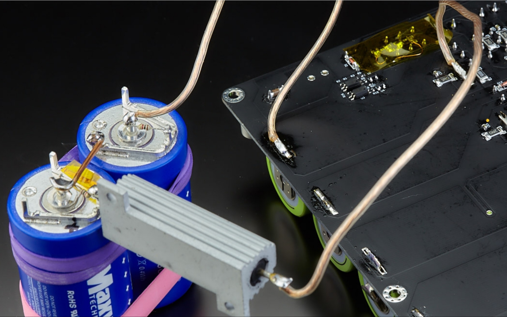

Ultra capacitor/LifePO4 hybrid power supply could be so far the best 3.3V rail in the world. I found a very easy solution to upgrade my LifePO4 power supply board in this way.
3.3V LifePO4 battery power is already very good for low noise clock and DAC applications. However, ultra capacitor /LifePO4 hybrid power supply has even lower internal ESR. So with the upgrade, both response performance and low noise performance can be improved even more. There could be no any other power supply solution can be better than this.
I’ve tried using this upgraded hybrid 3.3V rails for the FifoPi clean side and VCCA of ESS DACs with good result. The improvement of sound quality can be heard clearly during the listening test. I’m very happy with it.
If you had my LifePO4 power supply, I would ask you doing this upgrade today not tomorrow. It will give you a big surprise.
To do so, you will need only 3 or 2 steps,
STEP1:
Prepare a pair of ultra capacitors. You can use either BCAP0350 E270 T13 or BCAP0325 P270 S17.
The second one has lower ESR almost as half as the first one. Connect a 470ohm passive balance resistor in parallel with each cell and then connect the two capacitors together in series.
Also prepare two pieces of wires, AWG18 or bigger.
If you don’t have other way to pre-charge your ultra capacitor package, you will also need a power resistor around 3 ohms.
UltraCapacitorLifePO4HybridPowersupply1
by Ian, on Flickr
STEP2:
Solder a wire between the negative of the battery cell of the LifePO4 power supply to the negative of the ultra capacitor package, and a wire from the positive of LifePO4 battery cell to the positive of the ultra capacitor through the power resistor (Or, you can solder them directly to the taps if you use battery holders). Leave them for a couple of hours until the capacitor package is pre-charged to higher than 3.0 volt.
BT6 is corresponding to 3.3V rail on J1
BT7 is corresponding to 3.3V rail on J2
If you can pre-charge the ultra capacitor package to around 3.3V in other way, you can escape this step.
CAUTION: Make sure no any short circuit happens during assembling and soldering. It will be very dangerous because huge energy stored in battery cells even without a DC power connected.
UltraCapacitorLifePO4HybridPowersupply2
by Ian, on Flickr
STEP3:
Remove the power resistor. Make sure both positive and negative terminals of the ultra capacitor package are connected very well to the battery cell.
Now you are having the upgraded hybrid power supply. It’s really not difficult. You no longer need to disconnect or to pre-charge the ultra capacitor package any more as long as you have battery cells installed. You are done!
Re-connect the upgraded hybrid power supply back to your system as before, enjoy the music!

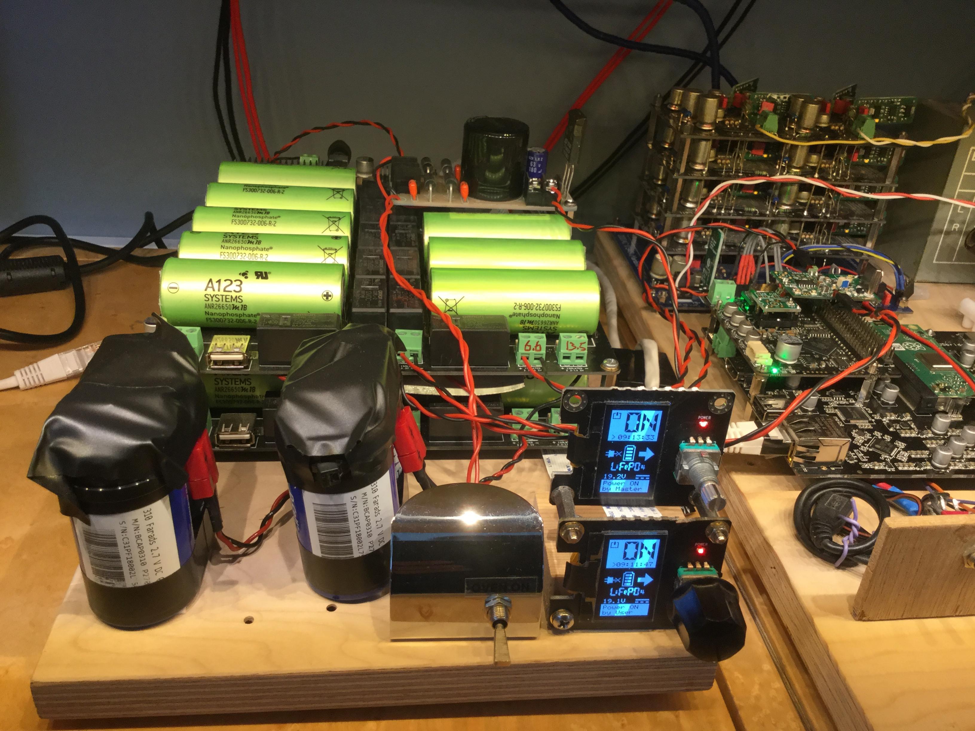

I followed the idea of Greg for the ultracaps in this post: https://www.diyaudio.com/forums/pow...-explore-plus-build-thread-4.html#post5936139
As a diy drone builder I had some connectors lying around.
The ultracaps are used on the ps for the fifopi and andrea mori clock (3.3v supply).
It’s now running in. I am very curious of the results.
The caps are connected in parallel to the batteries. I would like to use them as a r-c filter on the battery supply but this is not easy to do. I expect using a filter point with the resistor will result in even less noise from the battery.
It could be done by just connecting them on the output of the battery supply but in that way the capacitors will drain when power is off (it is behind the relais) and will need filling at power up, and as filling them with a 3,9ohm resistor takes about one hour this is not usable.
Has anyone found a solution for this by modifying the battery output line to the relais and inserting the r-c filter in this way?
