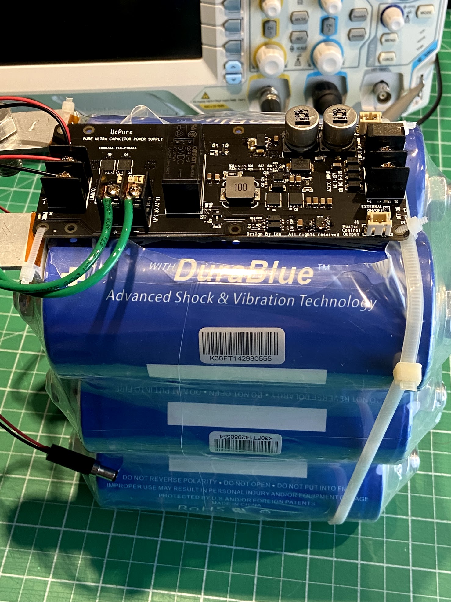

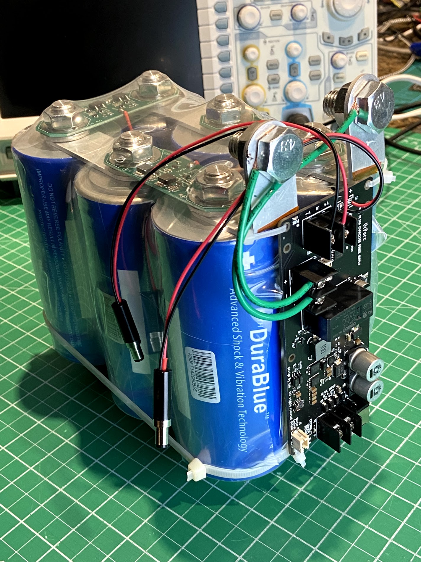

UcPure in 15V 6*3000F configuration
Now it turns even more crazy.
This is a UcPure in 15V configuration with 6*3000F ultracapacitors.
When powered on, only the fully charged ultracapacitor pack will be applied to the load. It will be a pure UC power supply and 100% isolated from any rest of the circuit.
No doubt this is the best 15V power supply in the real world. And it will be the best power supply for Andrea’s TWTMC clocks.
Why?
Actually ultra capacitor has two different working modes.
UcPure works in the first mode which I call it the class A mode. In this mode, only ultracapacitors apply to the load. No other active power supply is involved. The current goes only one direction out of the ultracapacitors into the load. Class A mode will ensure the best low ESR and low noise performance.
Another mode I call it the class B mode. In this mode, ultracapacitors work as class B shunt elements in parallel with another power supply or charger. The current goes both directions into and out of the ultracapacitor. Though the performance of this mode is still better than other active power supplies, but the dynamic ESR will still be higher than the class A mode because the ultracapacitor current crosses zero frequently. And even more, the noise of the power supply that attached can still be introduced into the voltage rail to make noise performance worse than the class A mode.
The sound quality difference between class A and class B can be heard clearly if we use them as power supplies for clock circuits such as the FifoPi clean side or the TWTMC oscillators.
UcPure is a heavy duty design for a durable operation. It can use both AC and DC as input. The quality of the input doesn't matter because the input will be disabled when UcPure is turned on.
Ian

Great Jan!
Will the output voltage be regulated by jumpers? In addition to 3.3 v and 15v, will there be any other options?
How does switching between modes A and B work?
And please tell what these additional psb, they are only needed when there are more than 2 supercapacitors?
I'm waiting for UcPure to be available.

@ AirAir
@Clsidxxl
Same UcPure can be set to 3.3V, 15V, 5V or something in between just by jumpers.
UcPure works only at class A mode to achieve the best possible performance. That's the reason I designed this UcPure. Based on the real test, to power TWTMC DITXO, it can run up to 4 hours before voltage drops below 13V from 15V. That would be pretty enough. When voltage below that threshold , UcPure enters a protection mode which will be automatically degraded to class B for only a couple of minutes to recharge the ultra capacitors. After that time, UcPure will be back to pure class A mode again for another 4 hours. Protection mode doesn't stop playing music.
Ultra capacitors will be charged automatically to the setting voltage when UcPure is turned off. Many design considerations were integrated into UcPure internal control logic, so everything will be operated automatically at background no need for the users to worry about.
UcPure also has a continuous output option, this option is very good to power clock circuits 24/7 to make it keep break-in for low phase noise performance. In this option, output will be continuous without stopping even if the UcPure is turned off or being charged in the background.

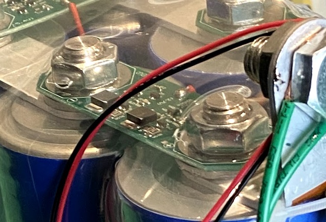

The small PCBs are the 3000F balancing boards that come with the 16V ultra capacitor package. Normally we don't need to buy them. They are not expensive and can be found online from many websites such as
Super Capacitor Protection 2.7v 3000f Balancing Circuit Board - Buy Balancing Board For Capacitor,Balancing Circuit Board,Balancing Board Product on Alibaba.com
Ian
Ian
Thank you Ian!
My capacitors did not have such boards. 🙂
I don't understand, somewhere for 2 capacitors used 1 such a protection board, somewhere 2 boards.
@AirAir
One balancing board is for two ultra capacitor cells.
So ,you will need one balancing/protection board for a pair of ultra capacitors,
and three of them for six ultra capacitors.
More can be found:
2S MAXWELL 650F 1200F 1500F 2000F 3000F 3400F Ultracapacitor Balancing Borad | eBay
Super Capacitor Voltage Regulator Protection Board 2.7V 3000F Stabilizer Module | eBay
Ian
More can be found:
Ian
