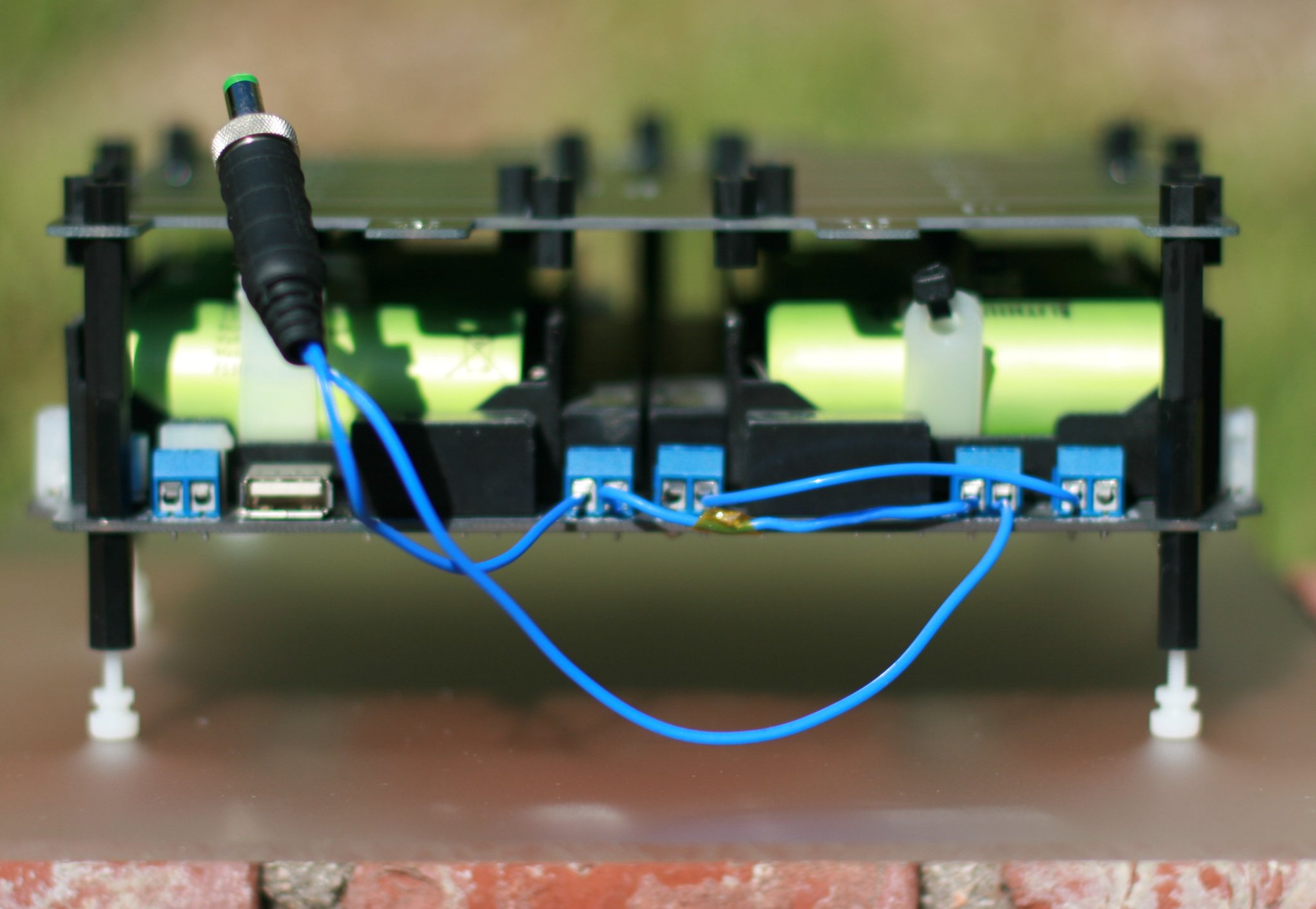

For one of my applications I have three LiFePO4 boards stacked with a single 22V output and a lot of energy storage . They are so flexible...you can plenty of things with them not listed in the manual.

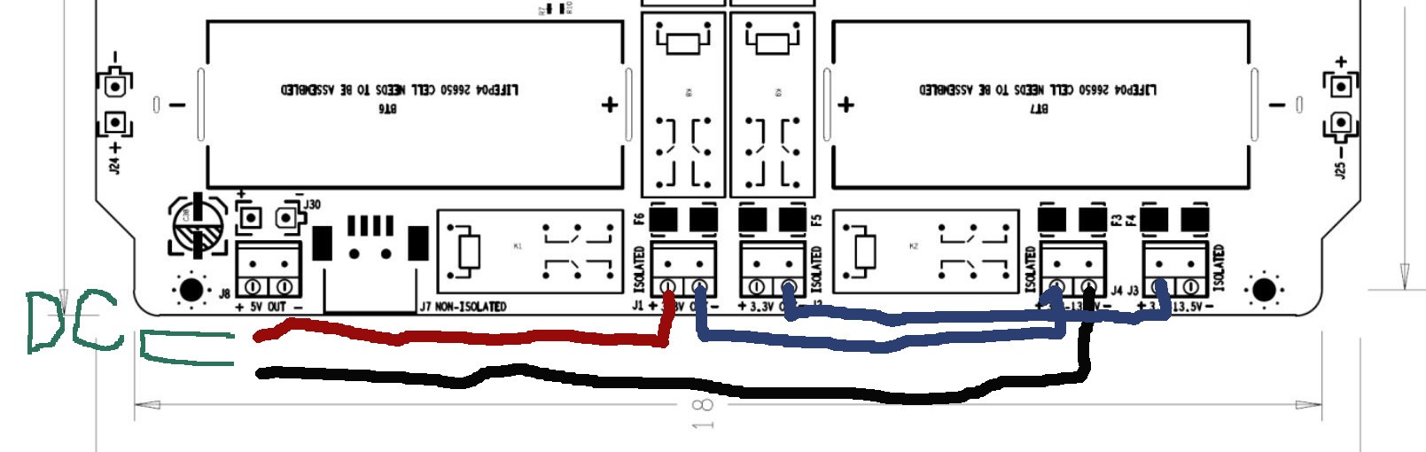

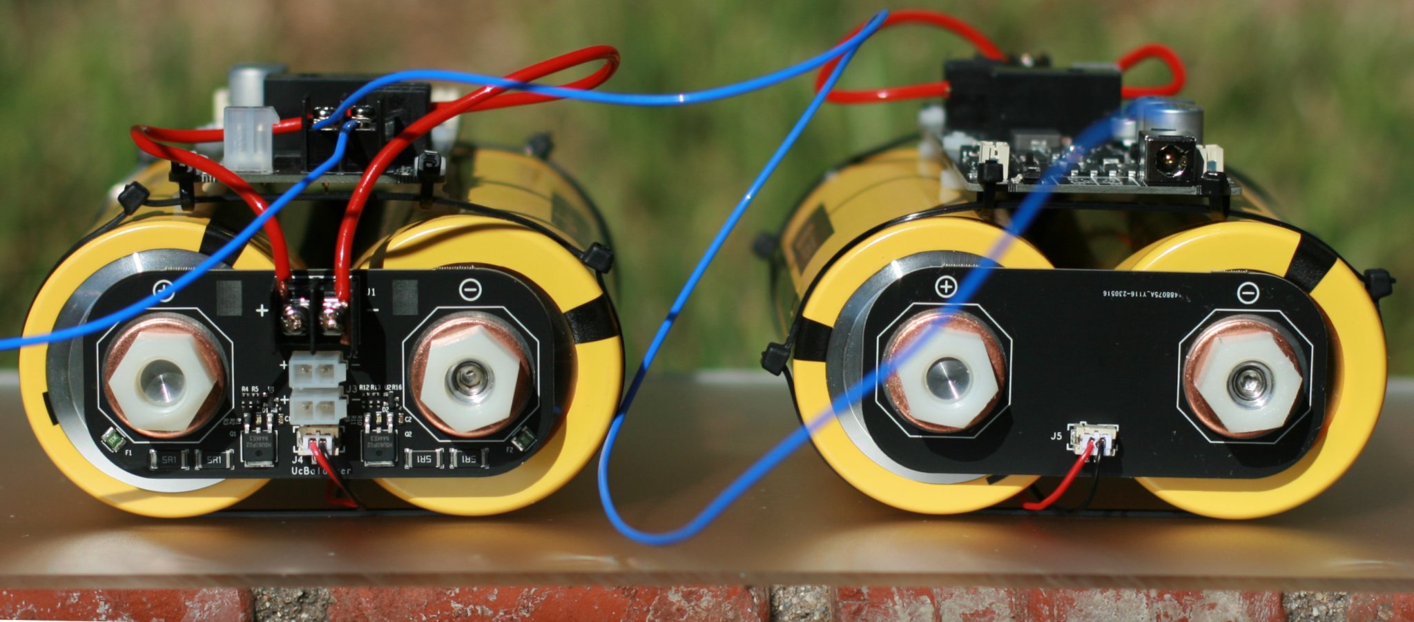

So I try to be extremely careful and do due diligence. Here's my config for 5 batteries @ 16.5V for 1 out of 2 sides:
I'm assuming this is what you are doing? It's a great option for more hours usage like if you are powering a power-efficient PC. Wow, 22V. I can't even grasp around how that could be done. Fortunately, the most I will ever need is 16.5V.
I'm able to easily get 8 hours on timer shutdown with Andrea's clock and one side. Curious how long I can get with parallel.
So this is how Ian help me combine the 13.2V rail and the 3.3V rail to get to 16.5V per side:
J1+ && J4- output === My DC 2.5mm plug
I'm guessing J1- && J4+ === combining 13.2V && 3.3V (in series) rails on one side
I'm guessing J2- && J3+ === combining 13.2V && 3.3V (in series) rails on the other side
I never tried the output of J2+ && J3-, but I'm assuming it should output 16.5V if I wanted another DC 2.5 plug, etc.
For jumper wires, I think I use "None" to get to 13.2V.

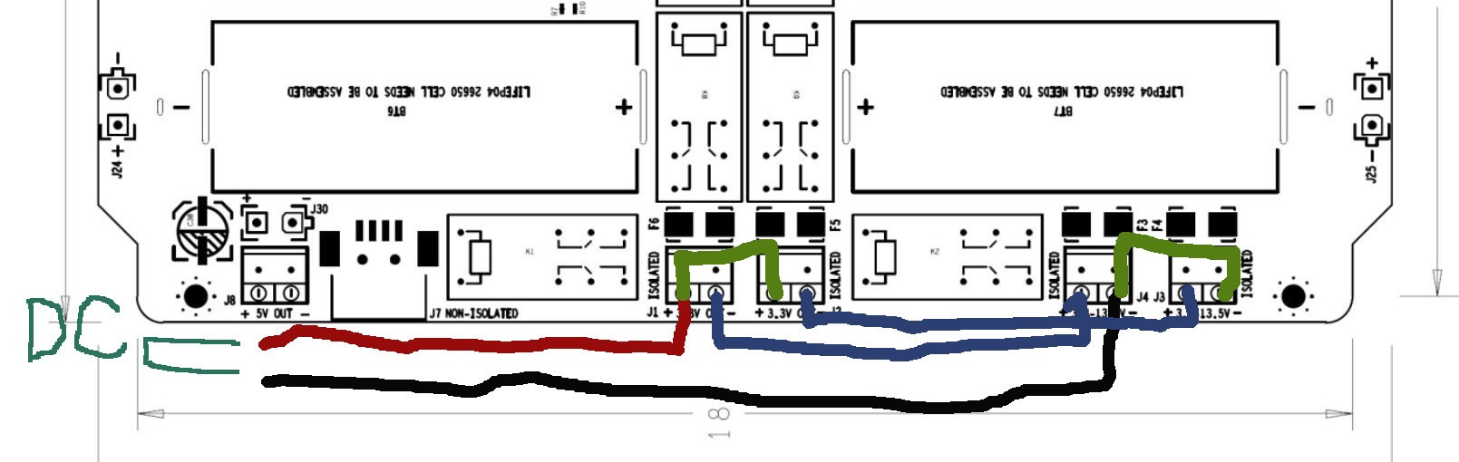

So J1+ && J2+ gets me parallel along with J4- && J3-?
Again, no hurry. Also, I'll try to run it by Ian for his approval before implementing.

2. All battery cells are internally connected together in parallel on the PCB. You must never reverse the positive and
negative terminals when assemble/solder them into PCB. Reversing battery terminals could be very dangerous.
Mine is a Ian-approved and Ian-helped-configured 16.5V rail. So both rails are configured for 16.5V. Just, I guess, need to parallel both rails.Two 3.3V-13.2V battery direct isolated voltage rails for analog section and other sensitive circuits. Each of
the rails can be configured as 3.3V, 6.6V, 9.9V or 13.2V separately.
Multiple LifePO4 power supplies can be bridged together to get more voltage rails.

J1: 3.3V pure battery output voltage rail in 2-pin 5.0mm terminal
J2: 3.3V pure battery output voltage rail in 2-pin 5.0mm terminal
J4: 13.2V/9.9V/6.6V/3.3V pure battery output voltage rail in 2-pin 5.0mm terminal
J3: 13.2V/9.9V/6.6V/3.3V pure battery output voltage rail in 2-pin 5.0mm terminal
Just connect both positive wires to the positive side of your connector and both negative wires to the other. You now have 16.5V with double the energy storage.

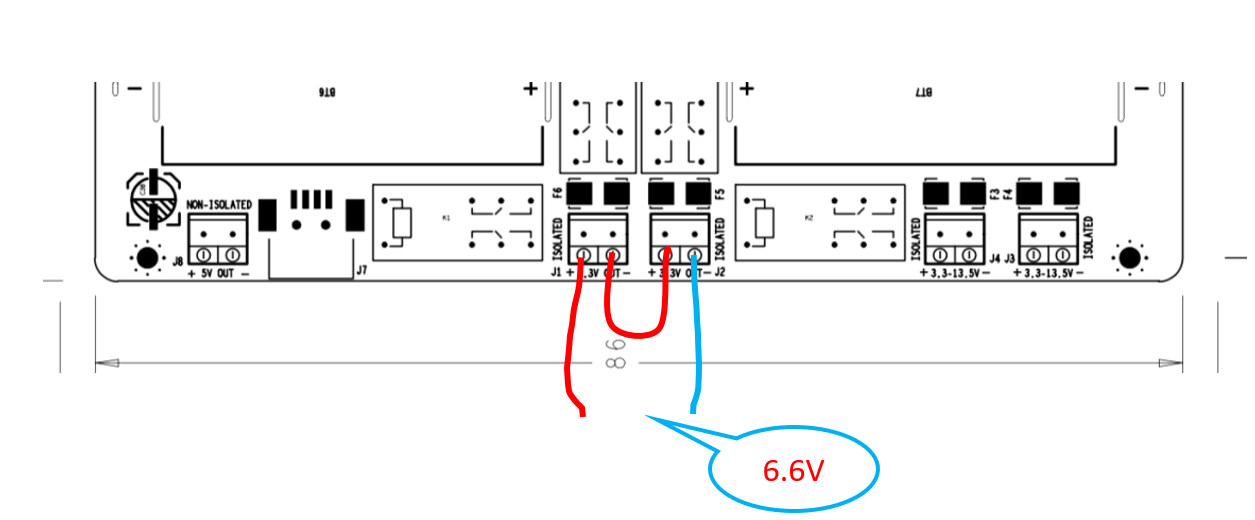

Hi@dvb projekt
You can not use the two 3.3V rails for the 6.6V output. So, you can parallel the rest two 6.6V rails together. In this case, 4 cells will be needed.
Ian
An old Post, so not sure, if still correct with mk3.
I have put the two single 3.3 in series to get the 6.6V and it seems to work… any problem I don‘t see?

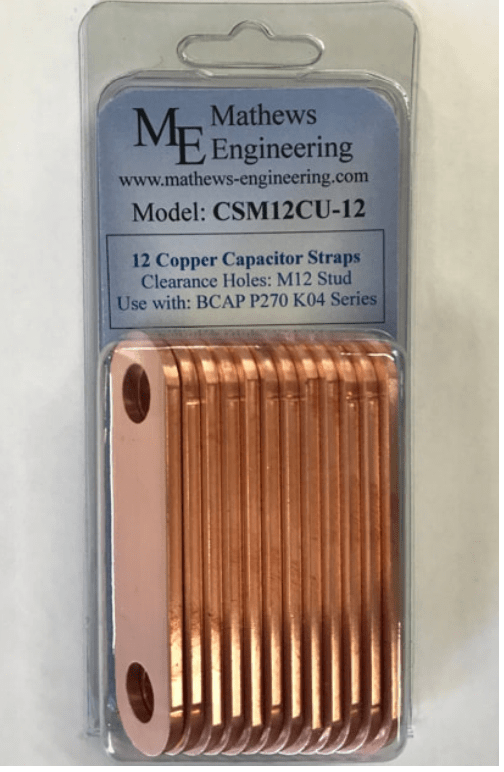

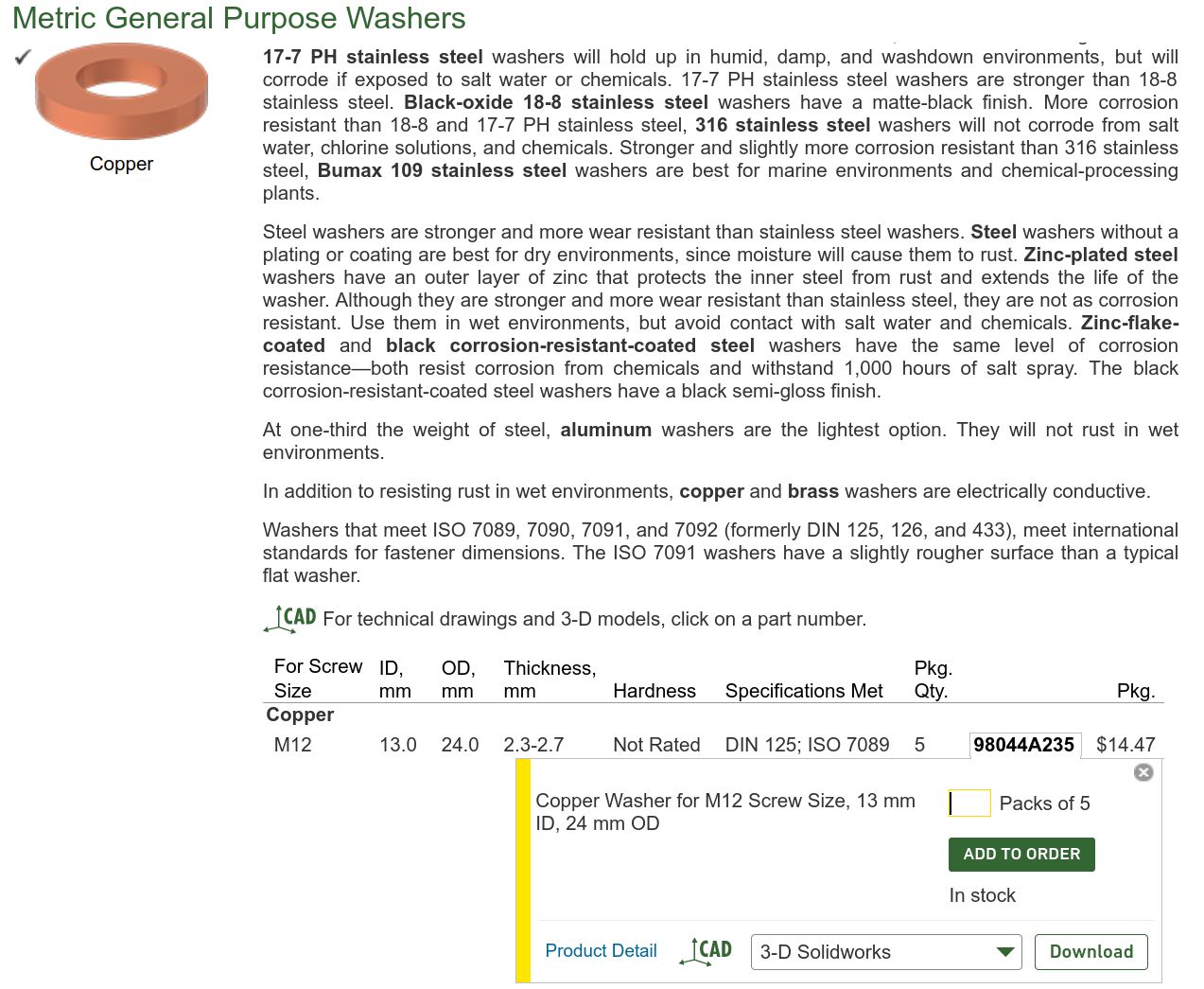

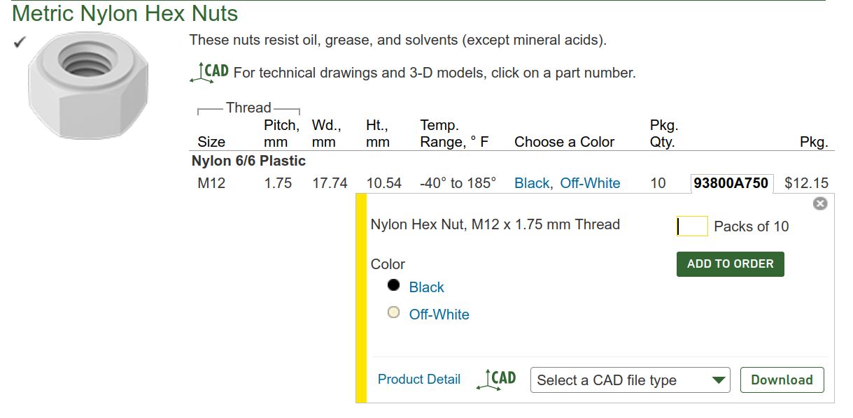

Yes, M12.
https://www.mcmaster.com/products/s...nt~metric/for-screw-size~m12/material~copper/
I believe it's been confirmed the pitch thread is 1.75mm for the Hex Nuts along with M12.

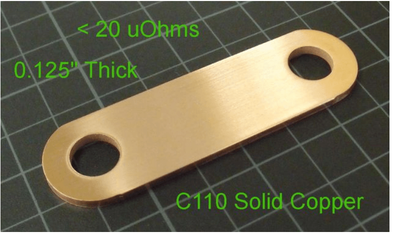

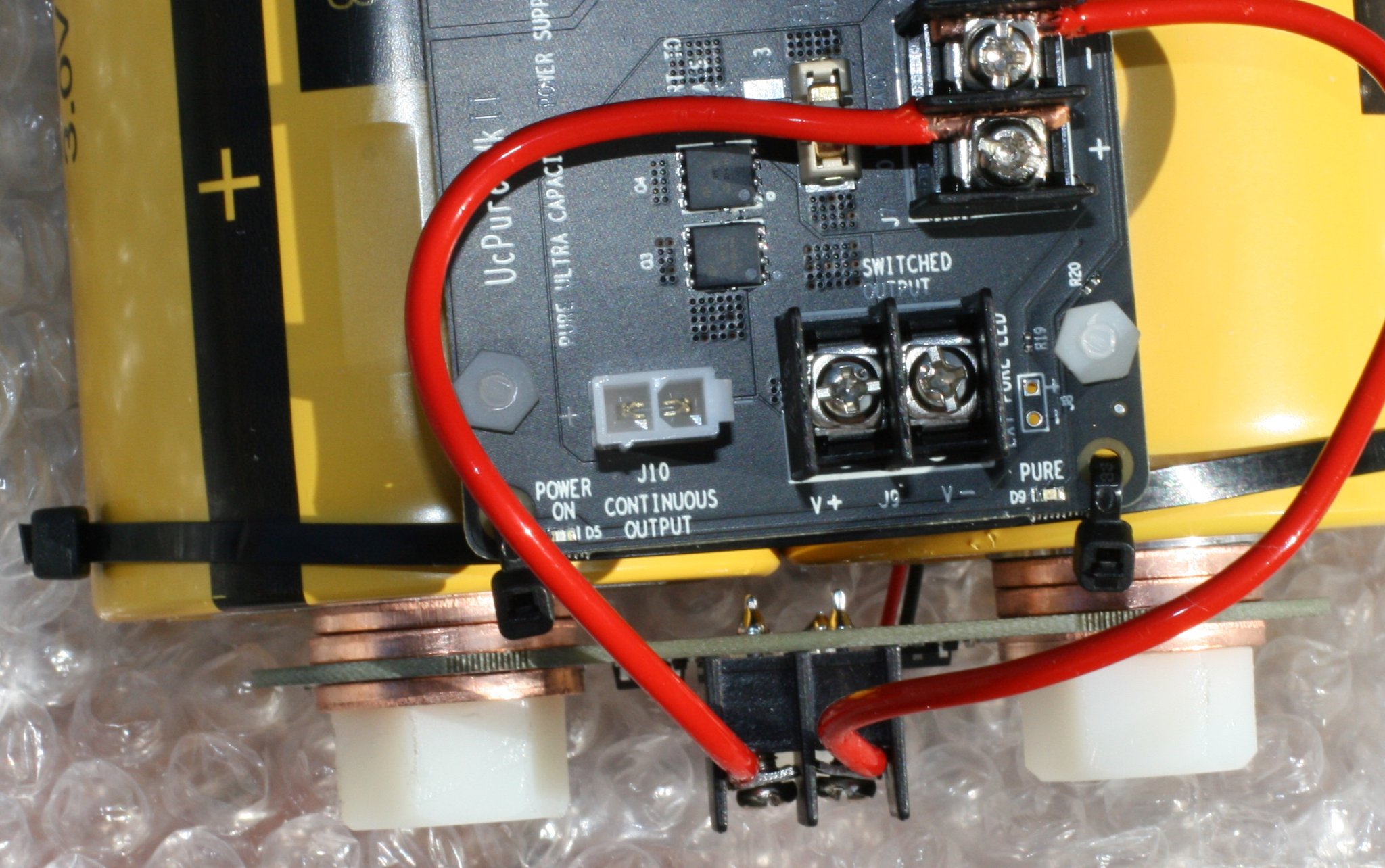

I recommend to consider on doubling up washers on the UcBalancer PCB side as the +- on the back of the Main Terminals of the UcBalancer touches the Eaton if only single washer used. Although, I believe it only touches the plastic coating on the Eatons. Also, I think you can cut off the excess on the back of the UcBalancer Terminals, but since I like to play it safe and I had extra Cooper Washers that's what I'm rolling with this time around.

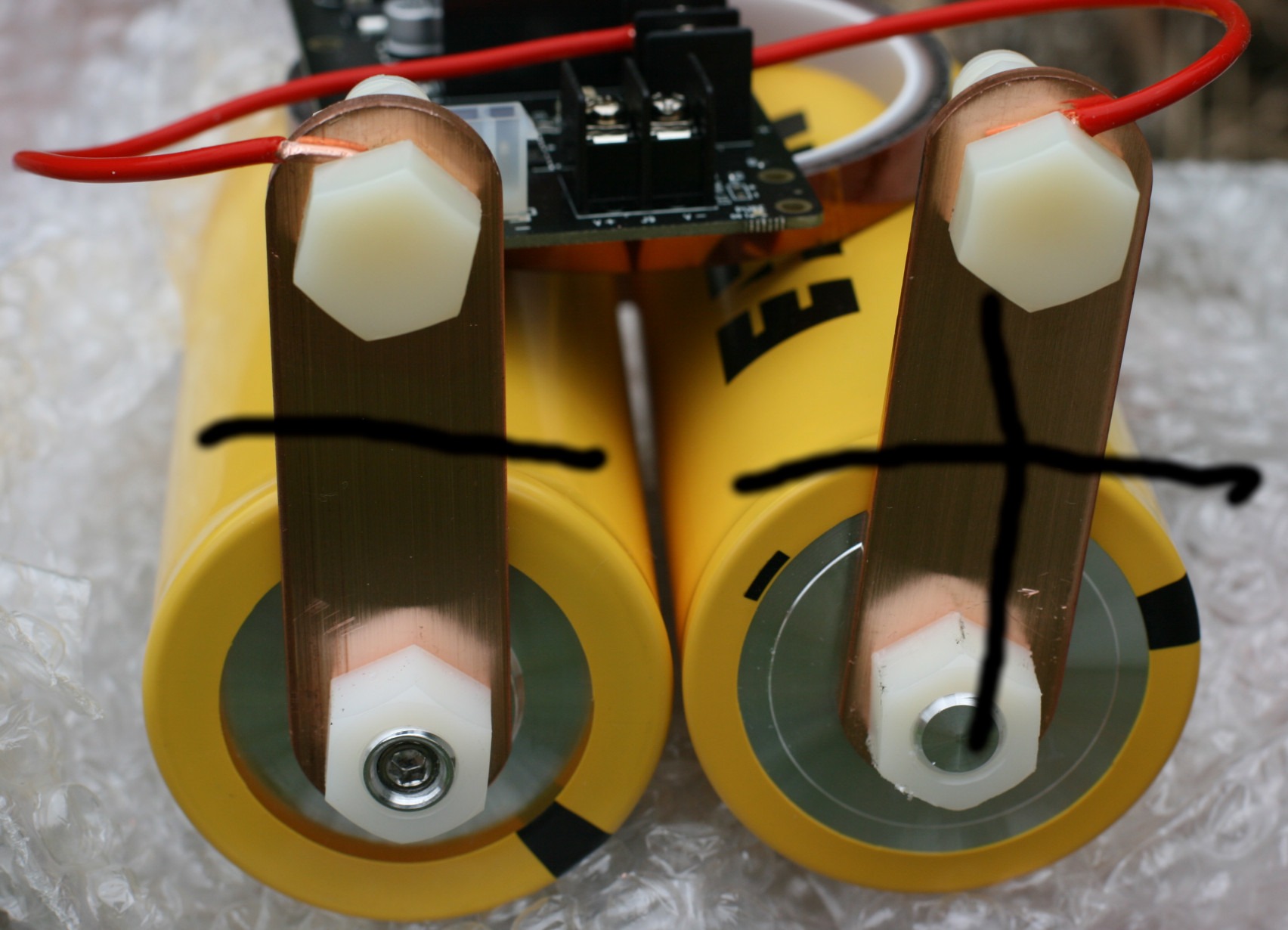

When I build my 15.5V in 2025, I'm going to try to order Custom Cooper Washers that are thicker from Machinists:
https://www.mathews-engineering.com/store/p13/Copper_Straps_for_Maxwell_Ultra_Capacitors.html
On this site, it displays two size options: M8 and M12. So I'm assuming these two size are pretty standard for Ultra Capacitors.
M12 all the way for Eatons.
![M12.jpg M12.jpg](https://www.diyaudio.com/community/data/attachments/1117/1117620-c537d784640e898ee084a1b3ab685cb7.jpg)
![UcDouble.jpg UcDouble.jpg](https://www.diyaudio.com/community/data/attachments/1117/1117622-61606209948b1ed666c74de35c0f902d.jpg)
![buss.jpg buss.jpg](https://www.diyaudio.com/community/data/attachments/1117/1117625-83385c44be4301bdf7d9c1aea839461b.jpg)

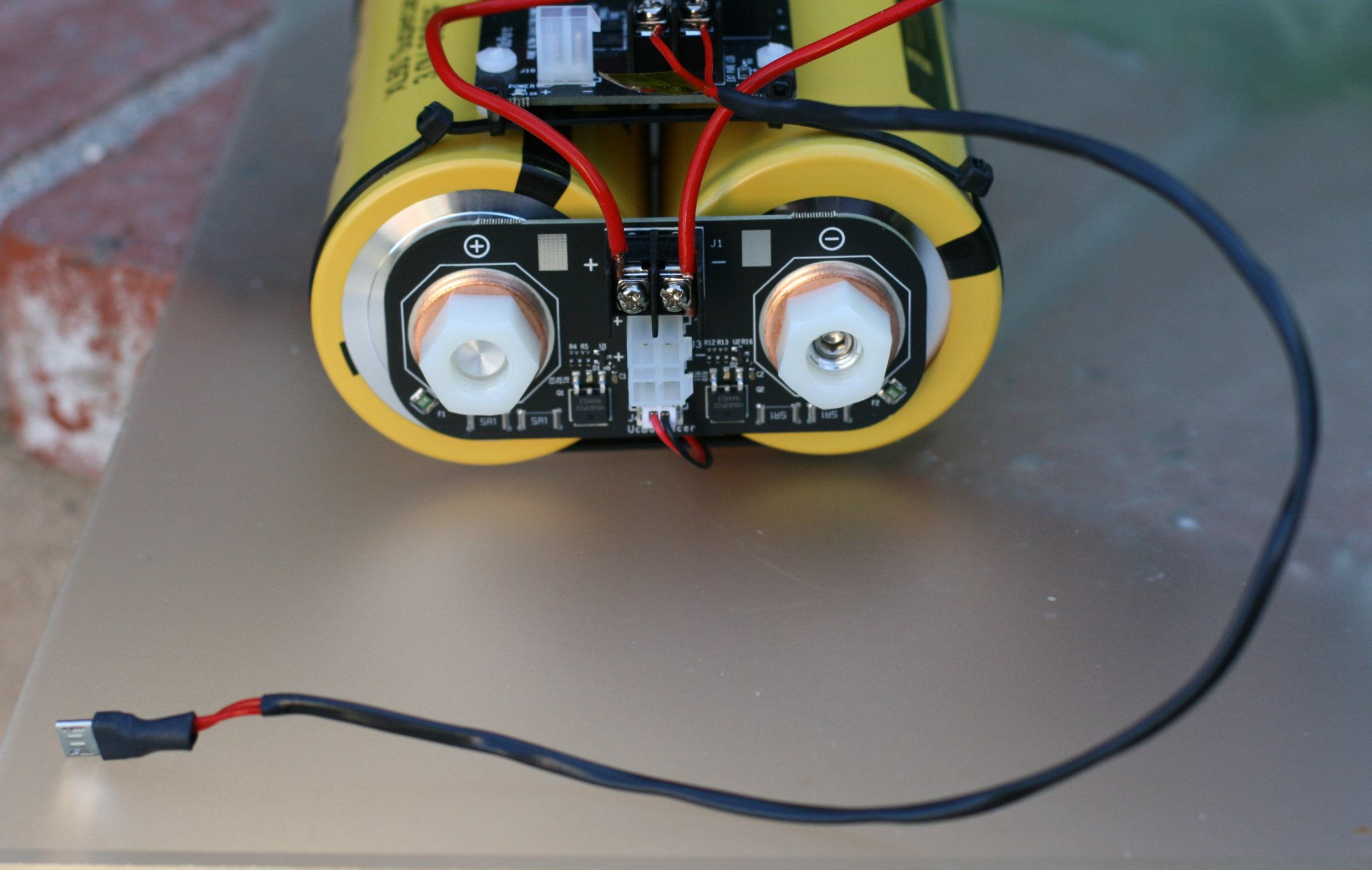

You will use the UcBalancer in place.When I build my 15.5V in 2025
I already have a UCPure MKI for my 15.5V for 2025, but I will need to procure 3 more UcBalancers in 2025.
This Summer, I built UcPure MKI / UcBalancer 3.3V and UcPure MKII / UcBalancer 5V.
