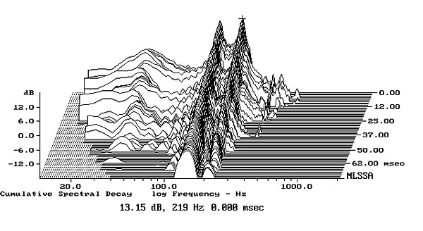

I did note, while digging up the impedane curve, that from this measurement the construction of their box is not very good. 100 Hz box rersonan e will be heard.
![1212DO96fig2.jpg](https://www.stereophile.com/images/1212DO96fig2.jpg)

nothing special there.
Same old 30 ohm peak at crossover
that guys cant seem to improve
even with computer aided design.
Most the magic if any is ok drivers.
Never seen off axis measurements.
Crossing low to a 10" driver
you would need a tweeter that can cross
very low and have low distortion at low frequency.
Aka larger than 1" and have low resonant frequency.
At least 700 Hz or lower to tolerate 1500 kHz
crossover point. More ideal for a 8" speaker
10" actually needs lower crossover.
8" about the threshold for a 2 way without using
larger waveguides / horns.
Or just do a 3 way with more bass woofer.
since a mid is more feasible for 10" or larger
woofers.

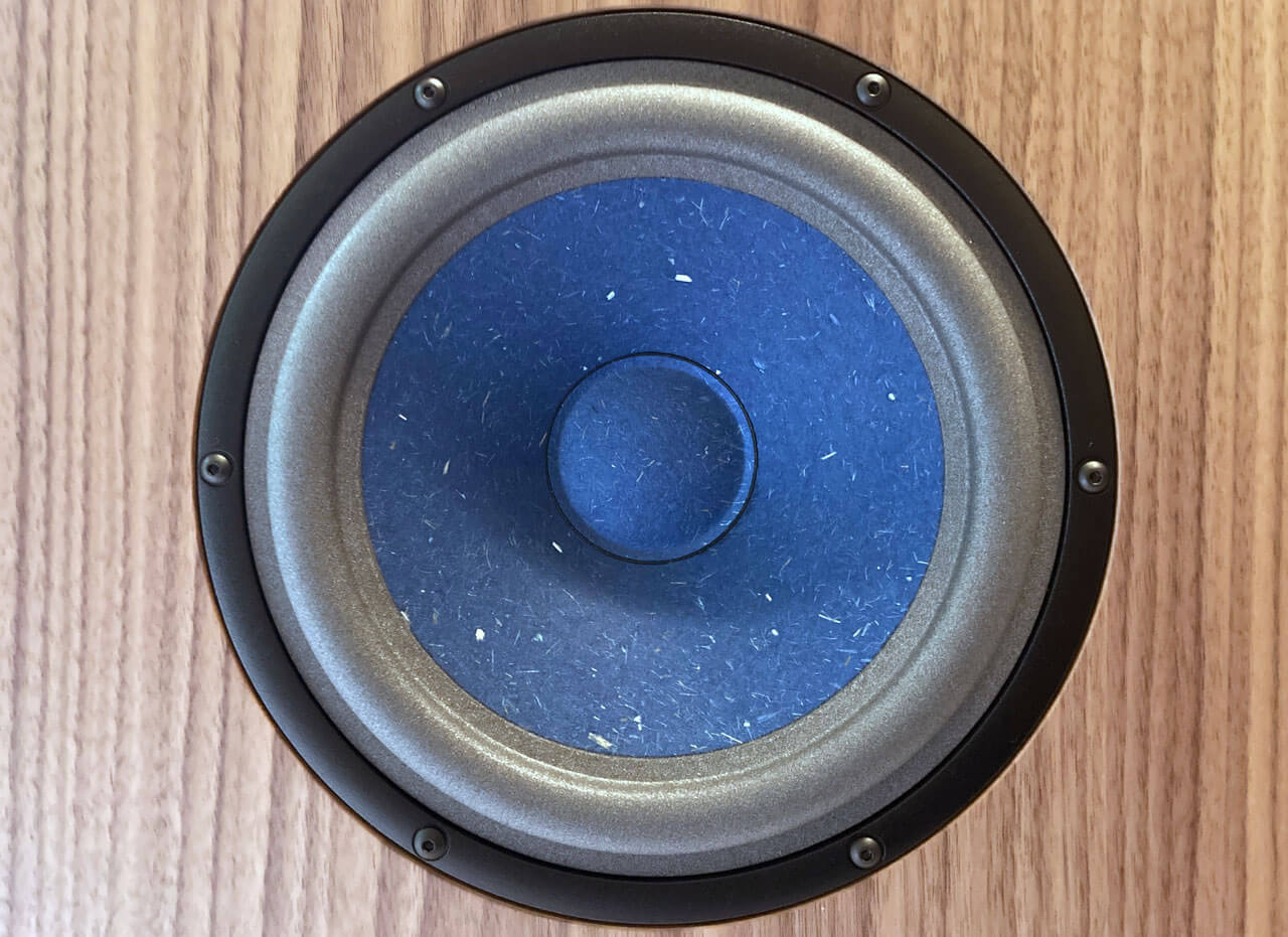

Please don't tell me these use also blue dyed seas chassisYeah, like uber expensive Audio Note AN/E.![]()
Just like the old cheap Vifa M21 woofers they used to use.And they use foam as speaker surround...
