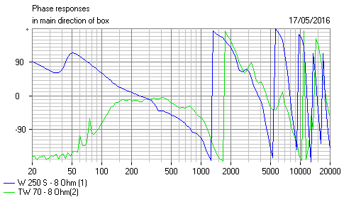

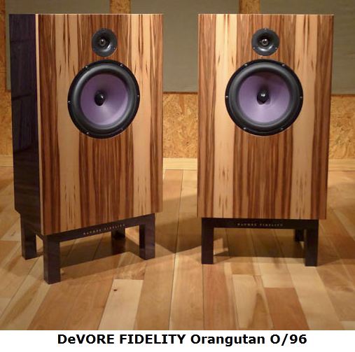

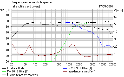

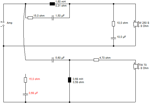

Oh, and as the icing on the cake, I've pretty much matched John Devore's impedance, so I think I'm on the right track:
http://www.stereophile.com/content/devore-fidelity-orangutan-o96-loudspeaker-measurements#
Those were lower efficiency Visaton drivers. The W250S and TW 70 tweeter.
But that is mere detail. The low crossover and notch are the main event.
I've owned speakers like this. All two ways being compromised, this one has poor dispersion at high frequencies, but solid bass and middle
Big 8"-12" cones get away with simple filters, having tidy mechanical roll off.

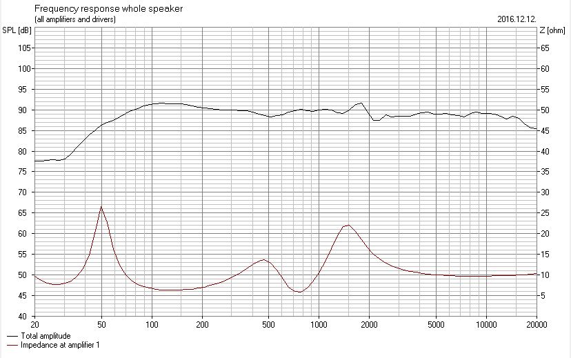

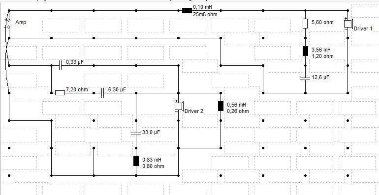

May I a little bit closer. Simulation based on A26 and Morel measurement on the same box.
