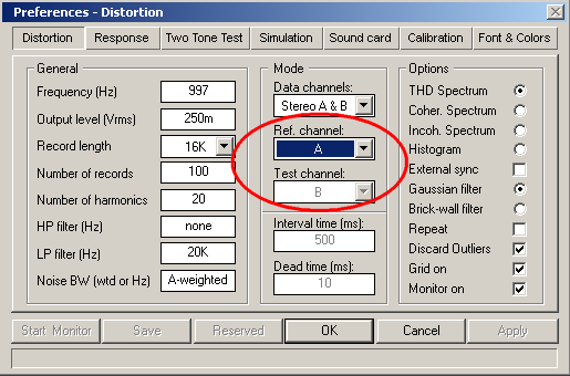

I am the proud owner of an AP SYS272. I would like to look in more detail into the waveform of the residual of the signal. The AP can give me that residual (supressed fundamental), how can I feed this into DiAna? I guess I have to use a sound card to get the signal into the PC.
Will DiAna complain if there is no fundamental, or can I insert a fundamental in the other channel of the soundcard and use that in some way?

If you have a signal that is just a residual that you want to process, DiAna can't sync to a harmonic. It needs a bit of the fundamental mixed in, or you need to use the external sync mode. The sync channel can be the fundamental plus harmonics (or the pure input tone), the other can be just the residual. The sync channel does not need to be precise or free of harmonics, it just needs to have the same instantaneous frequency of the signal being analyzed, without the same level of noise. I requested this feature from Edmond because I had residuals I wanted to analyze and the alternate sync made it much easier to use.

Hi Keane,
Thank you for this explanation. Indeed, DiAna needs a fundamental to synchronize on, that is, it should be present on at least one channel, hereafter called the reference channel. With the setup shown below, the other (test) channel uses frequency and phase information from the reference channel.
Now you can feed the test channel with a suppressed (notched) fundamental.
Diana has also provisions for characterizing a notch filter and notch compensation in order to restore the original fundamental and its harmonics (amplitude as well as phase). See Options on the menu bar. More on this later.
Cheers, E,
