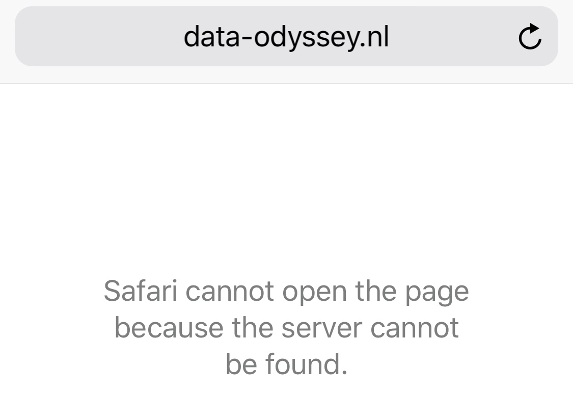

Server cannot be found.

Curious, I just opened it Index of /diana/ and downloaded the file. Perhaps your ISP is blocking it for some reason? You could try its IP: 72.29.88.138 and see what happens.
Here is a trace from my PC:
1 2 ms 1 ms 1 ms 192.168.29.1
2 10 ms 10 ms 9 ms 96.120.91.233
3 9 ms 8 ms 10 ms 96.110.177.221
4 10 ms 11 ms 28 ms be-215-rar01.santaclara.ca.sfba.comcast.net [162.151.78.193]
5 12 ms 12 ms 11 ms be-299-ar01.santaclara.ca.sfba.comcast.net [68.86.143.93]
6 12 ms 11 ms 19 ms lag-14.ear3.SanJose1.Level3.net [4.68.72.105]
7 77 ms 79 ms 81 ms ae-1-8.bar1.Orlando1.Level3.net [4.69.137.149]
8 77 ms 86 ms 77 ms HOSTDIME.bar1.Orlando1.Level3.net [4.31.179.146]
9 77 ms 78 ms 77 ms ae2.core1.mco.hostdime.com [67.23.229.201]
10 79 ms 77 ms 77 ms server.budgetwebsiteserver.nl [72.29.88.138]

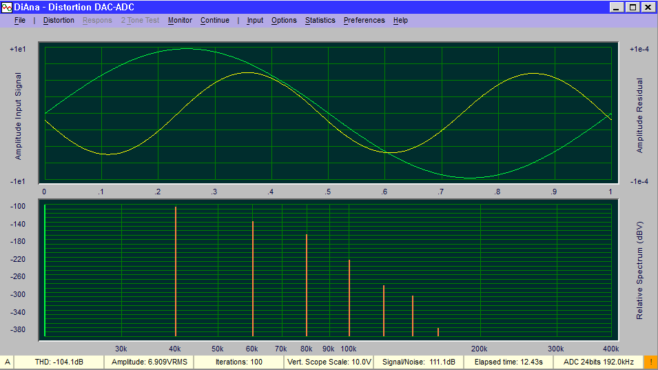

I was doing some testing of my hardware and tried using DiAna on a 20 KHz tone measures at 192 KHz. The results are interesting and not far from the analog measurements except how are the harmonics above 80 KHz arrived at? The ADC has a brick wall by definition at 96 KHz. Are they inferred from the measured sample values (pretty trick)?
Hi Demian,
Whether the harmonics above the Nyquist frequency are meaningfull or not depends on the properties of the ADC. In case of audio (delta sigma) ADC's, these harmonics are the result of noise and should be ignored. Only in case of a SAR ADC + a suitable sample & hold circuit and no anti-alias filter(i.e. an ADC designed for under sampling) these harmonics are meaningful. Please, also have a look at this post and the following replies.
Cheers, E.

I'm afraid some misunderstanding is going on. Admittedly, I have used the term "under sampling", but only to explain why it is possible -in principle- to reconstruct signals above the Nyquist frequency. But that doesn't mean DiAna works in the same way as the under-sampled AD conversion in an IF stage, for example.
Instead, the incoming samples are first mapped (reshuffled/re-sampled) into an interval equal to a single cycle of the fundamental frequency (i.e. between 0 and 2pi). As a result, the signal has been (greatly) bandwidth limited to only the fundamental and its harmonic. After this step, the FHT is taken on this single cycle. Please, have a look at these two pictures. The first one is an ordinary FFT spectrum that indeed clearly shows the alias. The second one is obtained by re-sampling the data first, i.e. the DiAna way. As you can see, the alias is gone and the "above Nyquist harmonic" shows up where it should be.
Cheers, E.

[..] But what if the input signal really contains the 2kHz spurious? [..]
The THD spectrum of DiAna is an FHT of the residual*. So it starts at the fundamental, in this example 19kHz. Therefore anything below this frequency stays out of view. Remember, DiAna is a harmonic distortion analyzer and not some ordinary spectrum (or spurious) analyzer.
Cheers, E.
*ignoring for the moment the "raw spectrum" option, which is a totally different story.

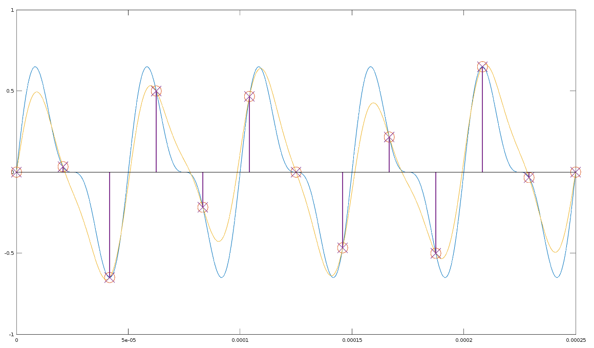

The process involves two stages running in parallel:
Stage 1 - Data acquisition, resulting in a stream of samples
Stage 2 - Processing of the acquired stream.
The scope undersampling mentioned by Demian requires controlled data acquisition (trigering at exact part of the waveform, random sampling times to increase the effective sample rate). However, none of that is possible with a typical ADC. The exact sampling start cannot be specified and sampling times are all equal. Only several fixed sampling rates (multiples) are available. The Stage 2 receives a steady flow of equally timed samples.
Now these stages are independent - Stage 2 cannot influence the timing and values of data it receives from the data acquisition stage.
Let's assume an ADC with no low-pass filter, doing just regular sampling of the continuous (analog) signal (e.g. SAR ADC). The sample rate is 48kHz.
Case A)
The sampled analog signal is 20kHz fundamental at -6dBFs + H2 (40kHz) at -12dBFs, all zero-phase based.
Case B)

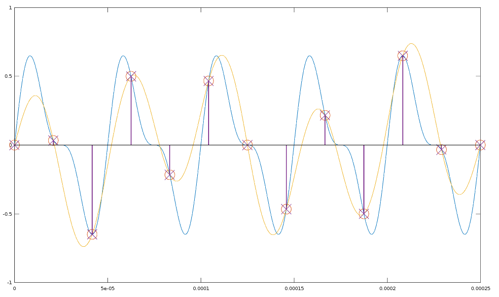

The sampled analog signal is 20kHz fundamental at -6dBFs + spurious 8kHz at -12dBFs with inverted phase at start.
These two very different analog signals, when sampled by the ADC without any filter, will yield exactly same stream of samples:
blue line - signal A, yellow line - signal B, circles - sampled signal A, crosses - sampled signal B
Now how can the processing stage 2 distinguish between the two signals when in both cases it receives identical data to process? IMO it will claim H2 at -12dB for both cases, even though for case B) the 20kHz signal has zero harmonic distortions.
Or another case B) - combination of -18dBFs H2 and -18dBFs spurious 8kHz, yielding again identical samples as case A)
All because all the upper frequencies are "folded" to <0, fs/2> and only knowledge of which fs/2 interval was being band-passed to the ADC stage allows to specify which frequency of the many (infinite for infinite bandwidth) mirrors is the correct original one. But there is no analog band-passing prior to the ADC being mentioned as requirement for diana, if I understand correctly.
There are some great figures at https://www.eetimes.com/how-to-use-undersampling/#
That is my opinion. Where am I making a mistake?

Hi Pavel,
You are right. In this (special!) case DiAna isn't able to differentiate between a real harmonic and a spurious. The good news is, however, that it won't happen that much. It only happens when the frequency of the spurious exactly coincidences with a folded (aliased) harmonic. When I increase (or decrease) the spurious frequency by 1%, the "claimed" H2 is more than 100dB* lower. So in case of any doubt one could change the fundamental frequency a little bit and compare the results. If still the same, then DiAne isn't fooled by a spurious.
Cheers, E.
